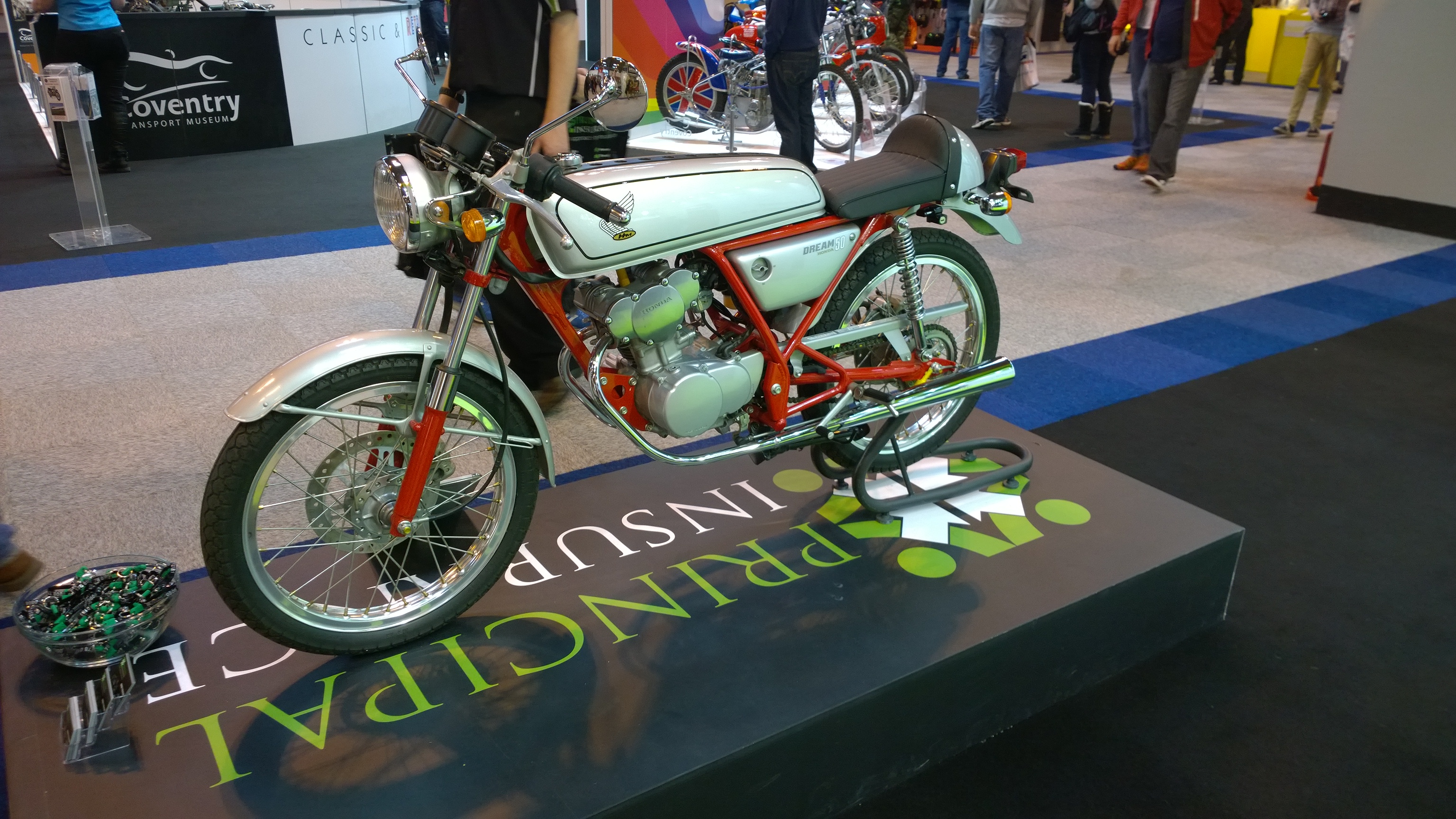

Saw an original Dream 50 while at Motorcycle Live in November and one thing large difference that struck me between this and our Aces was the length of the rear fender, or more to the point the large patch of silver that extends under the seat. One our bikes we have a large black plastic mudguard here.
Would ideally like to have a rear hugger eventually but for now I thought I would see what sort of difference painting this mudguard makes. Quite pleased with the result, paint match looks better in the photos than real life but it's not too noticeable due to the location. Might have a go with the chain guard now too
