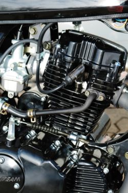

Also found a close up of engine now this is me being a "noob" but I know something is different but I don't know what
Or is there a modification that removes the pipe work to the right of the spark plug
I should also point out part of the reason for me in getting one is so I can work on it myself and learn a bit more about how it all works
So thanks for any help
Gecko
Gecko
Hi mate, year that pipe from the motor is part of the anti pollution valve . there is a plate from ooracing (or you can make your own out of 3-4mm thick flat bar) to block off the outlet, then you need to block off the hose connected to the top of the engine inlet manifold (it goes to the valve that the pipe goes too, bolted to the frame )
i used a bolt in the hose, others have used JB weld or a small grub screw etc in the top of the inlet manifold. and made the plate up myself .
heres the ooracing part
https://www.ooracing.com/store/egr-cylinder-head-exhaust-emission-blanking-plate.html
