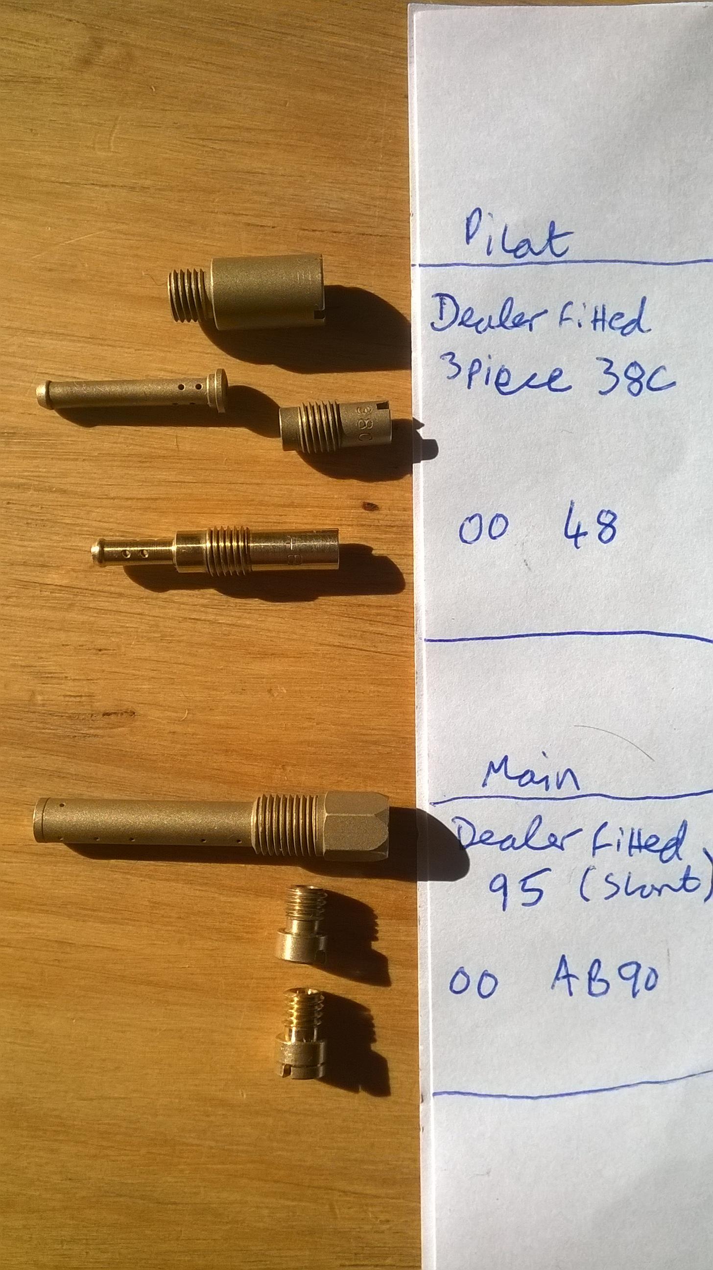

Hey guys, I need a hand to figure out what the local dealer's outsourced mechanic, who no longer works for them, may have changed in my carb.
I am happy that I have the correct jets from OO Racing for my current set up, or closer enough anyway (48 pilot and 90 main). I can go up and down from there to fine tune.
In the picture below, you will see that the pilot jet set up that the dealer fitted is a 3 piece affair and that the screw part of it is marked 38C. The OO jet (48) does not screw in to this holder. From reading about other Ace rejets, it seems to me that there should be just a holder and the jet. I assume that the mechanic has replaced the whole set up with a different style of pilot. Am I right? And if so, has anyone got a link to where I could purchase the correct holder so I can use the OO jet!?
This makes me suspicious of the part that the needle rides up and down in too. Perhaps the mechanic put a different part in. It has two rows of 5 holes unevenly placed plus a couple of extra individual holes at the top. Bike is hesitant in midrange where it would be running off the needle and that unevennes in the holes makes me doubly suspicious. Does this look like it should?
And finally I also notice that the head of the 90 (AB) OO jet is longer than the head of the one (marked 95) the mechanic fitted. Is that an issue?
Your thoughts, or photos of correct parts, if this has been messed up, would be much appreciated. Or let me know if I am going mad and looking at this all wrong. I won't be offended.
3 part pilot is original sky team. one part oo pilot replaces this assembly
90 main is correct . all is good for standard bike 125 original pipe. as you open up exhaust and air cleaner you will need to go richer on the main.emgo shorty will need a 95 - 100 main with no air box. major porting will require 102.5
guestimates only
Ahh, excellent, I will just screw that OO pilot directly in to carb body, no sleeve required!
So remaining question is what is the standard length of the head of the main jet screw. i.e. Which is correct 4mm (from OO) or 3mm (which is currently fitted)? And what difference would this make?
When I hold the oo and currently fitted main jets side by side, with the ends of the screws (not the heads) lined up, I can see that the hole that sits closest to needle will sit at exactly the same height. However the hole in the middle of the screw head, that will be in the bowl, is 1mm deeper in to the bowl on the OO jet.
Cheers
Richard
the jet orifice hight is what is matters if anything. the jet is well under the surface of fuel in bowl. along as the depth of jet does not block it against bottom of bowl it should be ok. you are correct if you screw the pilot into body of carb.
my last jet set in old carb was 48 pilot /95 main. the last one i set up on another bike which had an emgo shorty muffler , oo racing down pipe and a different air cleaner element was 48/100. this was a tad rich but running in so was happy with it
i am now running a vm26 flange 232 carby with butterfly choke. this setup is for emgo shorty.38mm header free flowing air cleaner element port and polish ports . 150 large valve head. 25 pilot needle slot 3 main 102.5 . this is good up top midrange good ,needs choke to start .
plug colour is darker coffee. only set up this afternoon. leaned off from 105 main as plug was black to deep deep brown.
hope this helps. may still play with pilot but bottom and needle are the same as on dyno. tryed moving needle and was still best spot.
pete

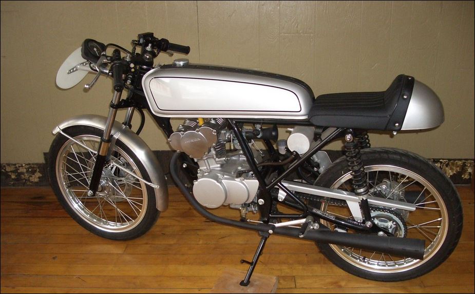

I'm from Belgium and i am following this topic for a while and i thought i show you mine.
i have made a lot of changes already on the ace so far and maybe more to come ;D
The carb still needs a filter :D
If you have any questions or tips, just ask!
Love the fairing. Bloody brilliant. All aces should have one!
I agree, the fairings do do a lot for the Ace but they are not the easiest thing to find.
That one of yours looks factory fitted, super job. Did you buy it new, or had it been on something else before?
The stays look well made, but looking at your exhaust your not short of tooling and skill.
