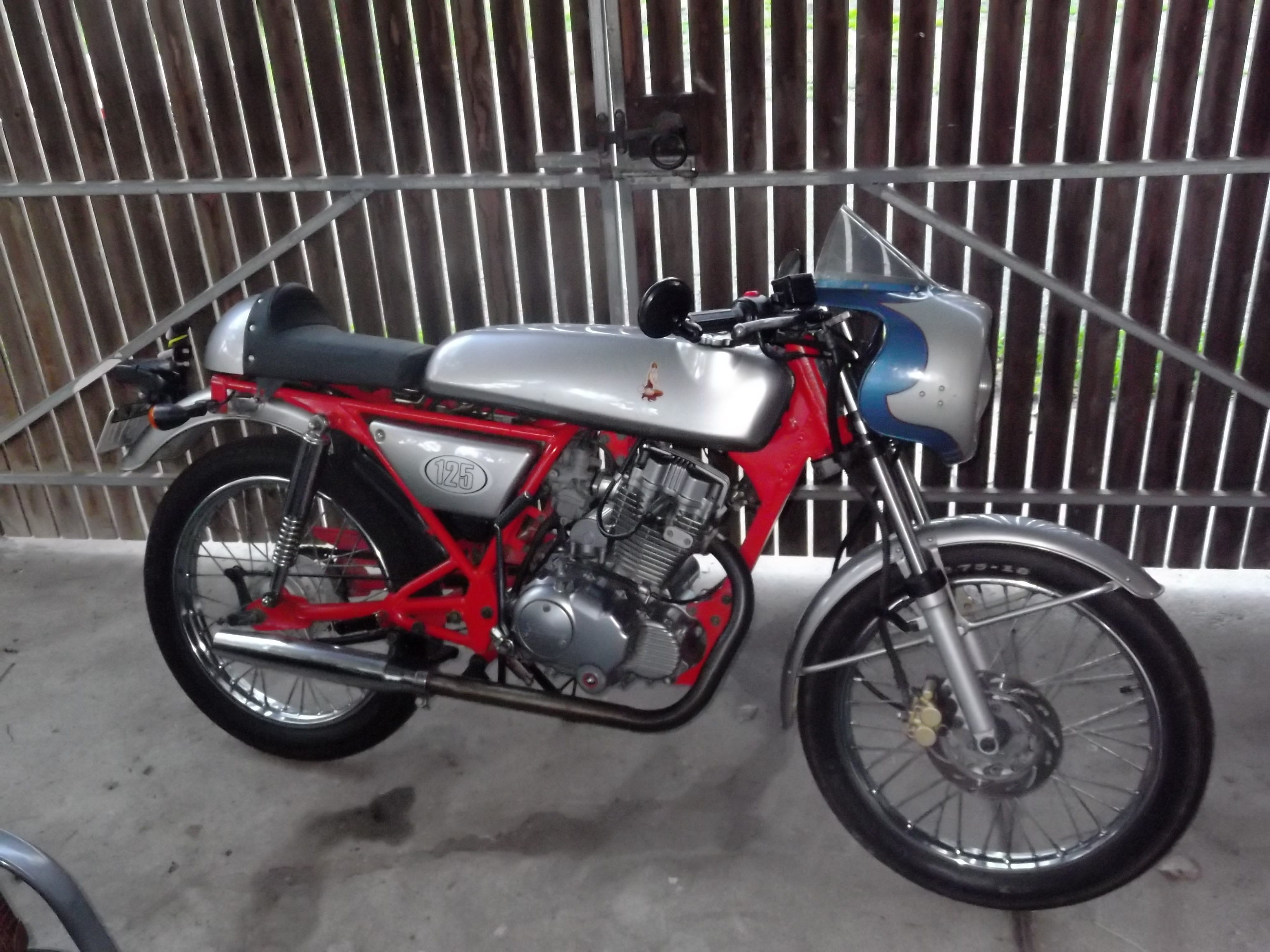

got the brackets for the new headlight and fairing today, just needed longer bolts to line it all up, but its looking good. just waiting for a speedo and a bracket to move the key into the side of the fairing, that and all the rewiring :/

New member PT40 posted photos of his 250cc 'Ace' elsewhere; I've copied them to this thread so nobody misses seeing them.
