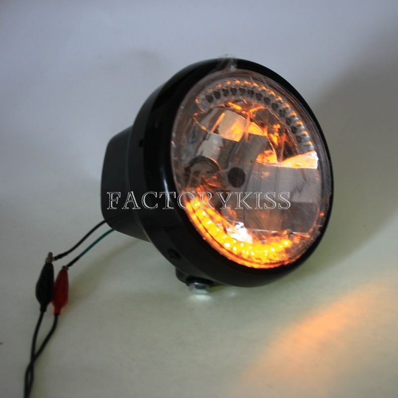

OR this one with the LEDs wired up as additional indicators
http://www.ebay.com/itm/7-H4-Motorcycle-Blinker-LED-Projector-Halogen-Turn-Signal-Headlight-Yellow-LJN-/151290883858?pt=Motorcycles_Parts_Accessories&hash=item2339a3af12
