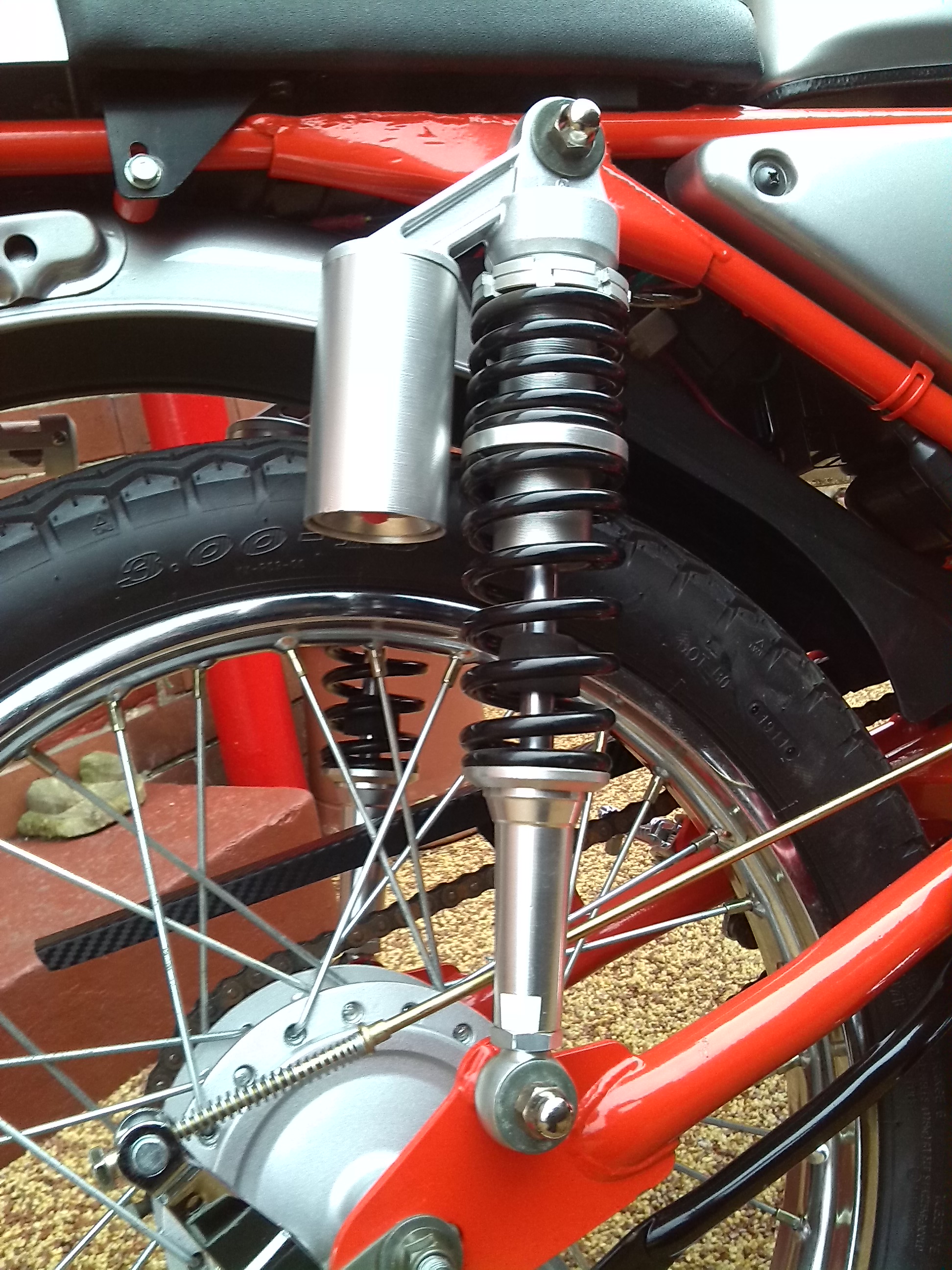

Hello again, I've just been looking on ebay and come across these rear dampers. eBay item number:231313526988
They are not only the same make I have on but are from my local dealer that I bought mine from. They fit on with little effort (rubber bush's to swap over). Please see attached photo
