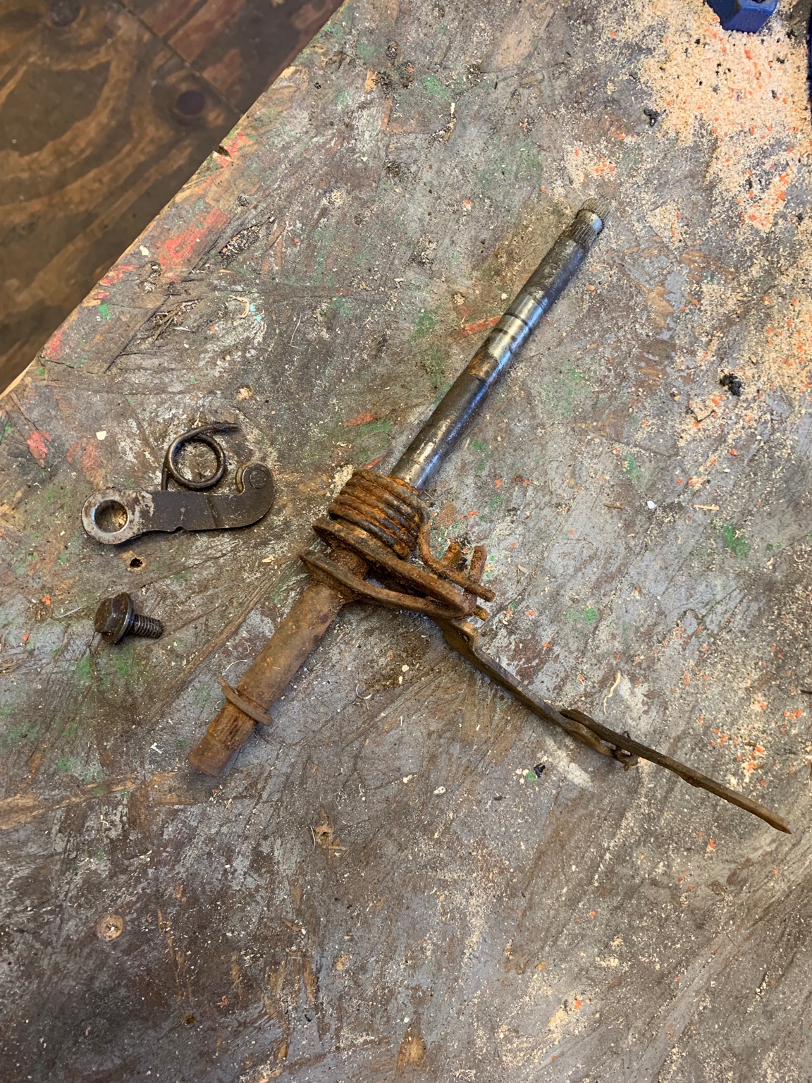

The gearshift lever spindle was one of the things that was exposed due to the broken cases, and the spring stay welded to the spindle was bent out of shape. Bent back the welded bracket, cleaned everything up on the wire wheel and it’s ready to reinstall.

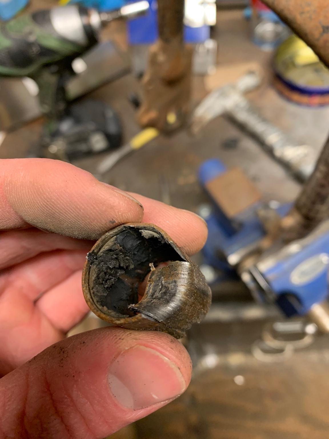

Well my bolt broke and I didn’t feel like going out to buy a stronger one so I ended up cutting them with the hacksaw and punching ‘em out. Easy enough!

Yeah, the rubber is pretty resilient. Hack saw cuts right through and the bushing pushes right out with a blunt punch once it’s cut twice. The second one came out real easy. 10/10 would recommend.
