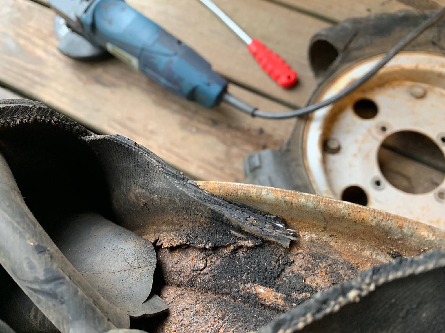

Switching gears, I fought with breaking the beads on the wheels for about an hour the other day before giving up. I was going to take them to a tire shop but decided to give it one more shot. What I ended up doing was cutting a section of the tire out with a sawzall, and then taking the angle grinder almost tangent to the rim and slicing the metal in the bead. Once I got through the steel wire in the bead, the tire fell right off.
If you’re careful, you can do it without touching the rim with the cutoff wheel. What I did was cut 3/4 of the way through the bead, then stick a tire spoon behind the bead and pry it out a bit to make some space. Then finish cutting through the wires using the spoon as a backer.

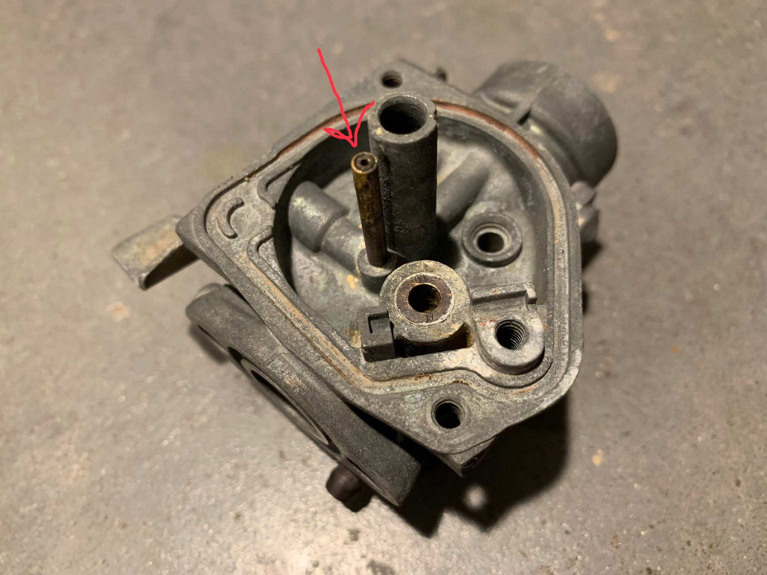

I put the carb in the ultrasonic a few weeks back and started cleaning out some of the passages. If anyone is familiar with these carbs...this brass tube seems to be some sort of pilot jet but it’s completely clogged. It almost feels like I’m hitting metal when I poke at it from the bowl side. But there’s a small hole inside the carb throat that leads down to it. There’s nothing called out as a pilot jet in the carb diagram though. The carb diagram in the FSM shows a slow jet but it looks like a traditional jet and not what I have here.
That's a Z50a carb drawing, but you have a Z50r/XR50 carb. Try heating the jet and see if you can soften whatever is in there. Also, make sure you wire is not too thick. Like a couple strands of electrical wire thin.
Clem found this post on planetminis talking about the same issue I’ve got. I think I’ll crank the heat way up in the ultrasonic and see if I can’t get it to soften up.

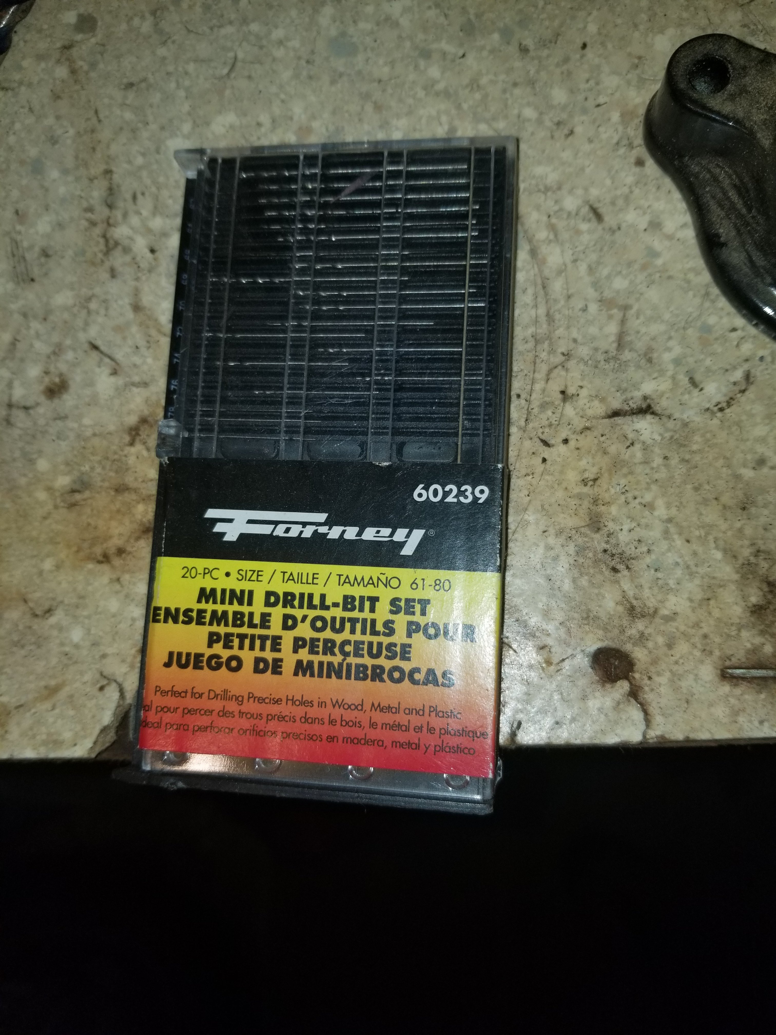

Mine must not have been clogged the first time I cleaned it...dont remember running wire through it. I normally cook it forever in ultrasonic cleaner and have no problem. I also have tiny "forney" size 61-80 drill bits I use for bad stuff.
