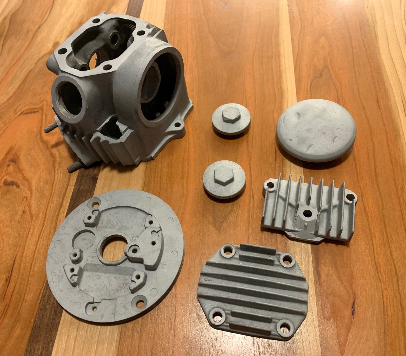

Spent some time on the blasting cabinet after getting the swingarm bushings out, and knocked out the top end bits. Some damage to the fins etc but I’m not too worried about it.

Prepped and painted more engine parts over the weekend. Came home at lunch today and threw the tray in the oven to cure. I’m using Dupli Engine enamel primer/paint and I love this stuff. It’s actually gas resistant without being cured after but since this is all apart I figured why not?
My process is as follows:
-Degrease the heavy crap with mineral spirits and a toothbrush
-Air dry, media blast all surfaces, blow off in blast cabinet
-Soap and water in the sink with a few small brushes. Straw cleaner brushes are great for small areas and bolt holes
-Blow off w/compressed air
-Pre bake 250 degrees for 20 minutes to purge any moisture from the cast aluminum
(Here i put gloves on and never touch the bare aluminum if I can help it)
-Tape up sealing surfaces, etc.
-Wipe down with acetone and cotton rag, blow off any dust w/air
-Prime
-Paint
-18 hour initial cure
-Post bake 250 degrees for 25 minutes
I do 2 mist coats and one medium coat of primer, wait 30 minutes, and then 3 light coats of color with 10 minutes between w/10 minute flash time. I give a few extra minutes if it went on thicker than planned. These went on heavier than I would like on the paint but it’s tough to get good coverage between the fins without spraying a little extra.
Interior surfaces usually get a final wipe down and q-tip cleaning with isopropyl alcohol. I always fit up any spinning parts with oil and make sure there are no stray glass beads that will bite me later.

Nick do you spray primer on the engine first and then paint? I thought Duplicolor engine enamel had primer built in so-to-speak.
Looking good man.
Looking good man.
Yeah Jim, see above but usually 2 very light dustings and 1 medium coat does the trick. I find that it helps to hide the casting imperfections that show up in the bead blasted surfaces and gives a very uniform look to the painted finish. Probably not necessary as I think you're right the instructions make it seem like the primer is optional.
I updated the last post to show my full process for painting engine parts. Hopefully this will be helpful.

FWIW, this is pretty nearly exactly the process I use for non-catalyzed spray can paint - Duplicolor engine paint nearly exclusively these days as it is available everywhere near me. Really great durable results. I bake about 30 minutes after the last coat a little cooler and for about an hour. A second bake after a complete cool down seems to add a little durability.

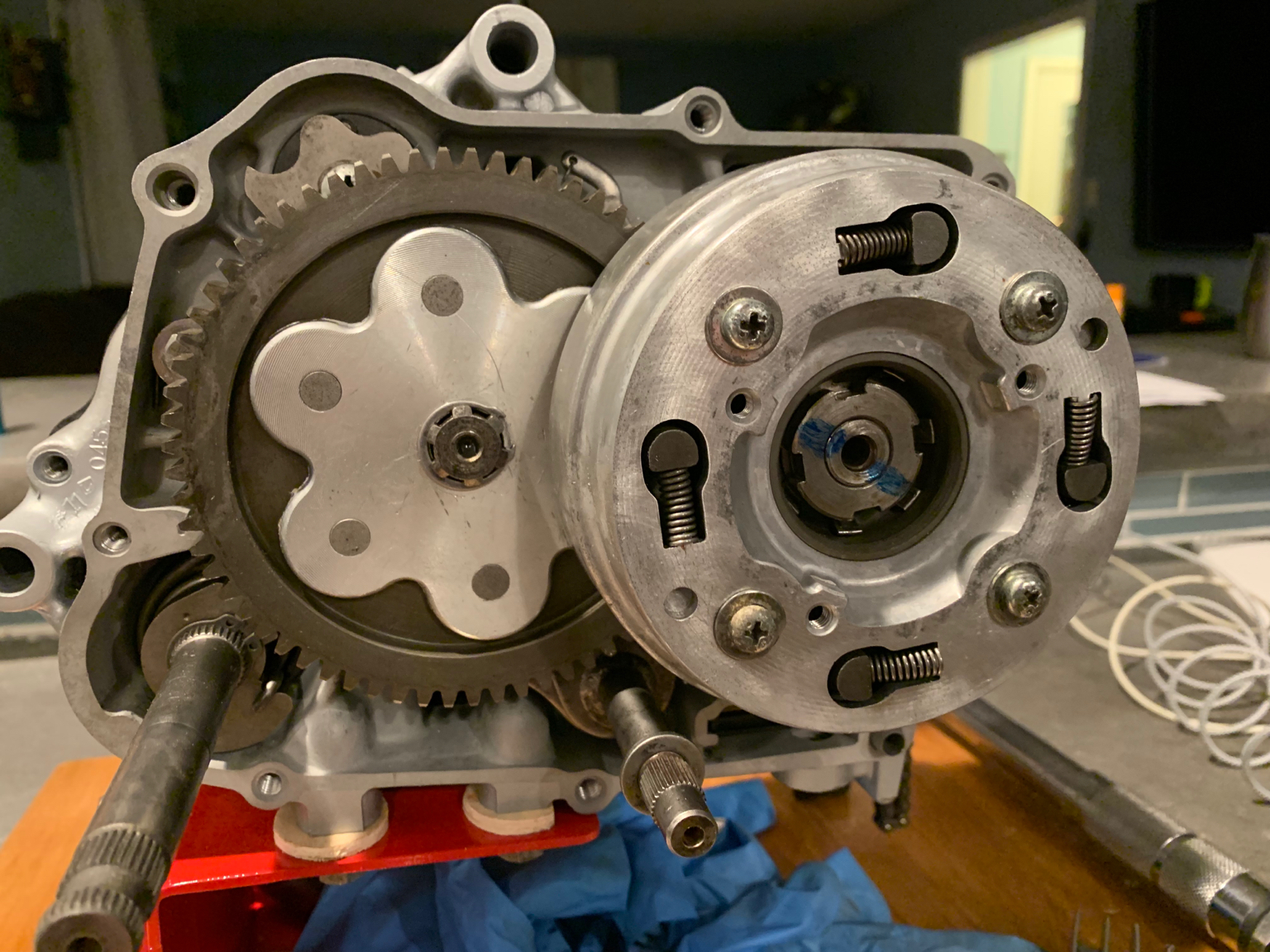

Got the clutch rebuilt with the donor basket and internals. I got a used basket from an ATC70 which has the same clutch but longer springs and a different disc layout, so I swapped in the 50 springs and discs and got everything in place. Also replaced the circlip on the big drive gear as the original one was stretched out from removing and installing it.
A while back I made this clutch holder tool. It’s just some angle with a couple of holes and m6 bolts. Works on pretty much any wet clutch I’ve run into so far. I had to modify it a bit to fit in the small holes on this clutch but definitely worth making.
Self reminder to bend down the locking tabs on the washer under the clutch nut.
Before pic for reference ;D

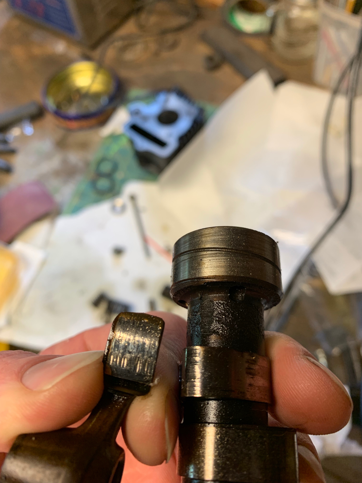

Thanks dudes. I'm making progress slowly. The cam and one rocker was toast so I'm waiting on some funds to free up to grab a new cam to throw in.
clem said:
Any plans to refurbish that clutch cover?
LOL. I still have all 3 pieces of it. I actually scored a stator cover and clutch cover with all the auto clutch shift linkage and actuator a few days after I bought the bike for about $50, soon I'll get that blasted and painted and ready to install.
Valves lapped in. Cam and one rocker were toast so I have some (more) new parts coming in.
