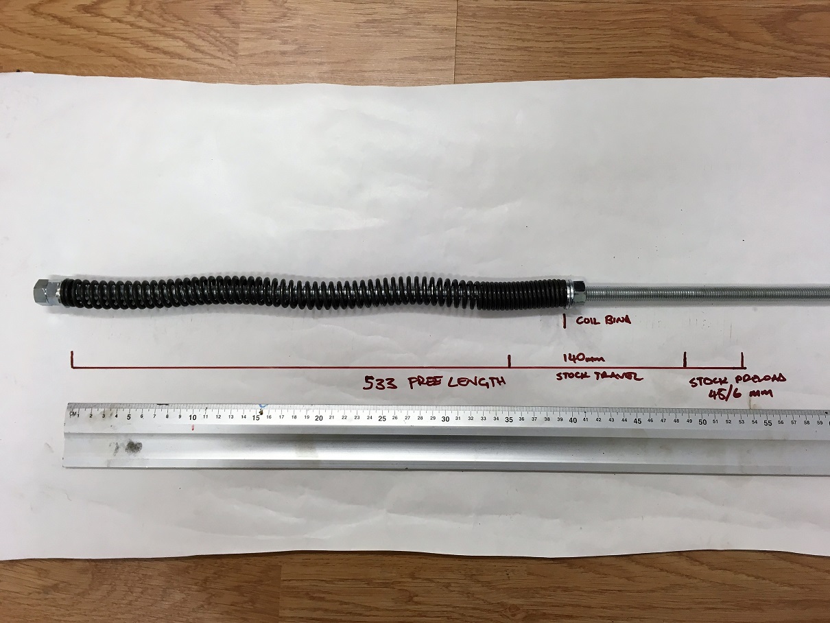

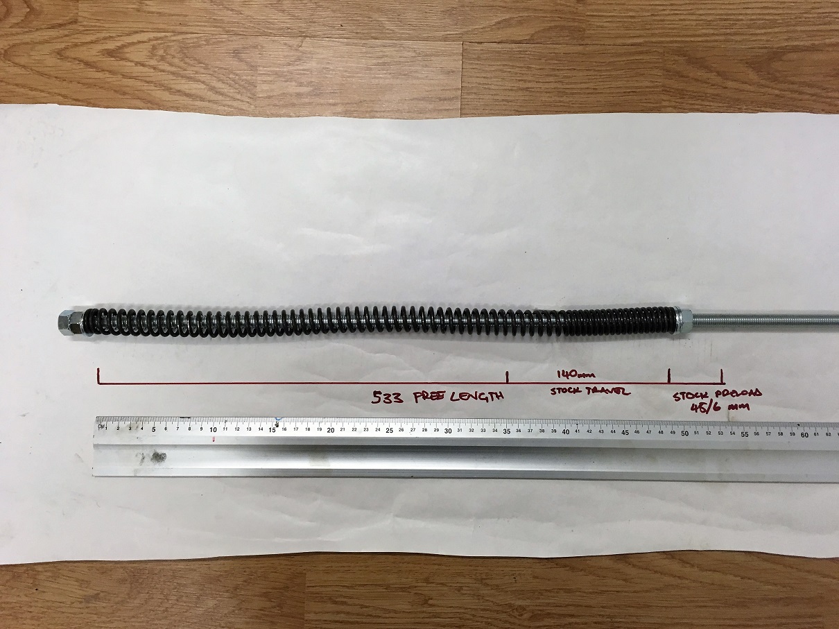

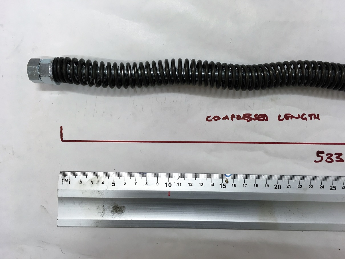

Anyway, here are the results of testing the stock SR250 fork spring so I know more about how it looks and behaves in use. Interesting! Now I can start experimenting.

One important point about the stock SR springs though; if they are cut, the rate increases with every coil removed. By the time you remove 5 of the working coils of the main spring, the rate is already up past 5N/mm - which is more suitable for a 90kg rider. I will need to test this of course with the threaded rod jig to see how much stress is put on the cut spring when it is compressed the 140mm (plus maybe 10-20% preload) of travel. Perhaps this much movement with a shorter spring will put it outside of its working range and begin to deform it over time.

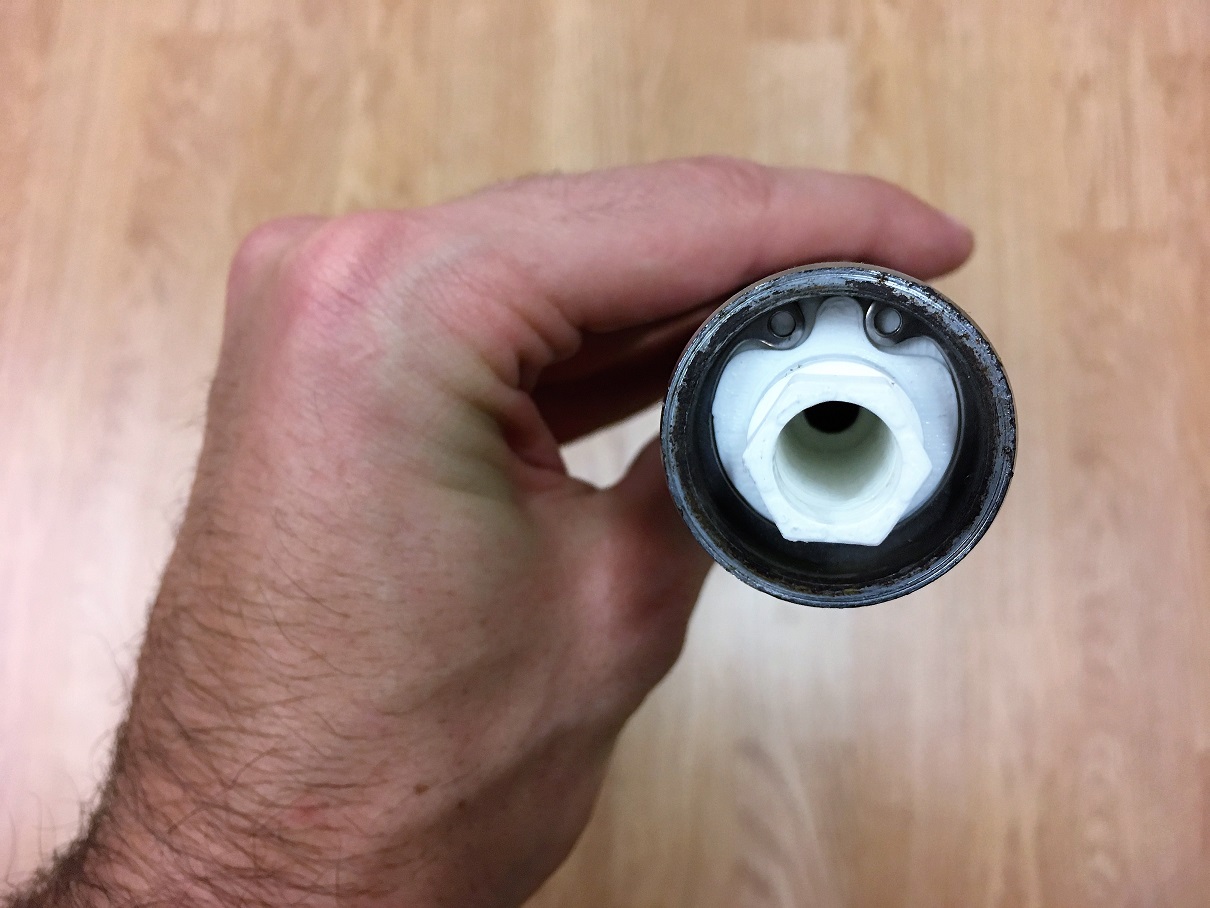

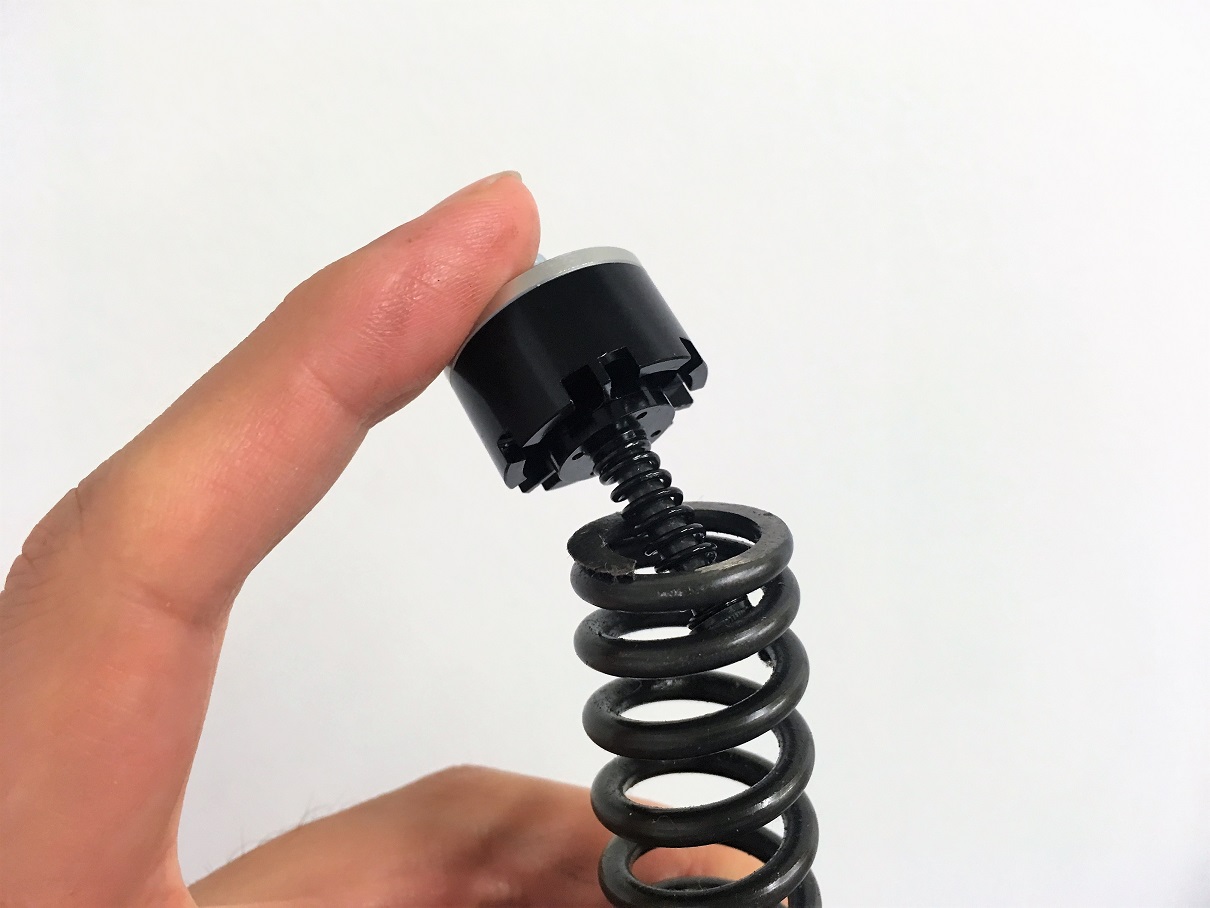

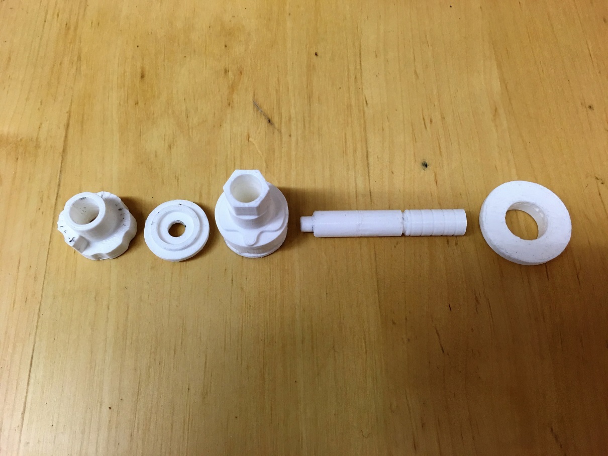

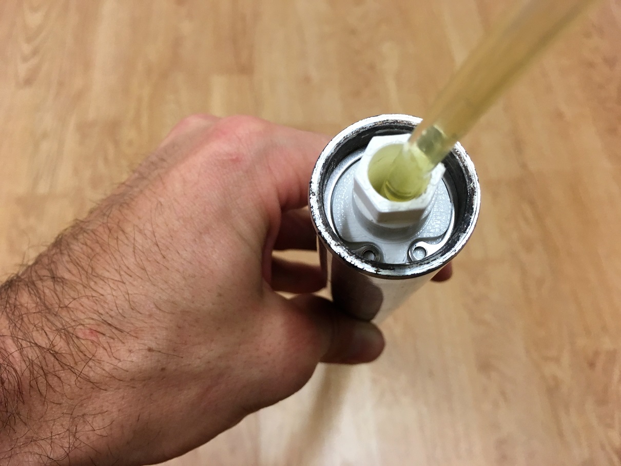

Have been spending a lot of time in CAD and prototyping trying to get the adjustable preload caps to fit and work within these unique constraints of this fork. Remember, all other adjustable caps are screwed in place! After a few attempts and failures, I think I have something that is close enough it is worth doing some engineering drawings and getting some metal prototypes machined up.
The idea is that the caps are installed easily as in my previous prototype, then locked in place with the circlip. The adjustment rod has an M10 thread and provides 20mm of adjustment. It is also completely removable so that fork oil can be added or removed with a 6mm tube (through the hole in the adjustment plate/spacer), allowing fork oil height adjustment without needing to remove the entire fork cap. I have found suitable sized orings for each component as well and adjusted the parts to suit. I still need to order them though - hence the prototypes missing them.
Thoughts?

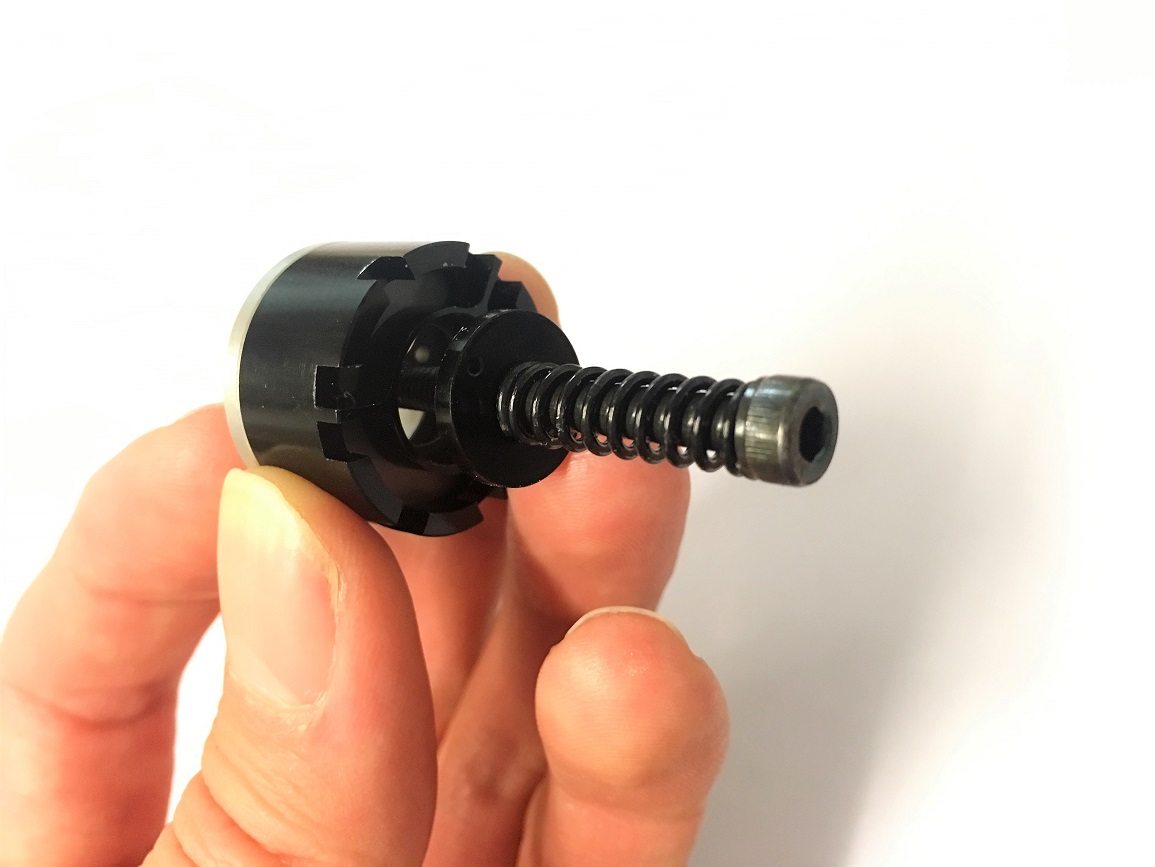

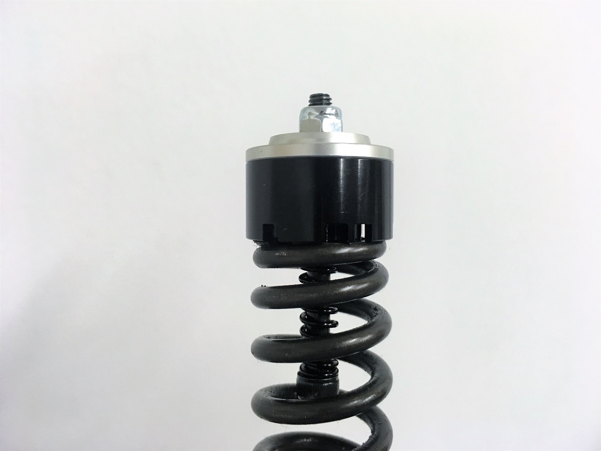

YSS fork emulators in the correct size (almost!) arrived this week! Can't wait to install and test them. Like any curious engineer, I took them apart to see how they are built up. Pretty nice stuff. Good quality and impressive fitment/tolerances.
Only thing is, they don't quite fit into the SR's damper rods like they are supposed too. I'll turn that small piece of aluminium down on them so they fit nice and snug there.

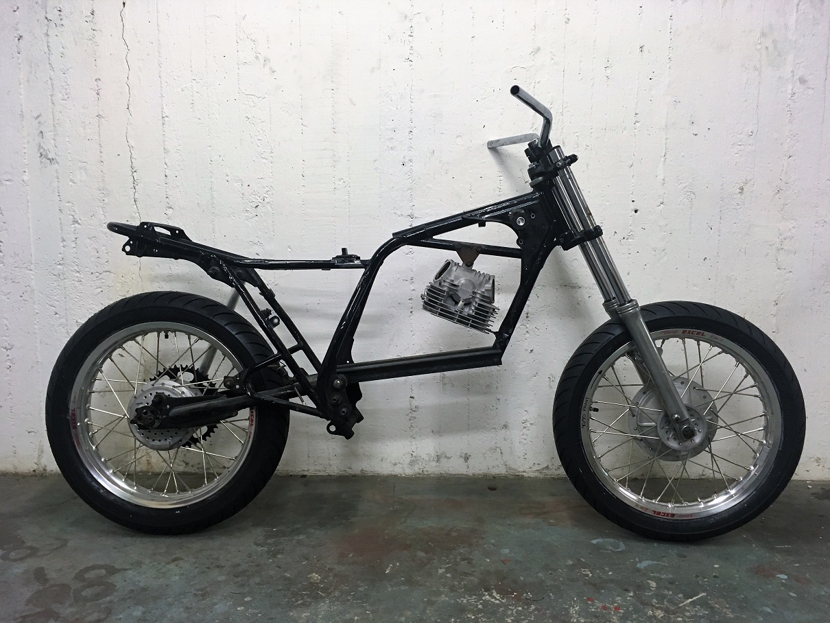

I also bolted up the wheels to get this project's first rolling chassis! Woohoo! Haha, no, now I will draw the basic geometry into CAD and work out what specifications I want and how I can achieve that - fork height, rear shock length, ride height, rake/trail and different to the other bikes I have built... ground clearance! This will be worked out with rearset bracket position as well. Something that has frustrated me with previous SR250 builds is the lack of ground clearance when cornering hard. I don't think these bikes were designed to corner hard but they should be able to with the right upgrades and some better foot clearance - the pegs are always the problem.

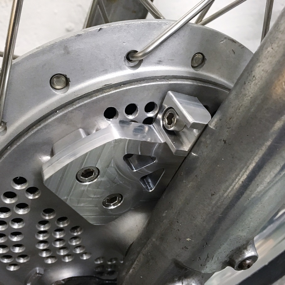

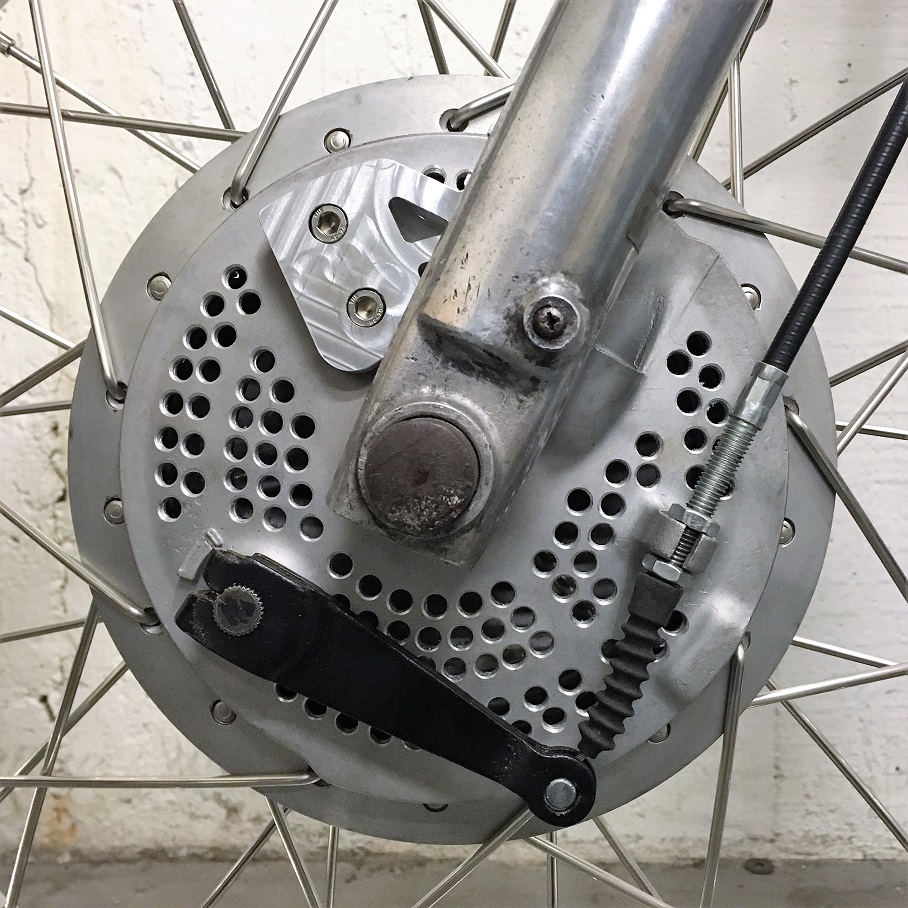

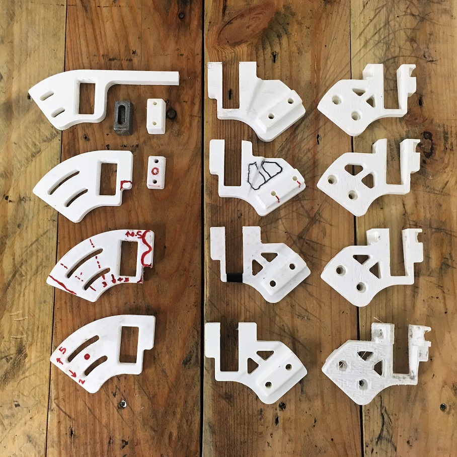

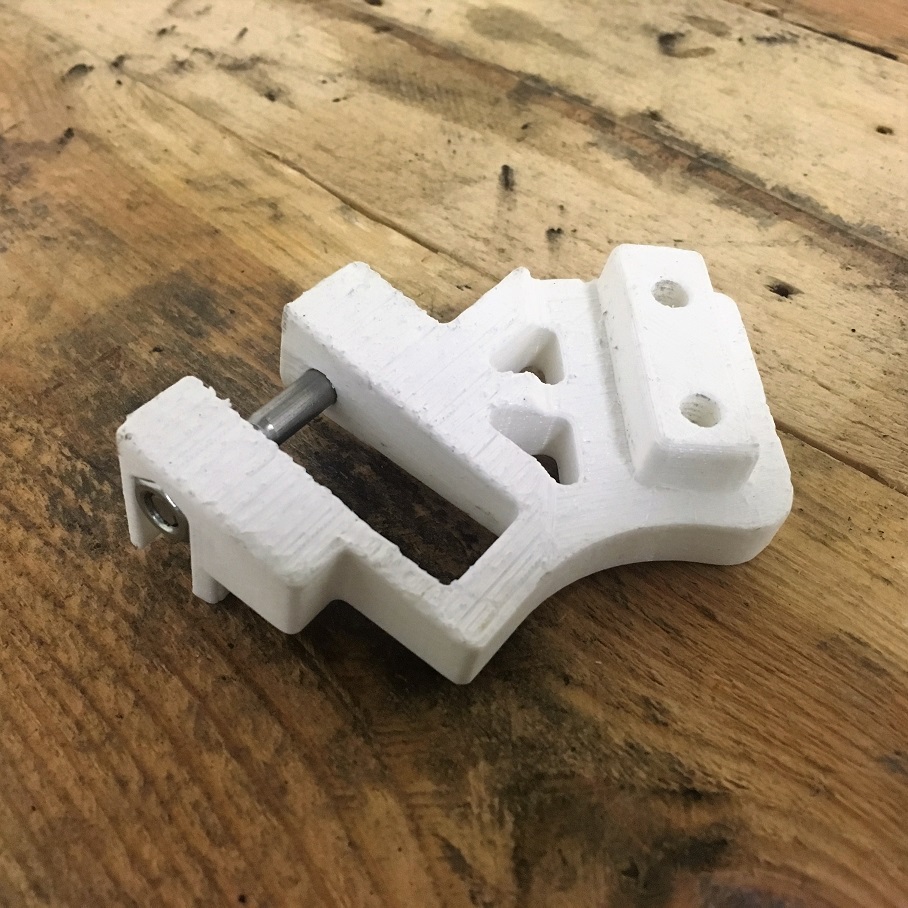

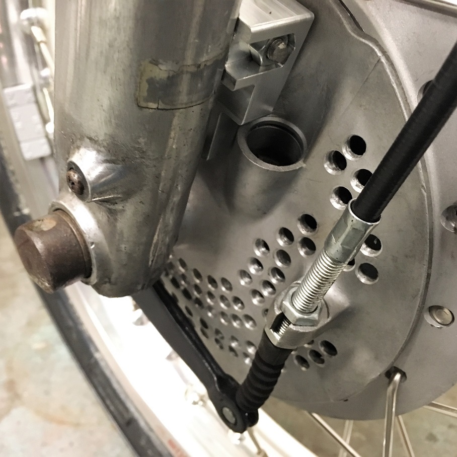

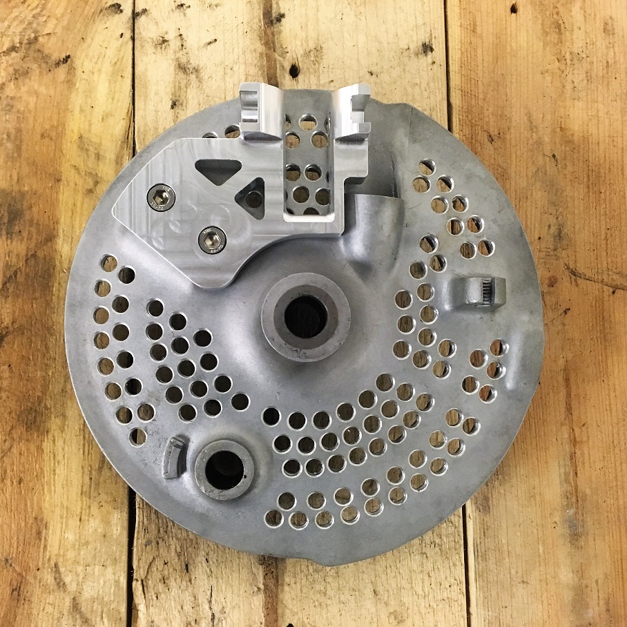

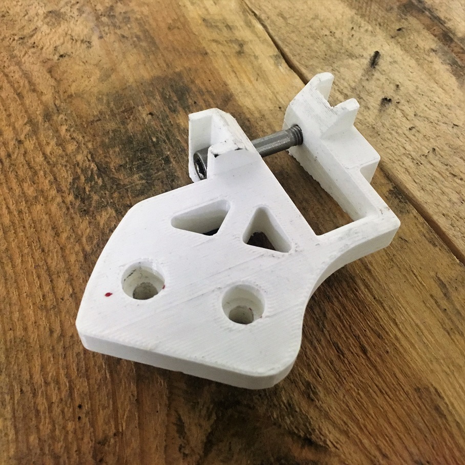

Just before Xmas I received the machined brake perch repositioning bracket. Which I have been pretty quiet about since the last time I mentioned it - that is because it took an embarrassing amount of prototypes to get it right! The angle and position on the fork was just doing my head in. Anyway, it came up mint and works a treat. Now I just need to make a small eyelet for the brake cable to move through and specify a custom cable for Venhill to make.
You can see I took some advice from a few of you with the way that it is mounted. The only difference really is that the bolt does not act like a pinch bolt (because of the 3 degrees draft on the leg boss), rather it is just done up tight enough with a lock nut so that it holds itself in position and stable, and takes the braking loads together with the bottom piece of the opening in the bracket.
