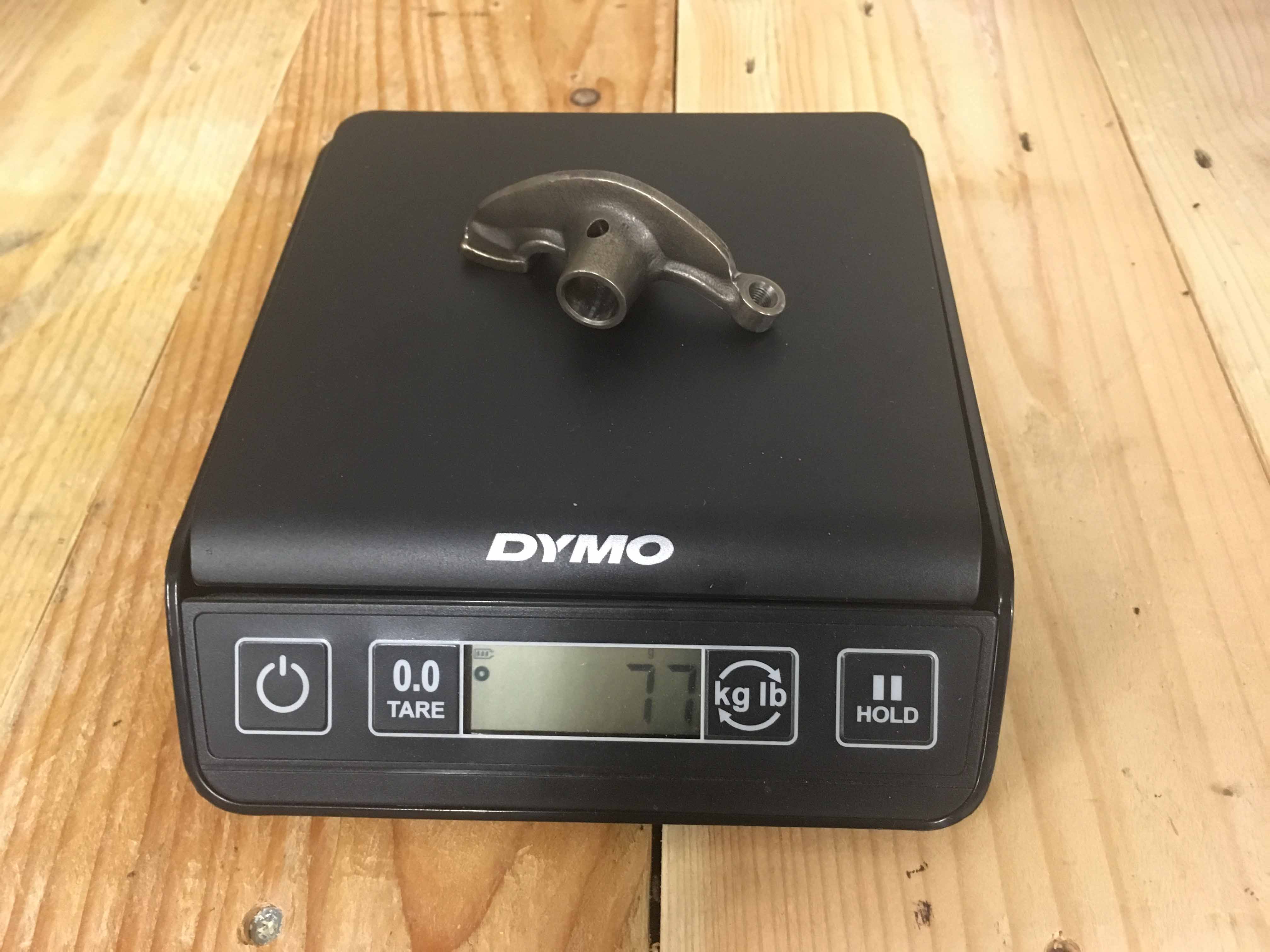

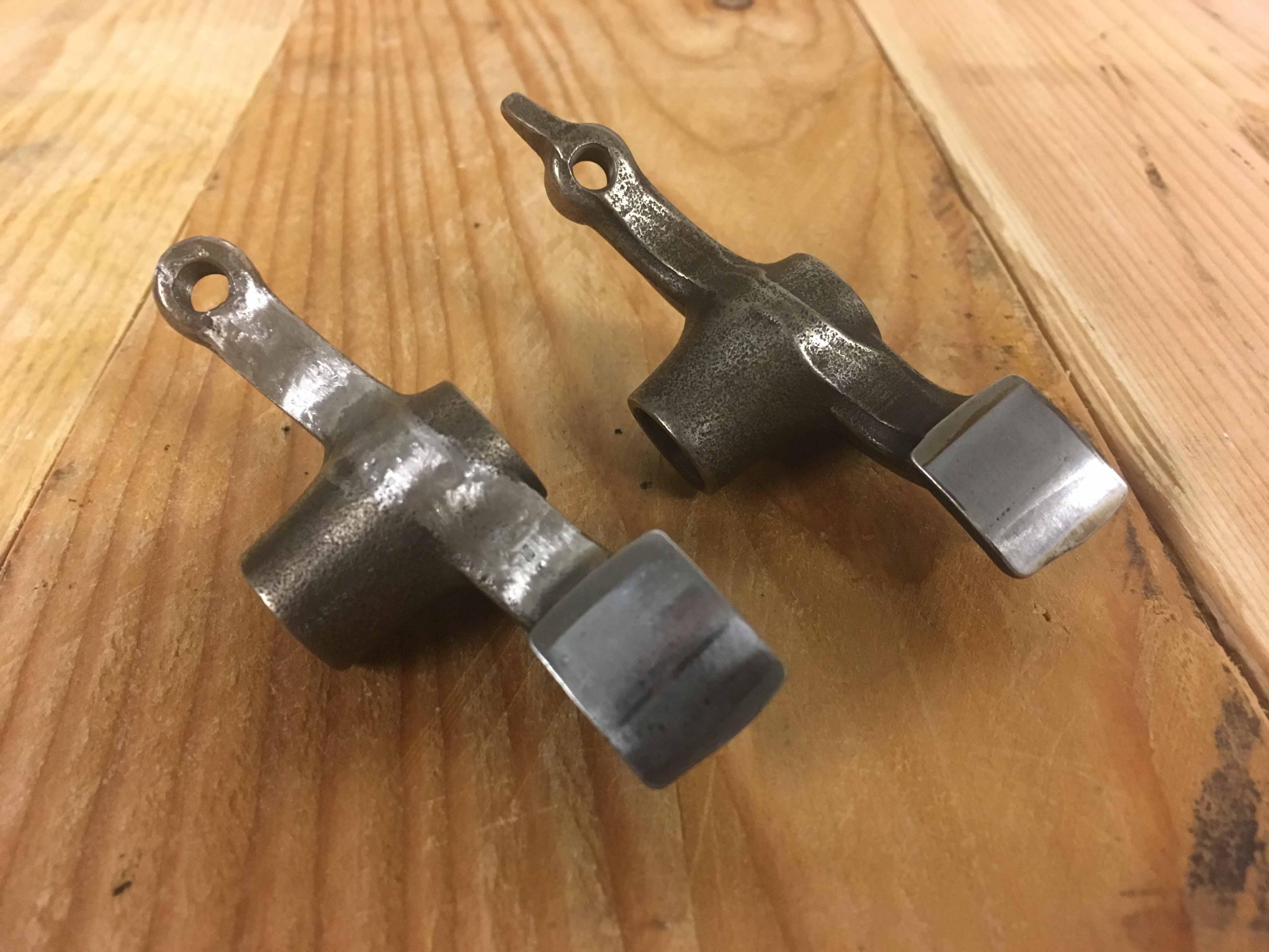

As an experiment, I already tried lightening some rockers I had from a spare engine. Good and worth while result. Especially becuase the weight shaved is at the points furthest from the fulcrum - where they 'weigh' the most to the valve train. Those small tabs at the end of the rocker are for the decomp lever on the XT and TT model engines and because the rocker is a symmetrical part, Yamaha have used it on the intake side as well - where it is not needed (where neither are needed in the case of the electric start SR). I will be converting to kick yes, but am hoping with the right technique, won't need the decomp set up from the XT engine.
Hoping to lift the rpm ceiling to 10,000 by putting the whole valve train on a diet with the aforementioned mods ;D

killerx said:
You should be able to drill some holes in the webbing of the rockers.
Thanks man, this is the kinda advice/encouragment I was looking for ;D I am so sure I saw a great post about someone doing just that over on a Yamaha quad forum, but can't seem to find it now. The only gains through this method though would be smaller holes right out towards the ends of the rocker. Because drilling holes close to the fulcrum may make it lighter, but won't do anything for lightening the load on the cam or the valve spring. Worth investigating on these scrap rockers though for sure!
Reducing weight is almost always a good thing as long as strength is not compromised. However, it is worth keeping in mind your end goal. What do you achieve? Do you have in mind increasing safe operating rpm? Generally higher revs make possible higher output. Or do you plan on more aggressive cam profiles which will increase valve train accelerations? (same consequences valve train wise as increased rpm) Valve trains are often the limiting problem in output because the natural frequency of the springs needed to control the valve train components becomes too close to the engine rpm. Drop a spring on the floor and it will "ring" or oscillate for a bit at its natural frequency. If you "excite" it by driving it to this natural rate (or a harmonic of the natural rate) it will try to continue this rate of oscillation instead of following the camshafts intent. Commonly called valve float and can be very destructive. The solution is to require a lighter spring (or stiffer)(lighter meaning lower in mass in this context) that has a higher natural frequency so as not to be excited by the available rpm. A lighter spring will of course require lighter valve train parts. Valves, pushrods, lifters, spring retainers, etc all move (mostly) linearly so simply making them lighter overall works toward this goal. Rocker arms on the other hand rotate, so how you lighten them is less straight forward. Mass at the center of rotation is of little concern as it moves very little, where mass at the end of the arm(s) is very important. However, loads on the arm(s) generally become higher with stiffer springs and/or increased rpm, so one should be careful when lightening these parts so as not to compromise the beam strength of the arm. Likely you would prefer a stronger rocker than a lighter rocker - which is not to say you still don't want the lightest you can get! Anyway, the point is to be careful and thoughtful when altering your parts. I'd say the lightening you have done so far has no down side, but potentially reducing the beam strength will provide negligible gains at best and potentially unnecessary troubles. Having your valve train disassemble itself at max revs can be unpleasant!
Thanks for the inout jp! I'll refer you to Reply #34 in this thread - just a few posts up on this page. There I state all the engine mods I plan on doing with all the goals and some of the reasons. Yes, lift the rpm ceiling to 10,000 rpm by putting the whole valve train on a diet (hence the whole rocker arm exercise) and using modern beehive valve springs - to avoid many of the problems you mention.
Good point about the rocker mods though, this was my gut feeling... Further mods might risk strength or may even result in flex at high rpm?
