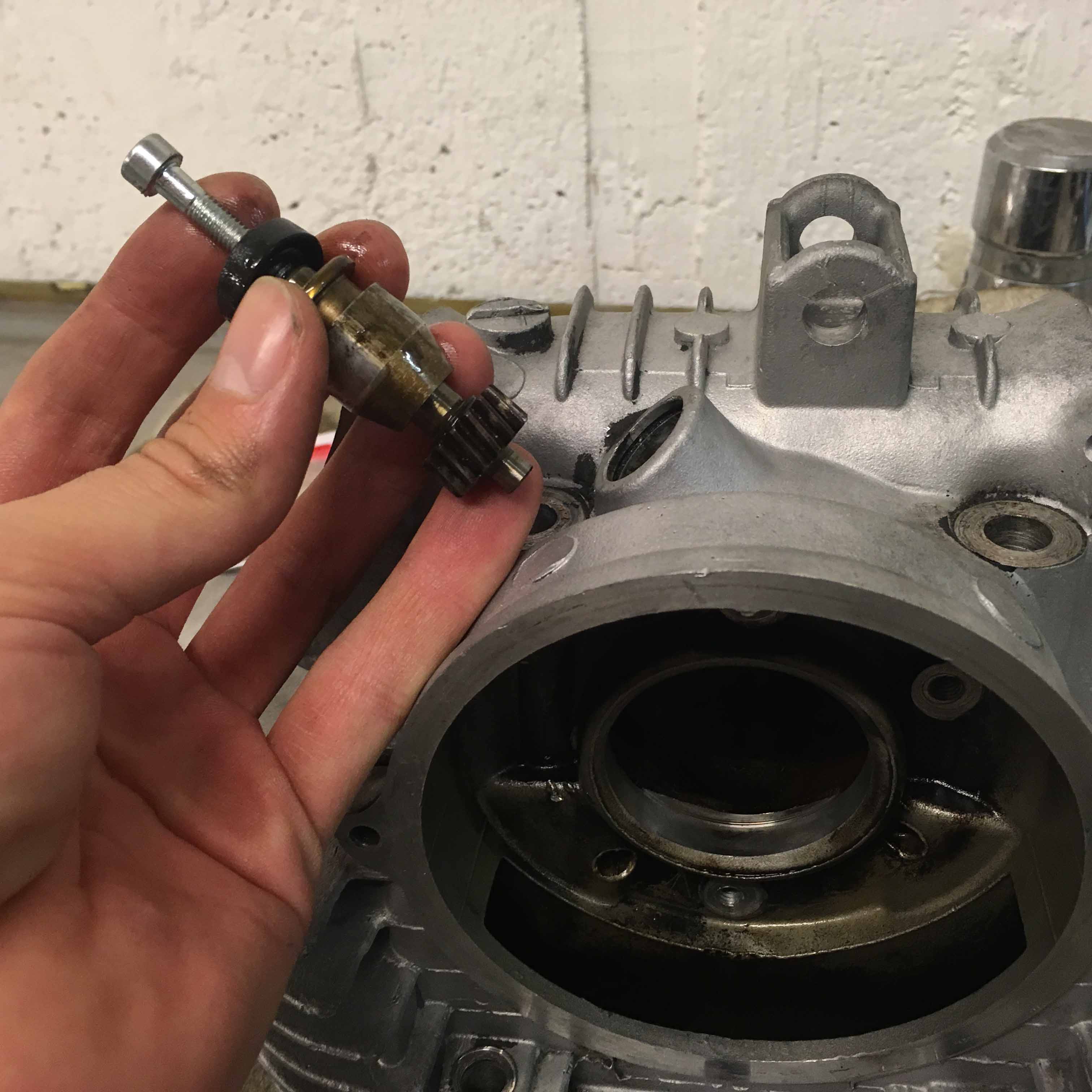

While preparing and packing up the head to send away for machine work, I decided to see if I could remove the tach drive system entirely. The answer is yes. But then there is nothing for the tach-plug I have made to push up against and it sinks into the hole in the head too deep to form a seal. So I put it back in! It will not be driven anyway because the cam regrind I got was done on a non-tach drive cam (missing the worm gear drive). Anyway, if anyone was curious, this is what the assembly looks like...

Why not just drill and thread a hole on the top side. Then make a aluminum plug with a flange and a plain hole? Worst outcome would be oil leakage in case the bolt unscrews and the plug comes off.
Hit me up if you want one done and I’ll squeeze it in at work.

A custom plug could definitely be a solution! You work with CNC machines?
I got 3 of them at workHowever I would turn it manually in the lathe and mill since that would take way less time since our 5-axis ain’t running at the moment.
Just send me a drawing and your address and I’ll try to sort it out for you.
I'll take you up on that! I'll need to measure things up and design it first so it may take a while before I get there. Cheers!

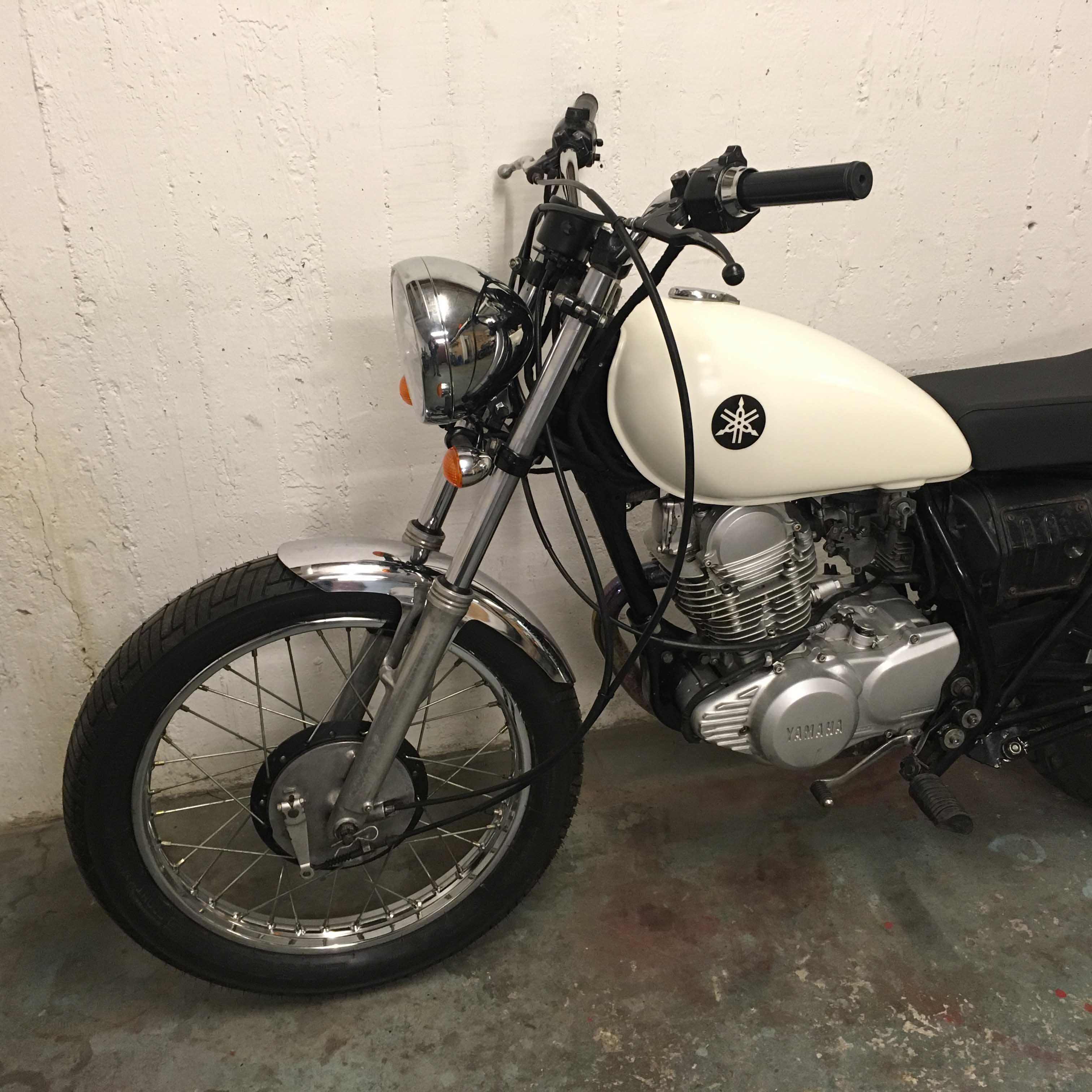

Been pretty quiet recently - been working on the custom for Lars. Now it is finally complete though! It came out pretty good for a 4month, 60 hour total (spare time after work) project. Really happy it is complete and can now get back to this. Lars was stoked too, which made the whole project sweet and well worthwhile.
