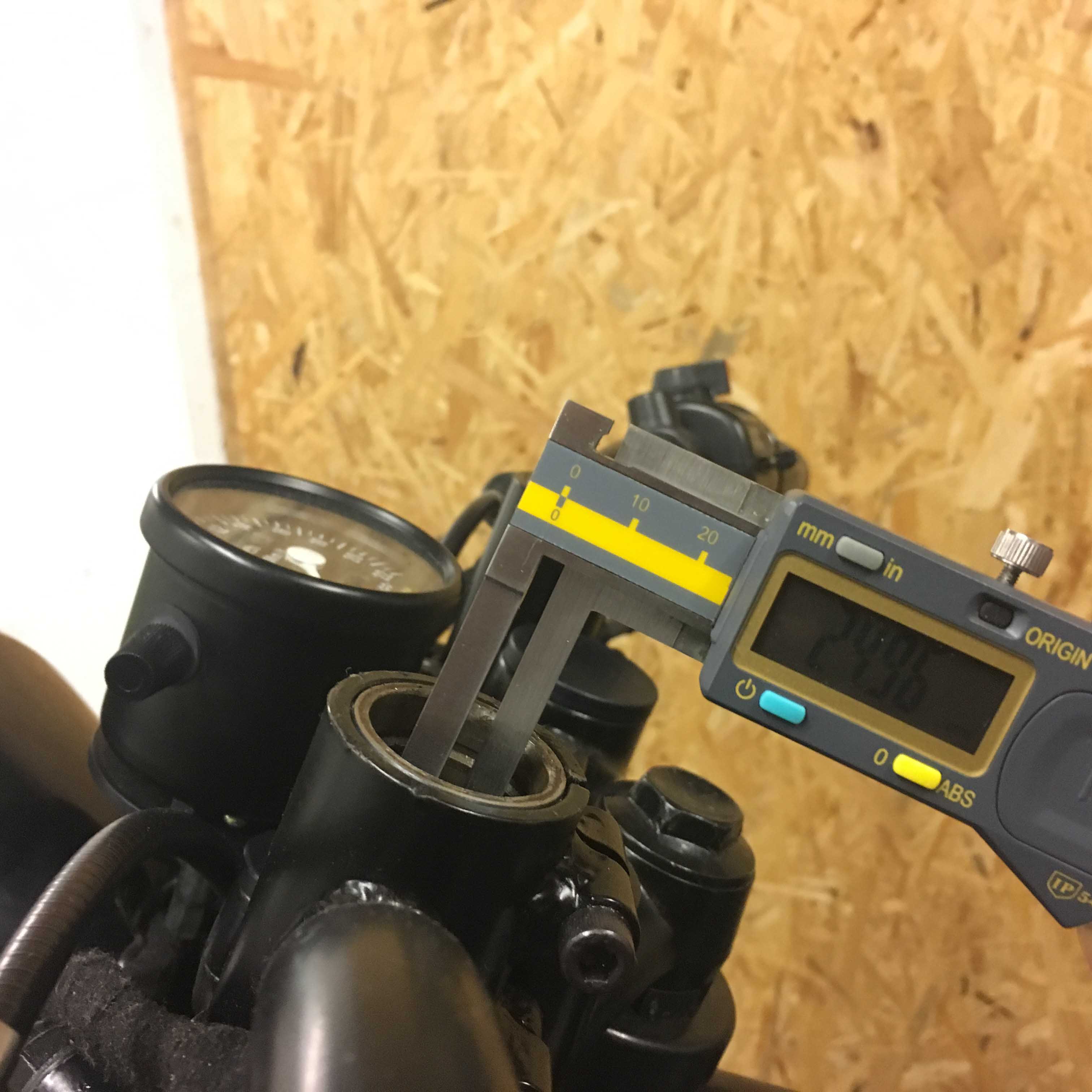

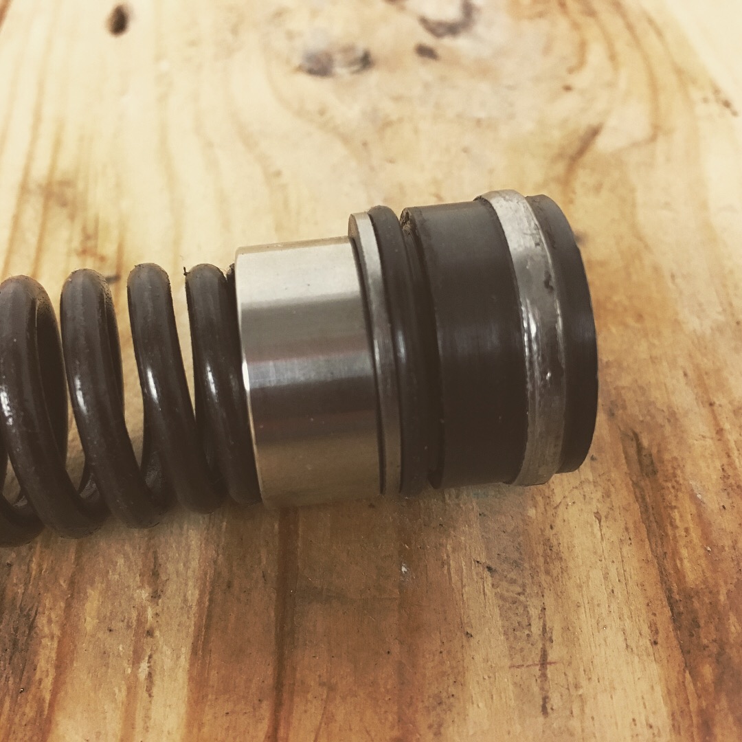

I have taken it upon myself to start designing an adjustable preload fork cap. First things first, measure up the fork tubes, caps, c-ring, oring etc. I have also ordered some custom stainless spacers for the black Jadus SR because I want to sell it and the forks are the only thing letting it down. I ordered several 5mm thick spacers and will experiment with how much preload feels good. Then I will use that as a basis for the adjustable ones.

The spring sits on top of the emulator and the emulator sits on top of the damper rod. Generally the emulator is the same OD as the spring. The emulator valve preload spring (the part that actually does the work) is inside the fork spring.
Ok well if the emulators sit like you say, I should order the 23.8mm YSS emulators and give them a crack (internal diam of SR forks is 23.95mm roughly).

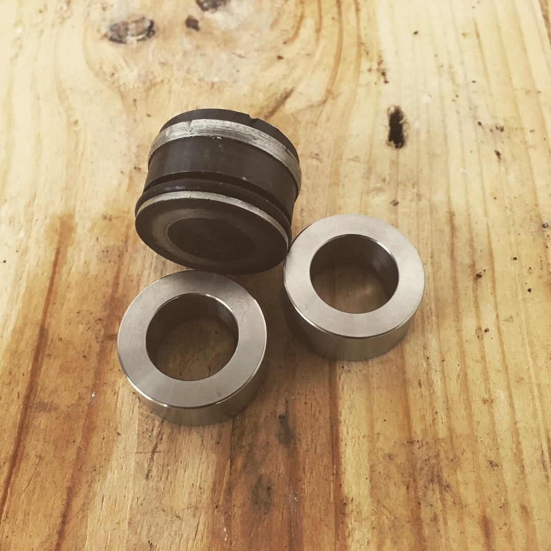

Anyway, I received the prototype spacers I mentioned in a previous post. I'll install them along with a little extra fork oil and see how that rides.
My latest idea is to somehow design the adjustable spacers to have a through hole in them when the preload adjuster is backed all the way out - so that you can remove and add fork oil with a small tube without removing the entire cap. This then gives adjustment on the spring (with the preload adjuster) and on the dampening - more oil, less air in the fork, harsher damping, less oil, more air in the fork, softer damping.

I tested these spacers in the black Jadus bike along with 170cc (168 in manual) of 20W fork oil in each leg. It improved the forks about 10%, barely noticeable. I have tried 200cc in each fork leg in another SR and that seemed to help a little more - it probably didn't make the fork perform any better, just made it feel less mushy.
I am convinced that for this build, I will use emulators for improved damping and then spacers with adjustable preload for spring control. However, I will cut out the soft part of the springs and replace with a long spacer. The fork is just always going to be mushy with that first pathetic spring rate.

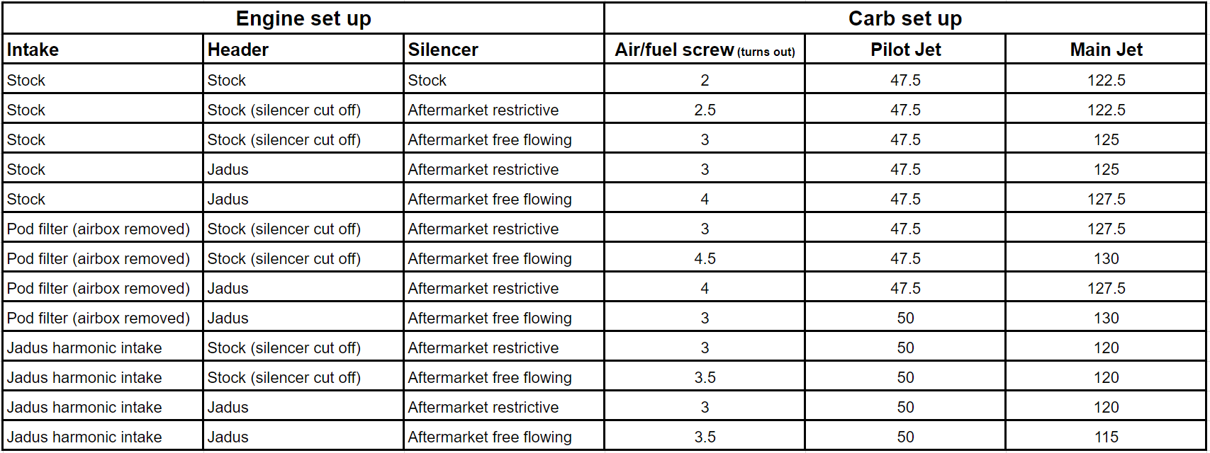

I have however managed to add a video showing how to service and rebuild the SR250 carb, plus written a blog post to compliment it. I also created a bit of a jetting guide for SR250's with various intake and exhaust set ups - share for all and report your own feedback and results! :D :D :D
https://www.youtube.com/watch?v=FKtTxoJAO8g&t=1294s
https://www.jadusmotorcycleparts.com/single-post/2018/05/17/Yamaha-SR250-carb-rebuild-maintenance-tuning

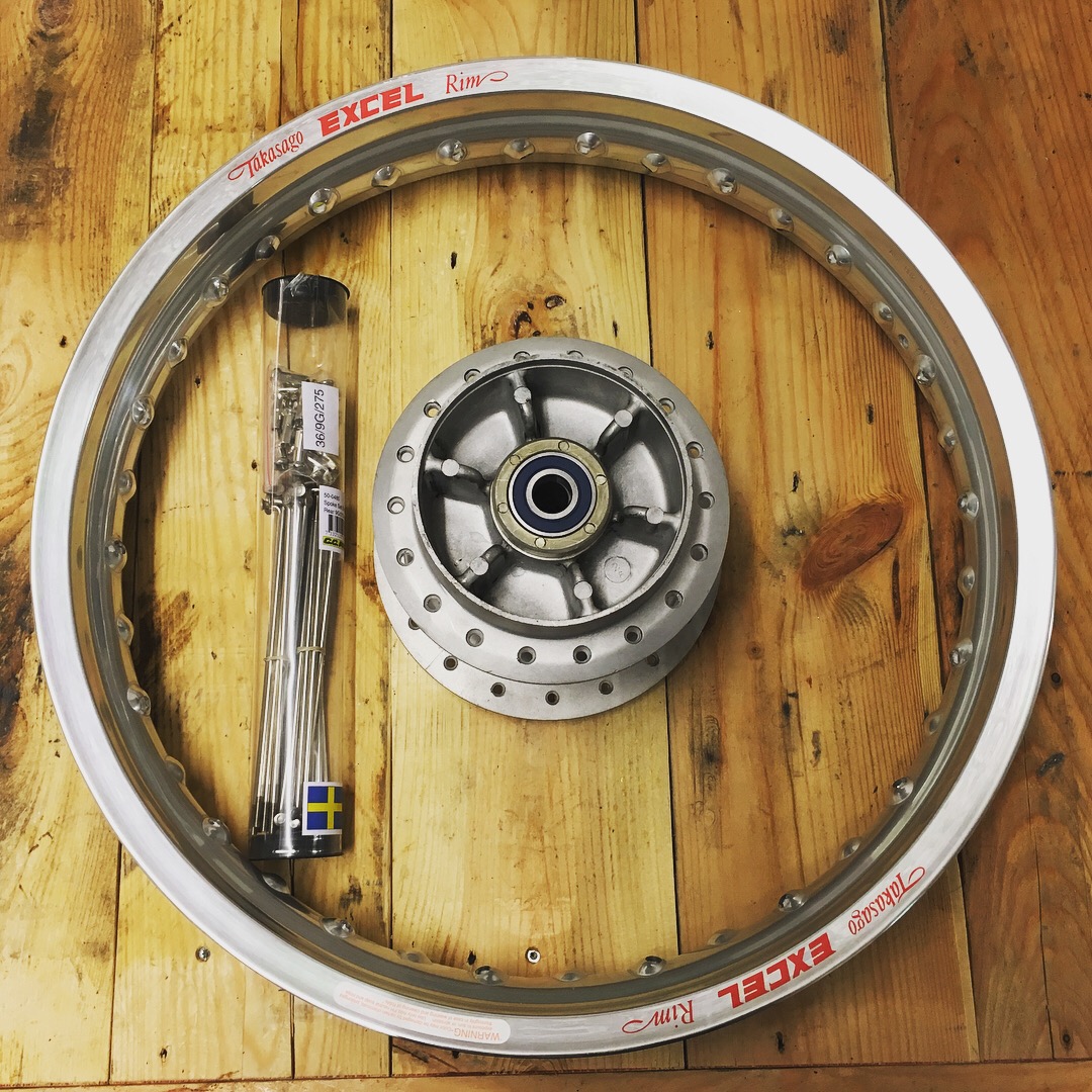

Finally an update worth posting... I got around to lacing up one of the wheels this week. I am not sure how other people do it, funnily enough I have never watched a how to vid, but I have screwed up a few times and learnt some tricks by doing. Now that I am more confident with the process (have done around 10 wheels I guess) I think I'll make a video how to do it. Anyone have any good tips? Ie good youtube videos or blog posts/articles other people have done?

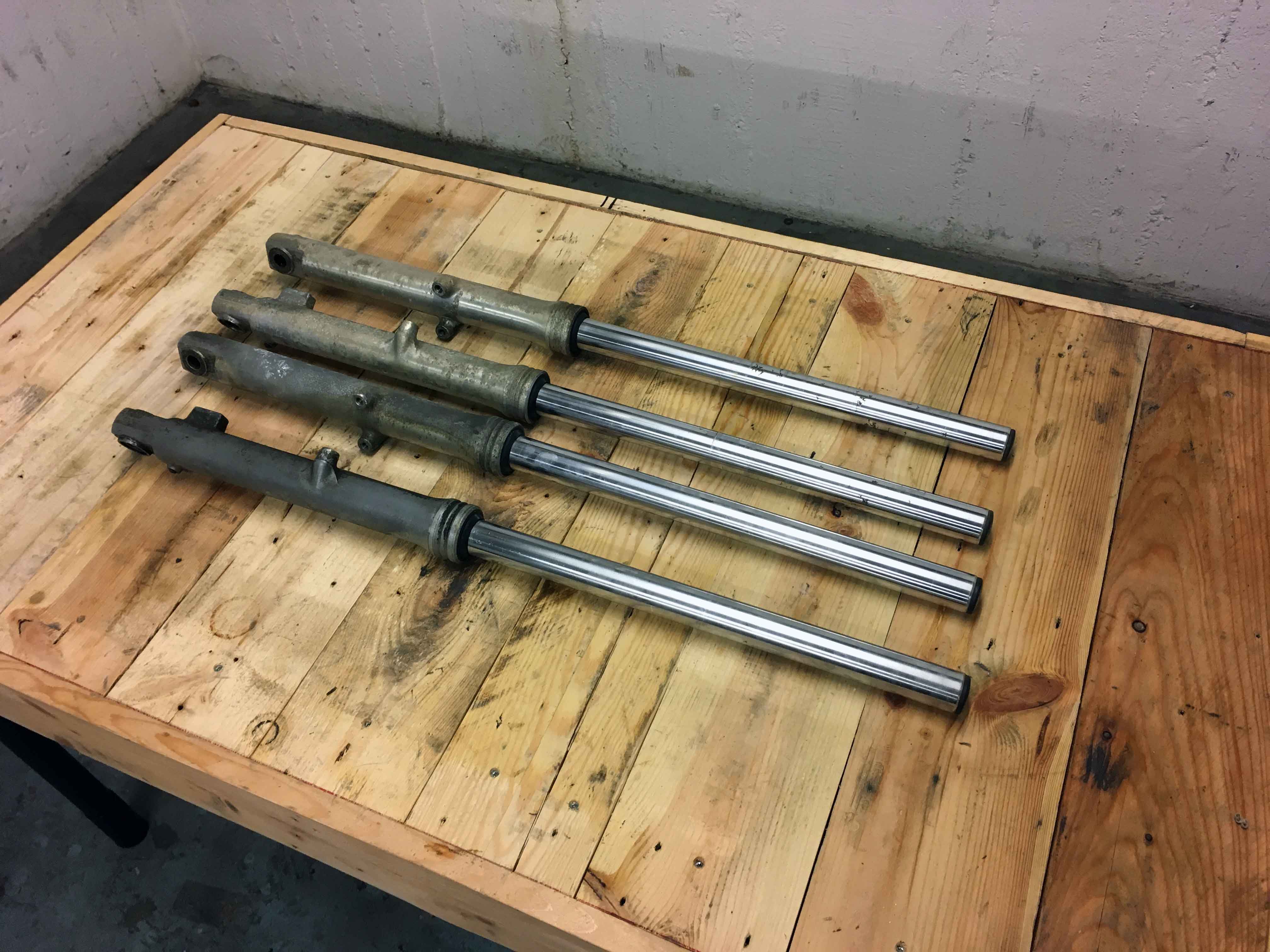

I also got that package from Australia. Most relevant to this project are the forks... Which I can begin dissecting and experimenting with ;D Yay!

I assume the Excel wheels are for the weight reduction program. If so, how much weight did you lose over OEM, and did you use the OEM size or go more narrow to reduce rolling resistance?
Exactly. I will weigh an entire wheel assembly - old and new and compare once complete. I expect weight savings to be 1-1.5kg for each wheel. Because yes, I will be running less tyre than stock as well. According to the rim size to tyre size charts, the stock SR rims are right on the edge of acceptable for the stock tyre sizes. So I actually went with wider rims and narrower tyres (matching optimal sizes according to the charts) - I guess this lets the tyre perform better, or at least as the manufacturer intended.

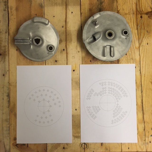

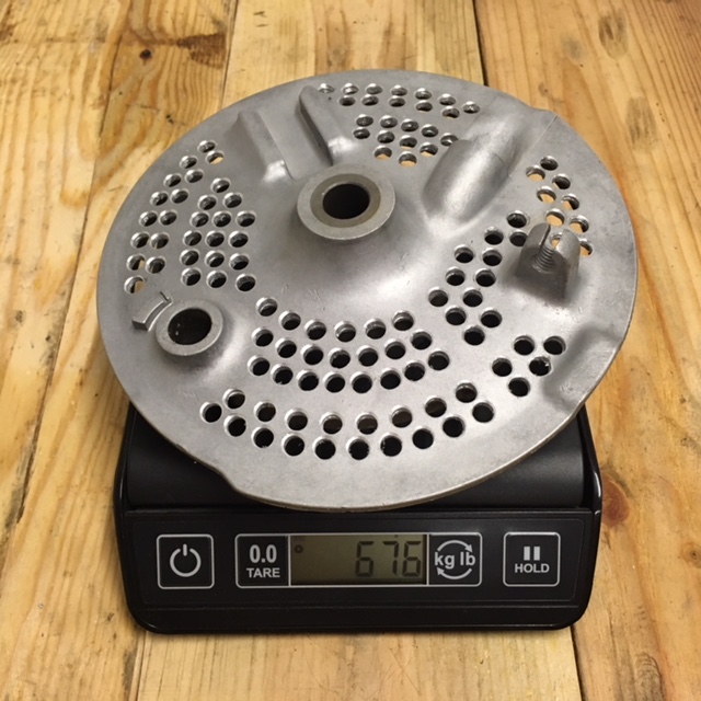

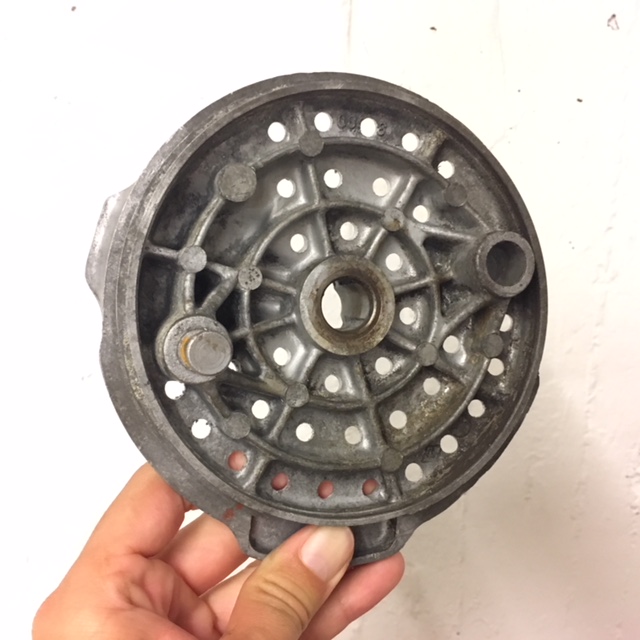

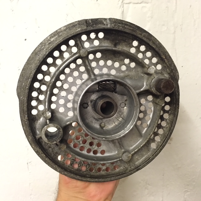

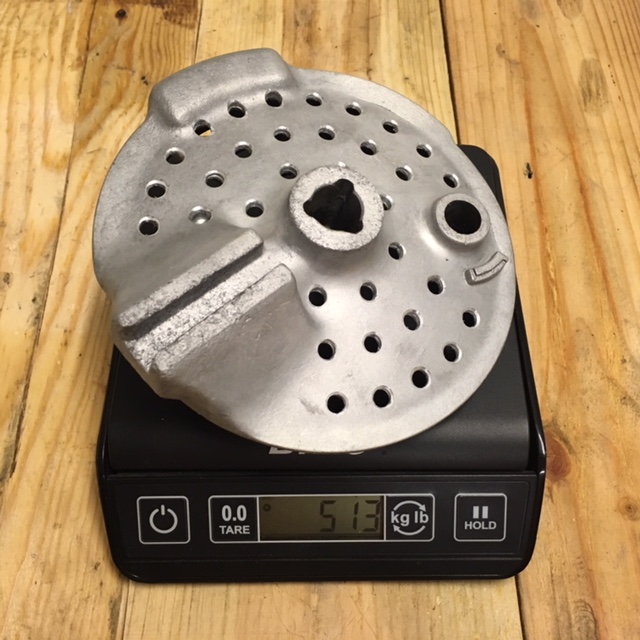

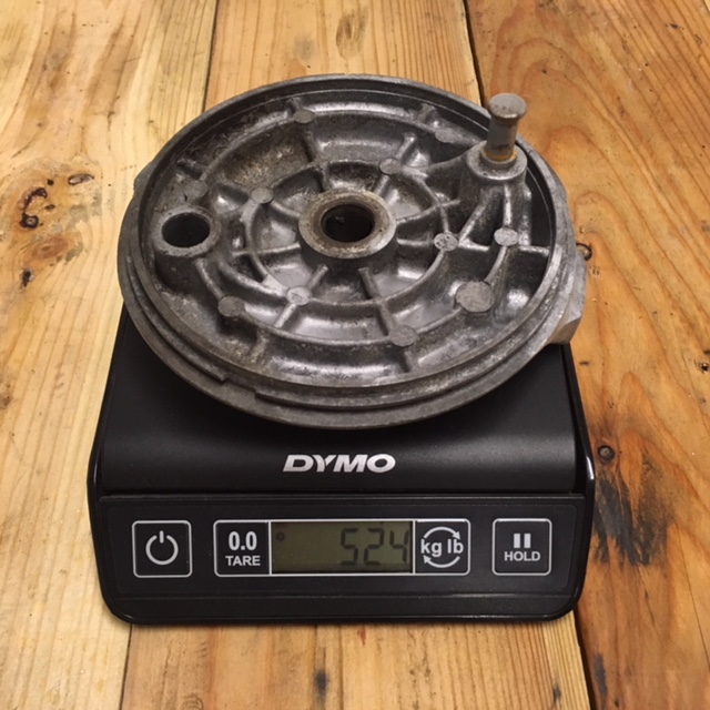

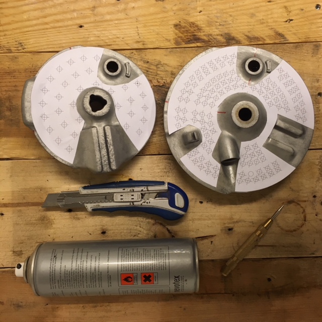

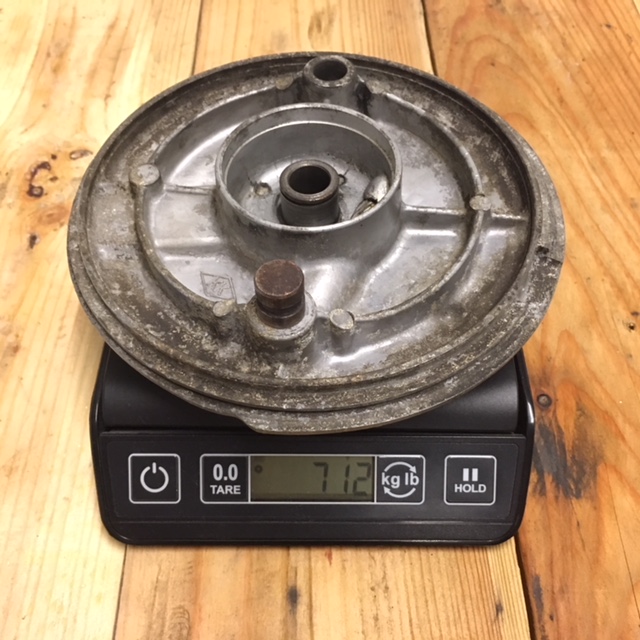

Anyway many years ago I created a meticulous drill template for the drum brake covers/drum lever holders that I used on a project that was never finished (my Dad will get the wheels from it though!). The template was created to allow the most drilled holes practical without messing with the structural integrity of the parts - missing all the cast details, bosses and ribs. Which meant it needed to be scanned front and back and a pattern laid out to suit.
The process was pretty simple but time consuming. Some might laugh at the effort but I think it looks cool and will give a special hand built touch to the bike. I must admit, it is mostly for looks, but I weighed the parts before and after just for a laugh - a 50g weight savings! Woohoo! Haha. Just gotta do that in 20 places and It'll be a kg savings total ;D
