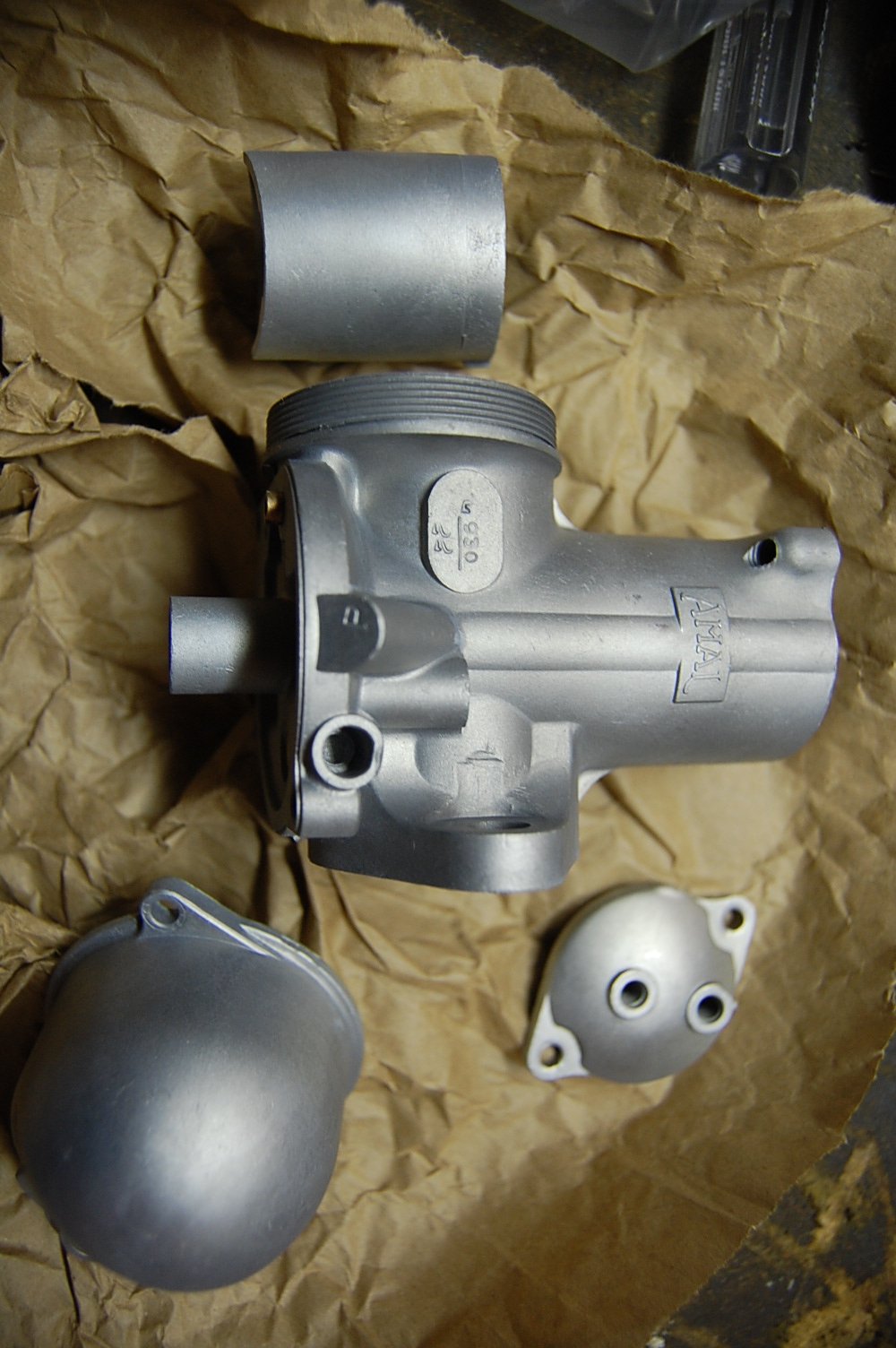

Took Swan's advice and pulled the hubs from the vapor blasting pile. I am going forward with drilling the front hub with cooling vents. I may just have them bead blasted later. It's free and the turnaround is instant. What I am most excited about is salvaging some 930 Amal carbs that he is cleaning for $20/ea. That is such a good deal! He sonic cleans and vapor blasts them. I have a 5 gal sonic cleaner and I am still using his service!

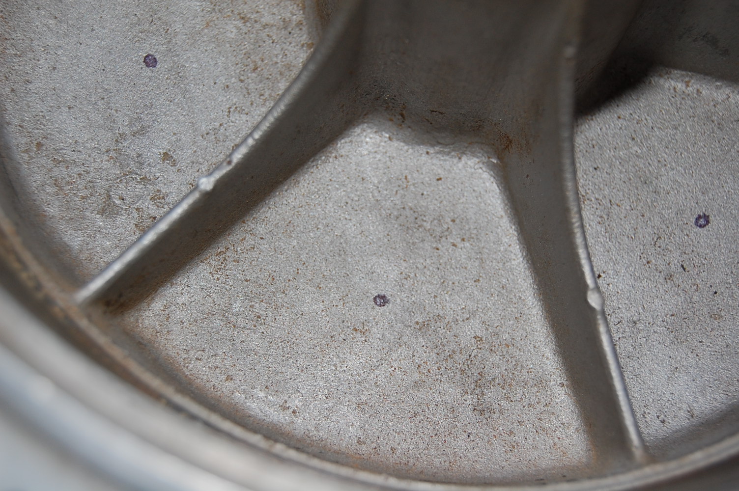

For better or worse. I carefully made a template for the hold marks. Seems easier to drill inside out. Just need to go slow so I do not damage the outside area around the hole. Now to decide a 1" hole or 1-1/4"??? Also considered 3 smaller holes with a pie pattern between each ribbing. I am leaning against this in favor of the 6 larger holes. I am also leaning toward JB Welding a screen to help keep the nasty stuff like rocks and small children.

Nicely done. I wish I had some more stuff to put speed holes in. Probably the funniest part of building, besides tear done and finishing. good job
Looks good. Are you going to polish the outer hub?

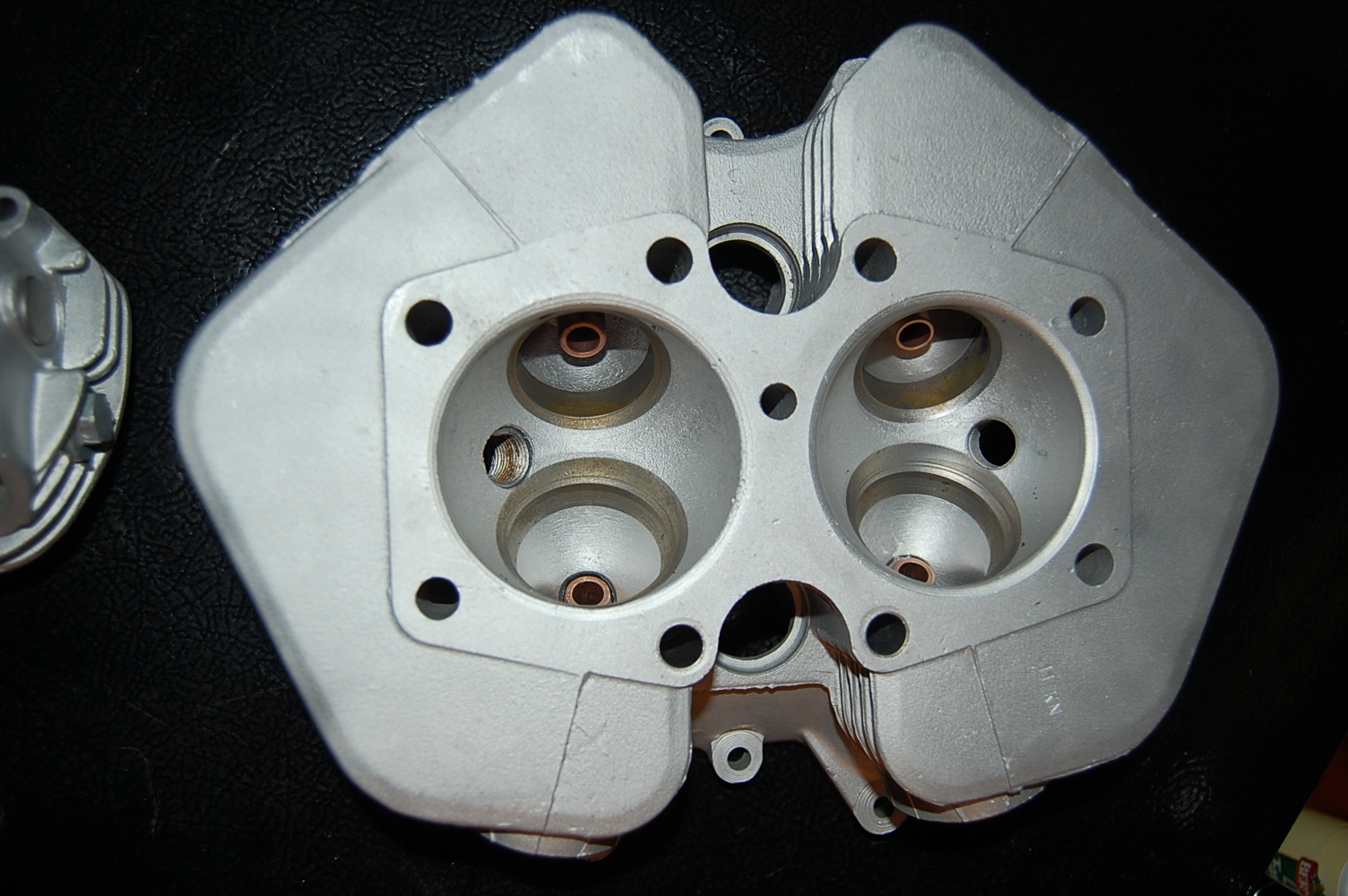

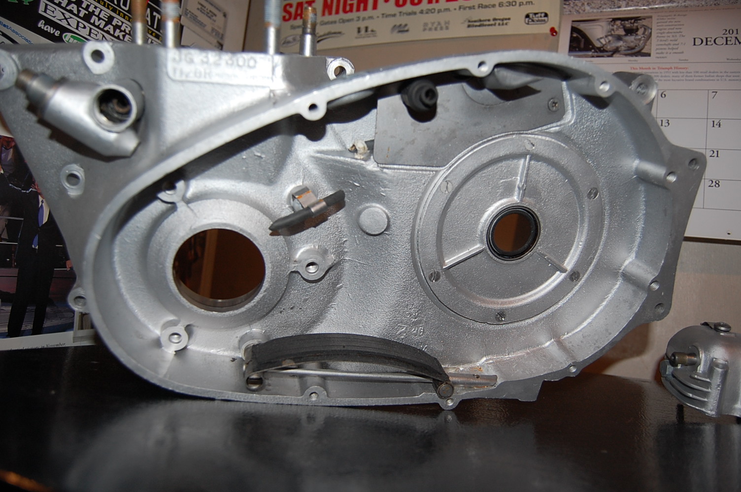

Picked up the cases from Bike-a-lot Vapor Blasting this week. Simply incredible. I don't think I will ever rebuild a motor without this service again. http://www.vaporblasting.biz/ Jeff was very good to work with and the work was done when he said he would be.

So are you going to paint the engine cases at all or leave them as-is? I have to find a vapour-blaster here in the Toronto area to do my engine parts before I assemble it. Even if I have to ship the cases to Oregon, I'm getting this done.
The cases are going to be built as is. I don't trust paint and polishing them would be a pain to keep clean. The hubs will be polished. I am power coating the frame black. Pretty standard issue Triton. Black and chrome never go out of style. I regret not vapor blasting before. I was always trying to save a nickel here or there and this was worth it. The carbs at $20 each is the best deal. Never noticed it till Jeff the vapor blaster pointed it out, the carb bowls don't have a drain plug. I assume they are aftermarket of some sort. Anyway, one less place to leak.

Do those parts need any coating/treating to protect them from oxidising after blasting. They look great
Well a little wd-40 never hurt anything. The cases are fine and should not have any oxidation issue. They said the finish should be a littltle more resistant to dirt. They are more resistant than walnut shell blasting which changes the finish of the metal. That is one of the selling points, vapor blasting does not change the metal finish. The carbs are a different story. The metal in Amal Carbs are legendary poor. They will oxidize.
