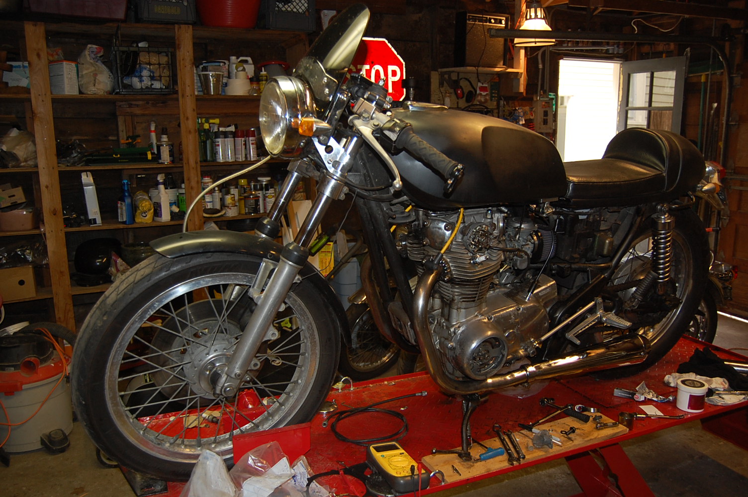

Fair enough. My work is seasonal and is sucking most of my time. I have made it to the garage 2-3 times in the last couple of months. When I have been working on bikes it has been spent on my XS650. Swapped a motor from a donor bike. For some reason I could not get it to fire. Frustrated the hell out of me. Finally a friend brought his over and we took his apart to copy everything. Fired right up. Not sure if we even changed anything. It seems like a good runner. Just in time for some nice weather. My garage attention is now back on the Triton.

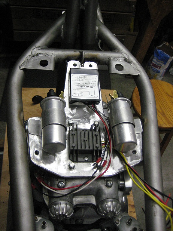

I am really happy with the way the head-steady turned out. Designed with lots of room to place electrical stuff like coils, boyer etc....see photo.
The wiring is about done except for a few loose ends like the amp meter.

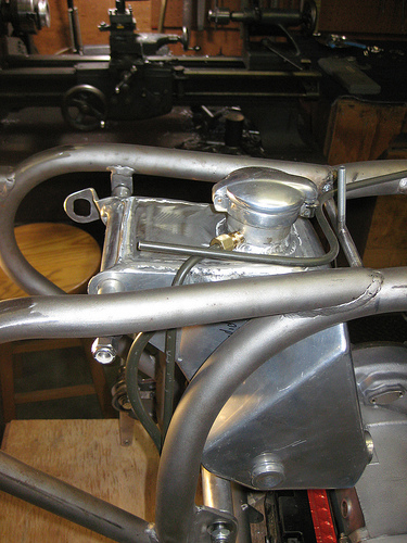

The central oil tank has been a mess. This was a eBay purchase a few years ago. The oil cap did not align with the seat opening. Cut the top off and re-positioned the cap and had someone re-weld the top. I purchased the wrong oil line out fitting. For some reason I purchased a Triumph when a Norton fitting was required. Once I had the Norton fitting I discovered the threads were distorted when it was welded in place. This will get re-tapped this week.

Looks awesome - I know it's early but I thought I'd mention when I put my Boyer module and the regulator/rectifier on my bike I used some thin closed cell foam under each of them to reduce the vibrations they endure.

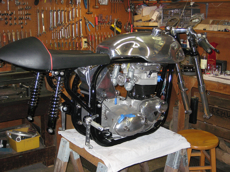

Back from paint. Final build over the next few weeks. We are at that point like a TV show, they just start hanging parts on the frame and everything fits! All the hard issues have been figured out and it looks easy at this point. Could not have made this kind of headway on this project with my buddy Rob. He is a truly talented man and deserves all the credit.
