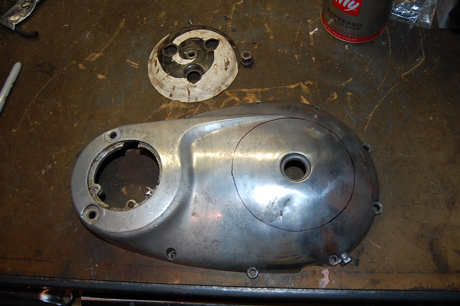

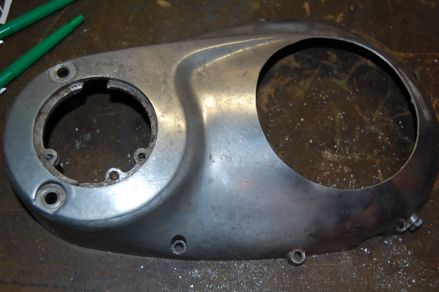

Started to cut up my primary cover for a belt drive application. Don't worry, the primary cover had damage that made it a good candidate for such things. The damage sort of limited the design I could use. This design exposes the clutch pressure plate. Still thinking about what I want to do in the front for more holes or design. For those wondering why? Exposing the primary creates airflow and helps the clutch run cooler. This system has a history of running hot with no airflow.

Looks good, nice cut. What belt drive system do you plan to use?
I always have liked the idea of primary cover opened up with a Manx triskelion design.
I really like the Manx Triskelion design as well. The damage on this one would not allow this design to be clean. The funny thing about the belt drive is it is generic. Does not seem to list a MFG anywhere. It is sometimes referred to as the UK model. Seems most of the websites in the UK stock this one. It uses the stock clutch. I am hoping this is not a issue. The Newberry is about twice the money but uses a upgraded clutch. Some of that $ is the clutch. I purchased mine about a year and a half ago. We will see....
