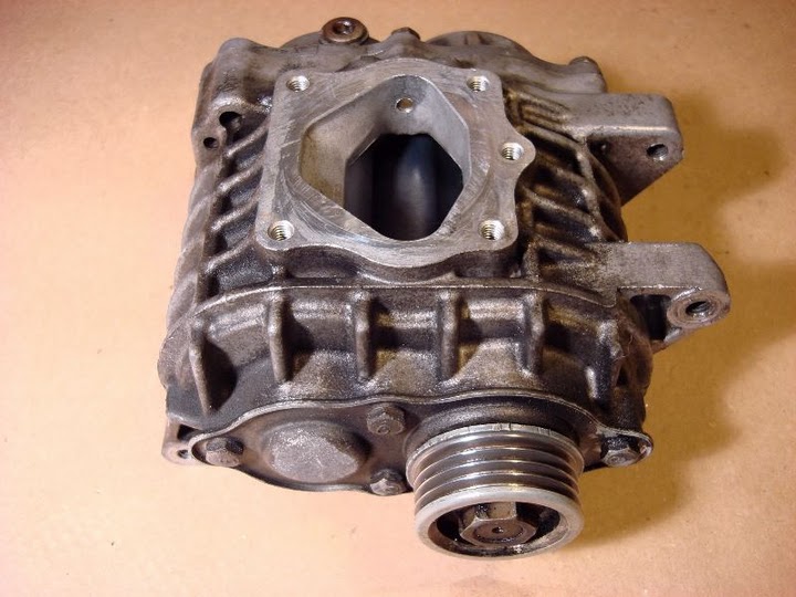

Well,Ive decided that Lois needs a bit more grunt ,so after a lot of research it seems that the next logical step would be to add a supercharger........
So,have been after a small Aisen [300cc displacement] unit off a Subaru Vivio & will add a 1.25" SU carb coupled via homebuilt manifolds & bracketry
Ive deemed that the belt drive will be off the motors flywheel/carb side as it would foul the exhaust.
But this will spin the blower backwards :o so it'll also need a pair of meshing cogs above the belt.
Im aiming for a modest 5 to 8 psi boost,this project is all about excellant usable low end & mid range torque, not a screaming top end rush
Should look suitably complex & will be a challenge to fabricate
Also needed will be a suitably sized plenum ,a belt tensioner & a pop off valve to help protect the s/c from backfires
The main hurdle will be getting the jetting right
I'm disappointed Dave. I thought you'd be making one from scratch ;D
Seriously, I'm not at all surprised you've decided on something like this. Here we go again ;)
