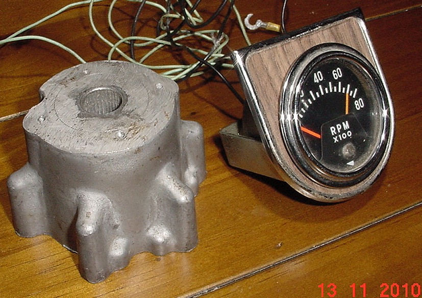

Lois NEEDS a rev counter & mounting ,so had a hunt round & came up with a nice alloy car steering wheel hub & a black/chrome 8000 rpm electronic tacho, so,here we go once again with the assorted power tools & liberal application of elbowgrease......

Re: Triton/Norvin inspired homebuilt project
Each knobby bit is threaded underneath, so its mounted on top of the fairings dash area
I couldnt mount it IN the fairing cause the headlite bucket is way too close
