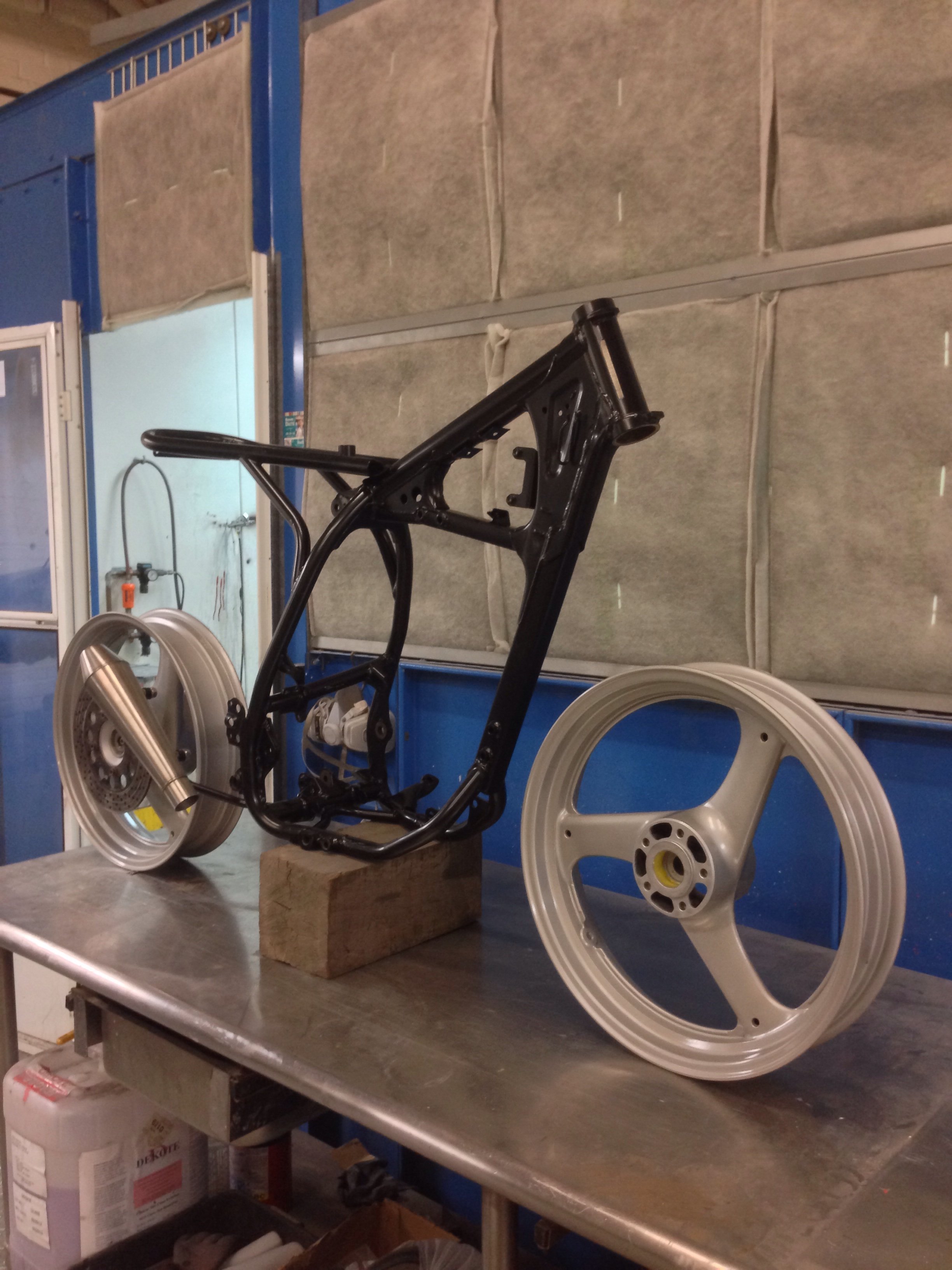

Thanks guys! Here are two quick shots. I got a hidden exhaust mount welded up. The frame came back from powdercoating today, and I got a chance to paint the wheels too.
Next week she should start going back together and I am going to wrap up a few little treats to sell as well.... Anyone want a front number plate led headlight that serves as a battery box?
