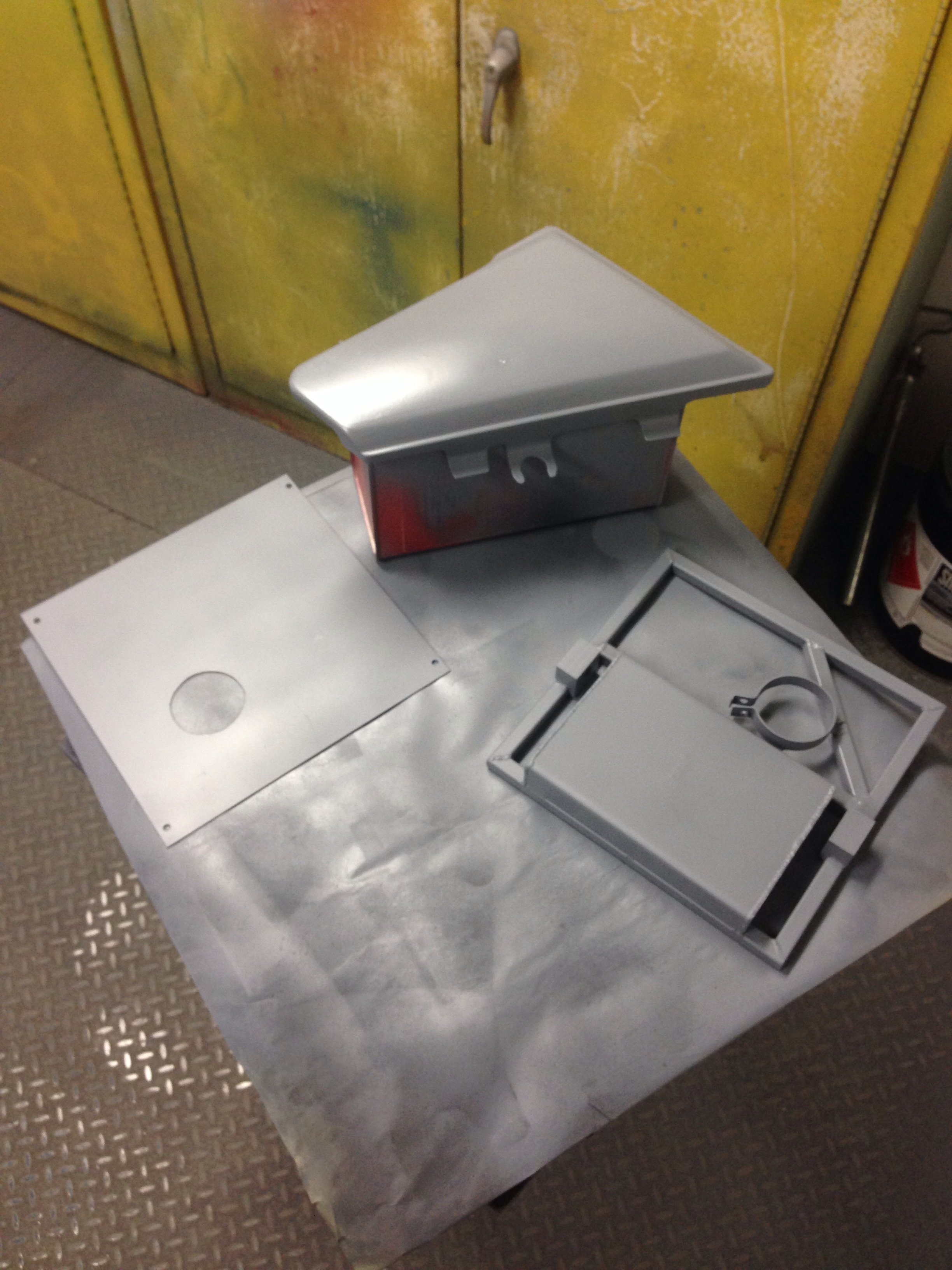

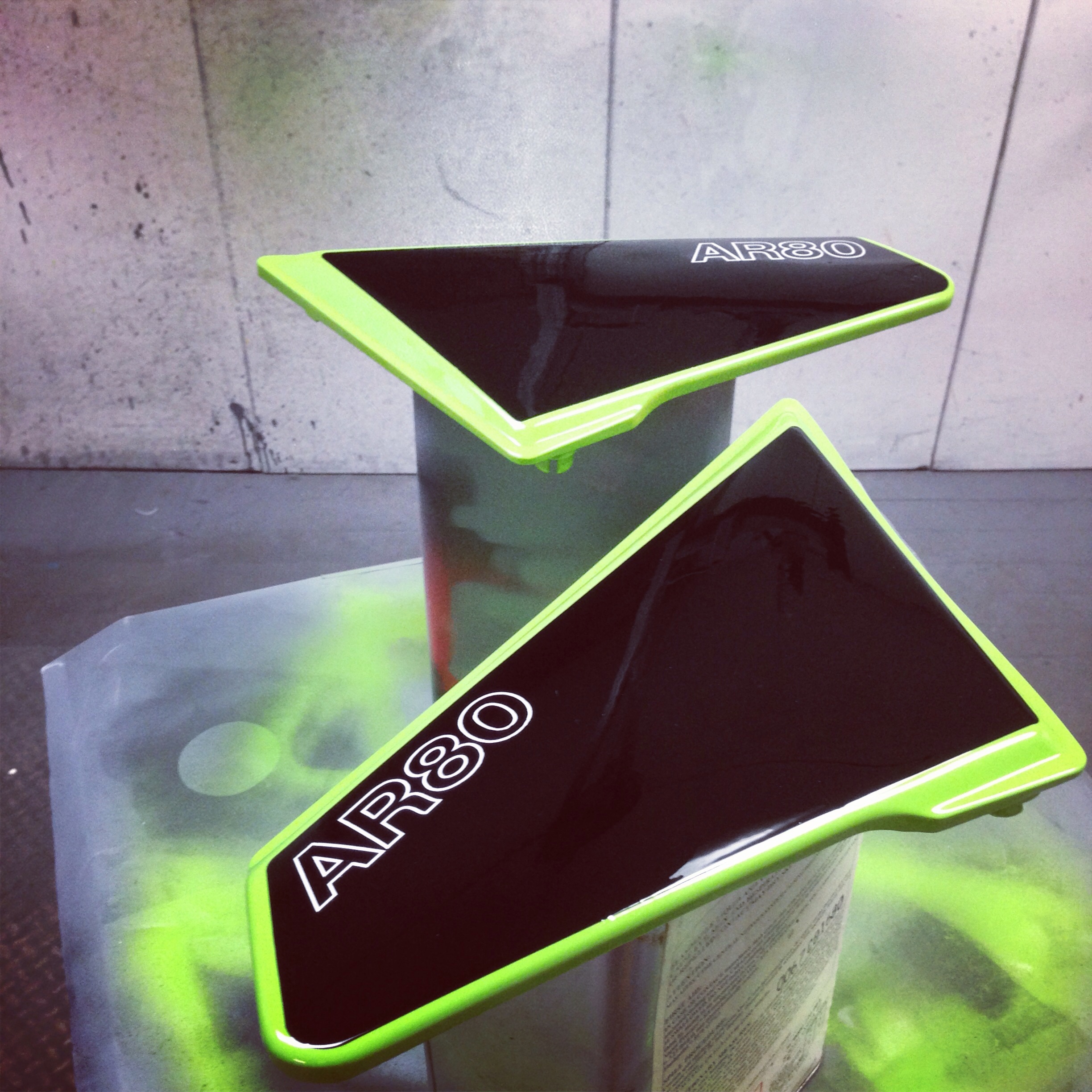

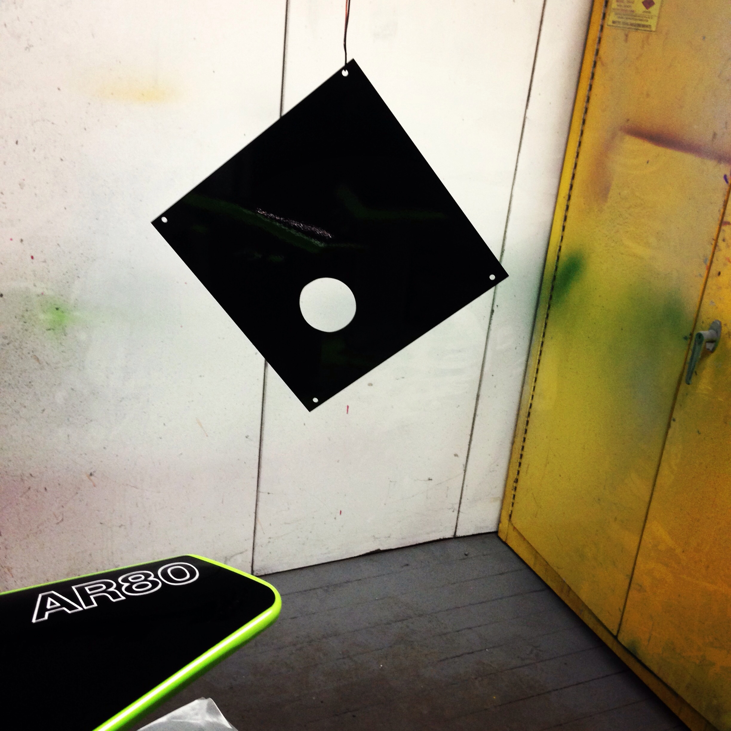

Progress is slow this week while I've been working on a customers ar80 resto. but there is some none the less. Finally got the battery box done primed and painted with the triples today. With any luck I'll be able to wire it next week and get started on the carb/custom exhaust.
