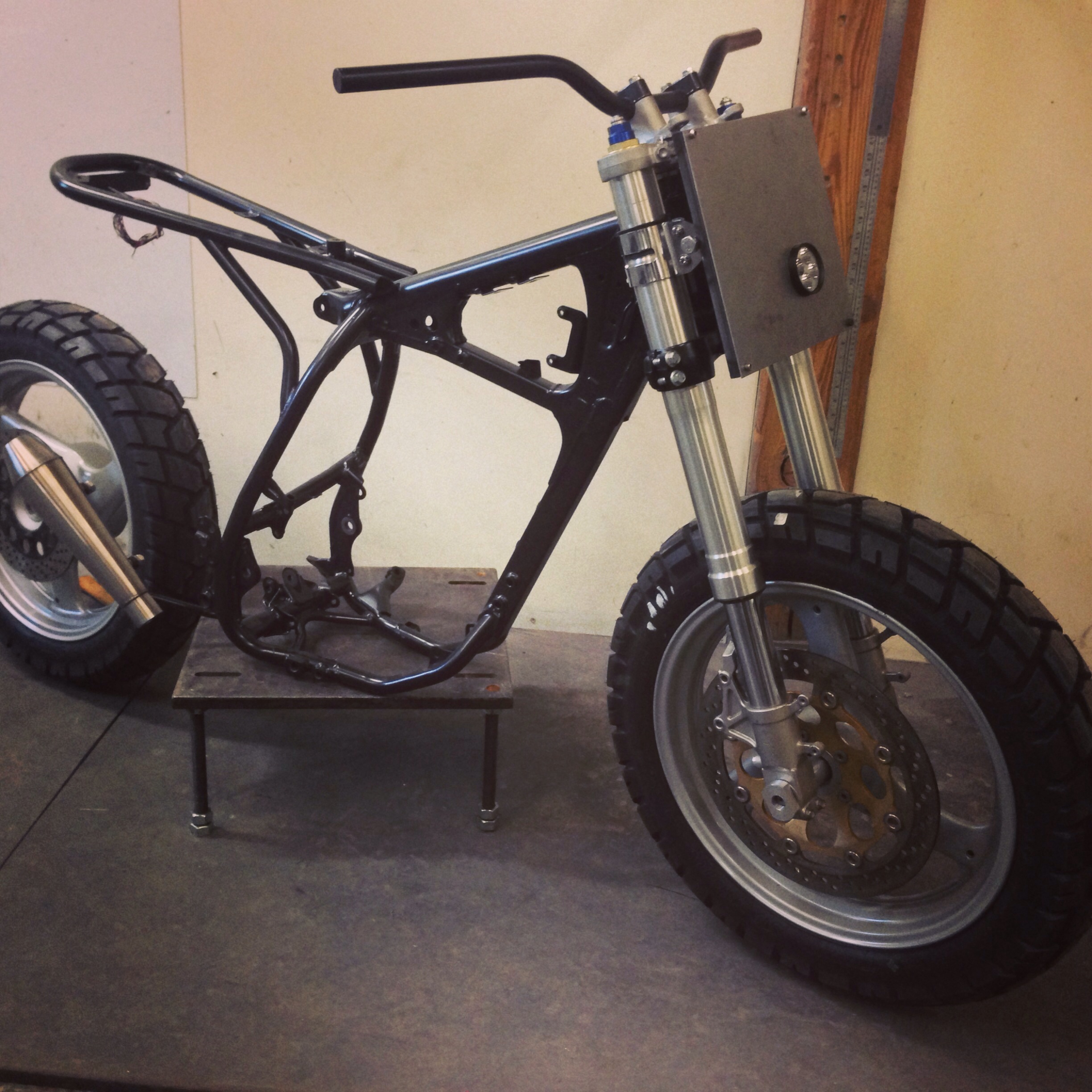

Got a bit more done today. I started the final chassis assembly and got the motor painted. Progress has been slow this week since I've been hammering out some customer bikes. Any way here's a few pics. and next week should bear more fruits.

This thing is seriously cool.
How are you going to angle the headlight so it is useful? Or is there adjustment room in there that I can't see?
Nick
Joe I've got 130/17 and 120/17's might switch the front out to a 130 do they match so it looks beefier.
Nick, number plate has two side mounts so it's rotates up and down like a traditional headlight.
Cool. I was planning on doing a similar raceplate / headlight too. I was going to hide some electronics behind it as well but I never considered the battery. Nice!

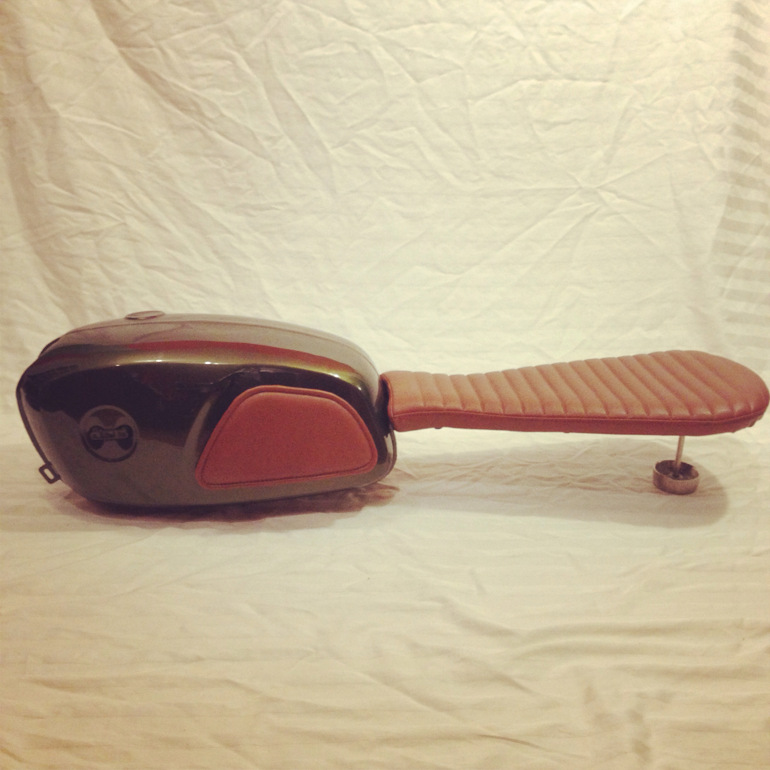

Quick progress I had to modify the rear swinger for the a 2 pot rear disk upgrade and got my seat and tank pads back from the upholstery shop today too.

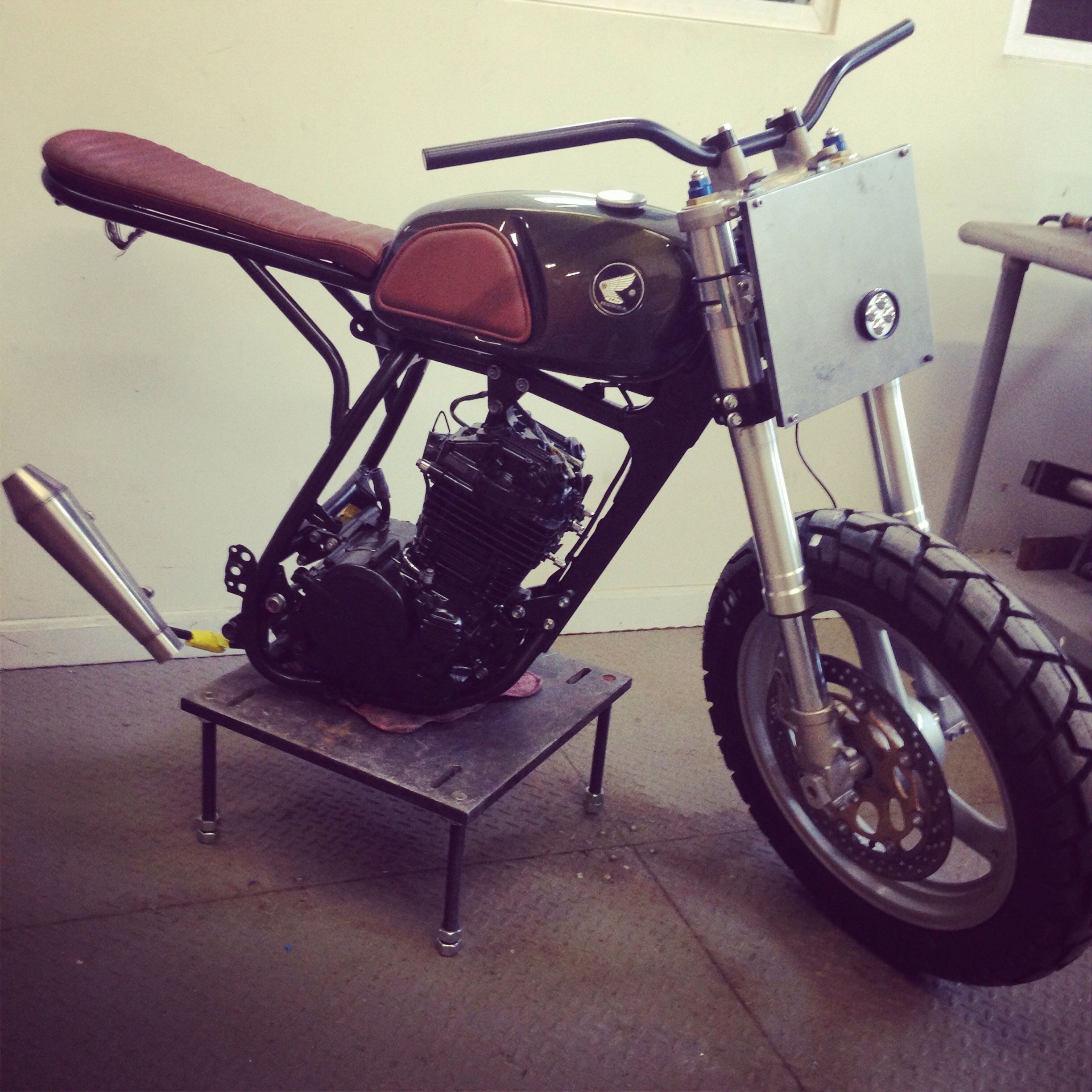

Not a serious update but I got the swinger finished and off to the powdercoater today. Here is a teaser shot of getting the tank and seat on for the first time, I'm getting really excited now.
