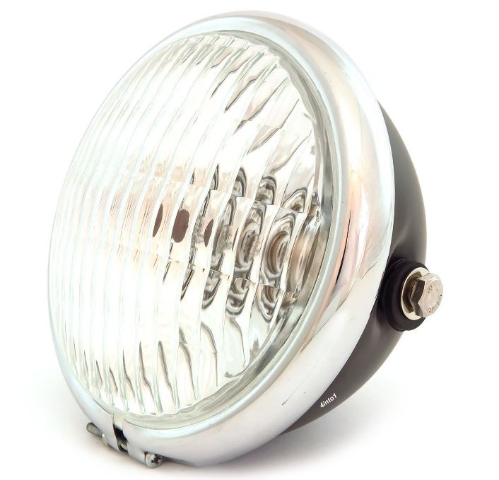

New head light is ordered which is 5.75" and I am planning on making up a setup similar to the 1978 IT400.

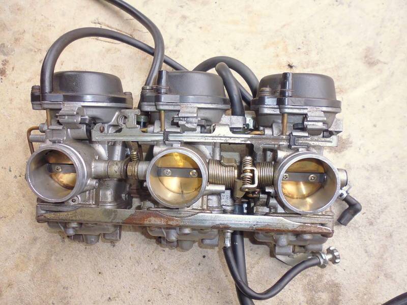

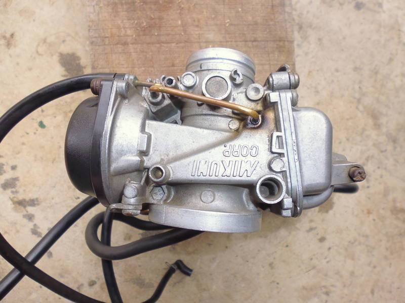

Happy days - picked up these off a Triumph 900 sprint. Cost $150 (100 Euro) delivered!!!!! Hope they go on the 896 without needing to re jet. Time will tell.
Question - when you polish alloy engine covers do you clear coat or leave them raw???

I never clearcoat. Dont like the finish... too bad they are mikunis and not keihin, i got my keihins near perfect on the 896
He was selling these as he had just got a set of Keihins to replace them!!! For the price I could not let them go, as they are more modern than the MkII's that I have. Thanks for your thoughts on clear coat.
Well, they work well on the sprint that delivers about 110hp, although water cooled so should be jetted leaner than an oil cooled at the same hp figures, so might just be very close!
You are lucky.
I'm running exactly these carbs on my stock xs 750.
I will have a look at which jets i'm running.
I however changed all ORings (especially under the needle seat),there is a british firm that sells Oring kits for them.
They are great carbs and perform really well.
As for the alloy,I never clear coat (it will not hold up for very long,as its also slowly corroding),just wipe it down now and then with a rag and wd40...

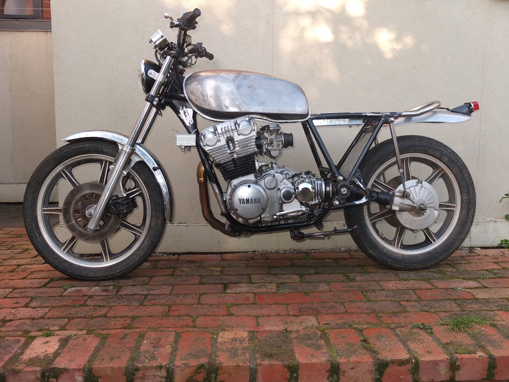

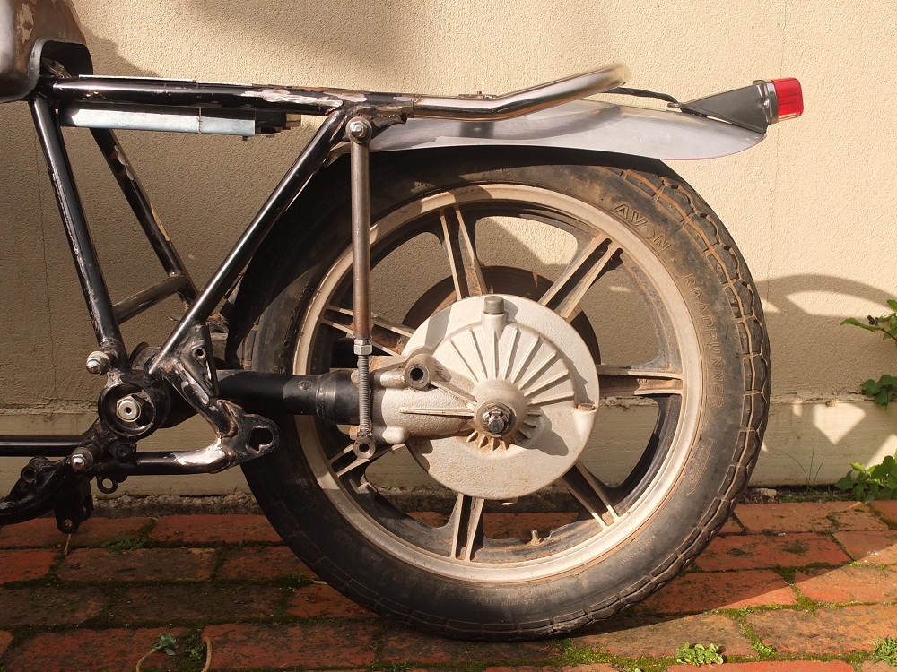

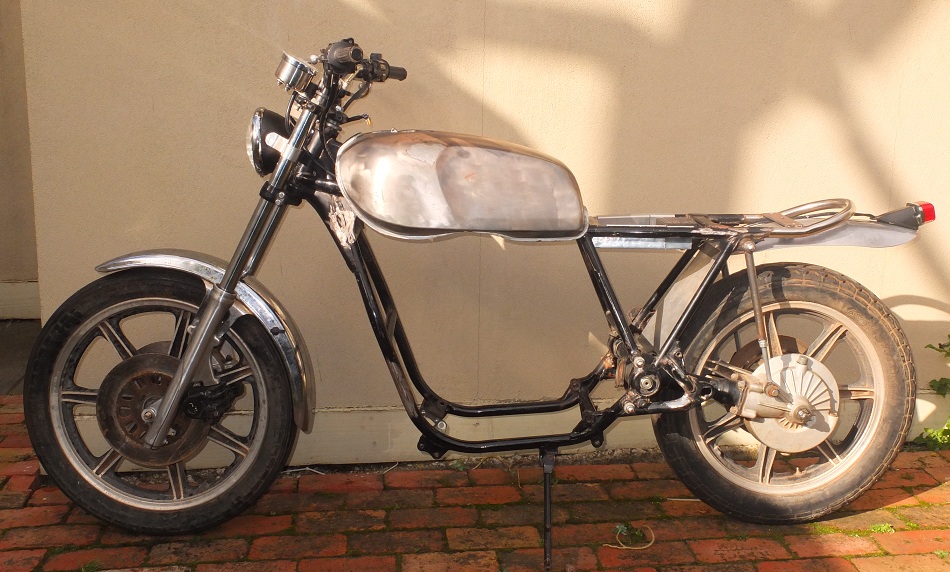

I fitted 2 different fenders for a look today. The first is mounted high and is from a Yamaha IT200, the second is mounted low and is from an XS750.
My preference is the low mounted XS750. What do you think??

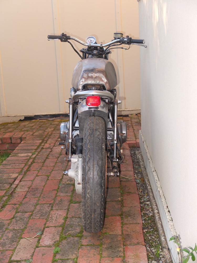

Front view with the XS750 fender. Happy with the new headlight and having the speedo out there. Might put a flyscreen on, but we will see.
Pat questioned what would happen when the rear suspension bottomed out. It pretty much hits the top and the front simultaneously, so I guess that's OK?

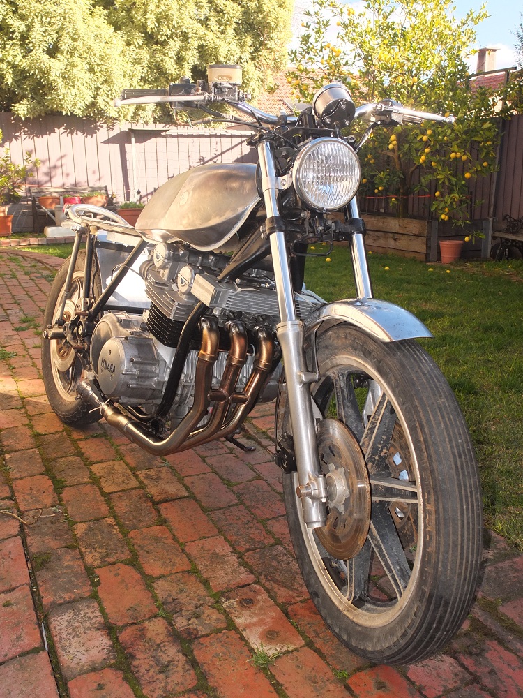

Engine is in, but all is not perfect. Broke the last compression ring when assembling. Only one person to blame http://www.dotheton.com/forum/Smileys/default/cry.gif
The engine was always going to come out, but now it needs some work. Other than the ring, it has all gone together well and I am happy with the header and oil cooler. With the oil cooler squish plate the oil cleaner housing are level with exhaust and engine mounts. Looks like I will be able to change the oil filter without demounting the header.
The looks like the exhaust will all go together well, the muffler will go back a little further so the end is level with the axel. Now need to cut the flanges off the header and fit and weld the ones that I have made.

Luugo86 said:
Welds on that exhaust look great. Did you do them yourself?
The header is off a Triumph 1050 and is yet to be modified to connect to the Yamaha head. The Triumph pitch is correct but the inlets are cast and an oval shape which cannot connect. I have made up some new header tubes for the interface, now just have to cut and shut. I do not TIG weld, but have a friend at work who is very capable. Might cost me a beer or two. ;D
