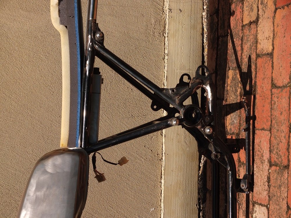

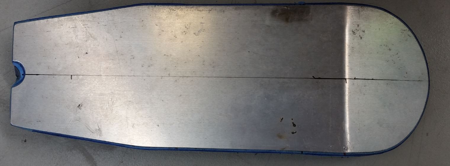

Managed to get a bit more done. Made up the seat pan out of 4mm 5083 ally, would have preferred 2.5, but I had 4.0 not 2.5, might have to mill a few slots to lighten it a bit. I am going to try and come up with a clip in seat, using the slotted grommets that are used to hold the standard side covers.
Also having second thoughts on the white foam as it is just collapsing (as intended) but the single layer (20mm) of the high density (grey) foam is bottoming out too much >:(. Think it will end up with just 2 layers of grey. :D

Nice work, I am building an XS750 sidecar (almost done with the engineering side to be honest), but I really have to build a different seat, so I shall follow your build closely as I want to do something a lot more classic, like the one on a SR500/XS650.
Oh and I might have to look for an English wheel as you make that look way too easy.

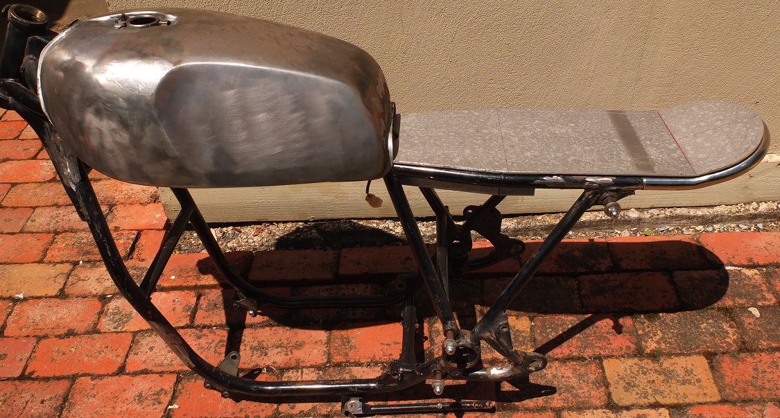

Little bit more work on the seat. Changed the top layer to the harder grey foam and then cut the wedge out of the pillion area to follow the upturn on the frame loop. Next it is off to work for skiving the foam to the final profile and making the trim cover.

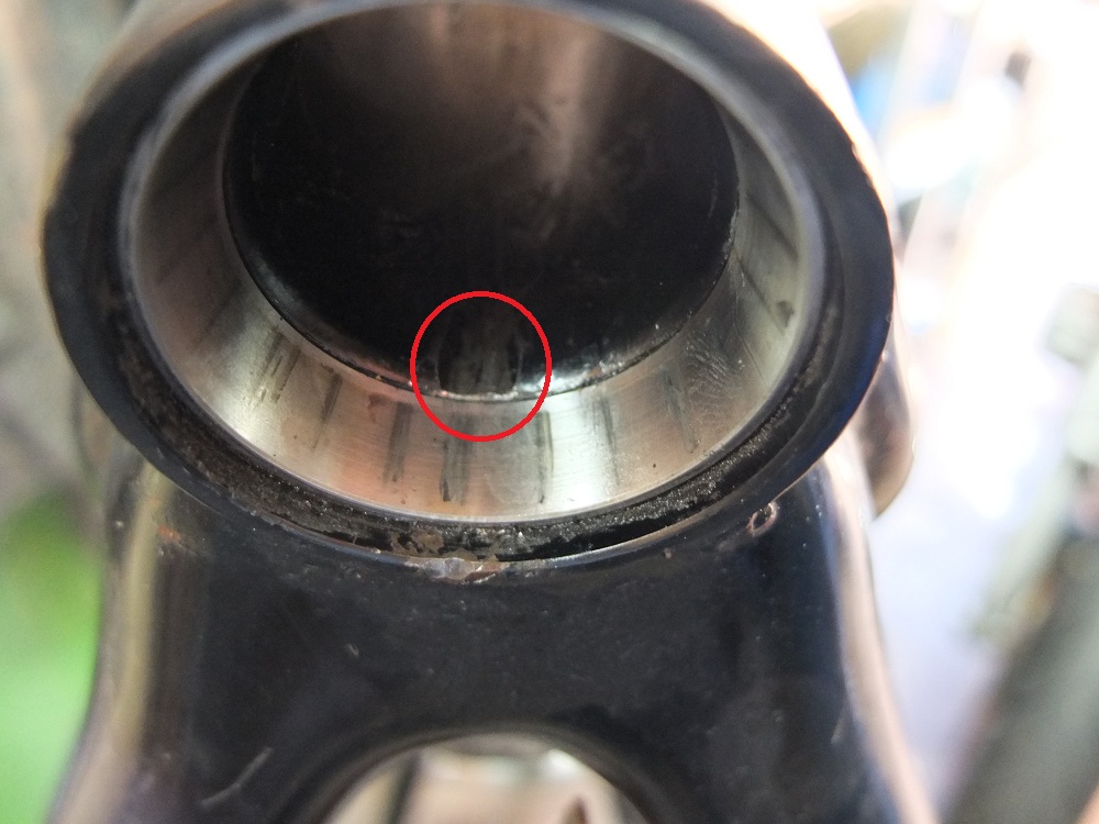

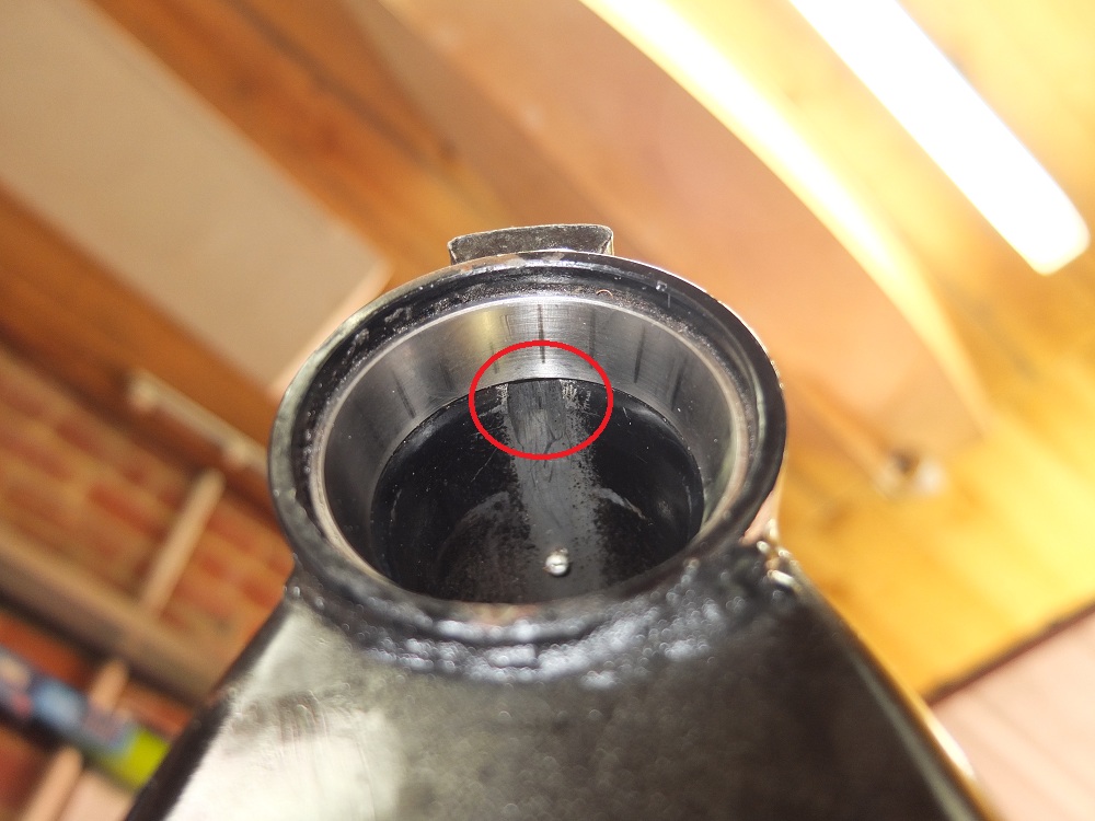

Had a bit of time today when I was getting the boat ready to go fishing tomorrow. The steering head bearings need replacing as they are rusted and pitted. The top one came out without trouble. The bottom one is being difficult. The issue is that I cannot get to the lip on the lower outer race to drive it out!!!! There are 2 groves, front and rear that are meant to expose the lip so you can drive it out, but even with the groves the lip is not exposed enough to get a drift onto it. Heat was no real help - did not get it hot enough to burn paint though.
Any one got any special tricks that I could try?
Thanks
Tim

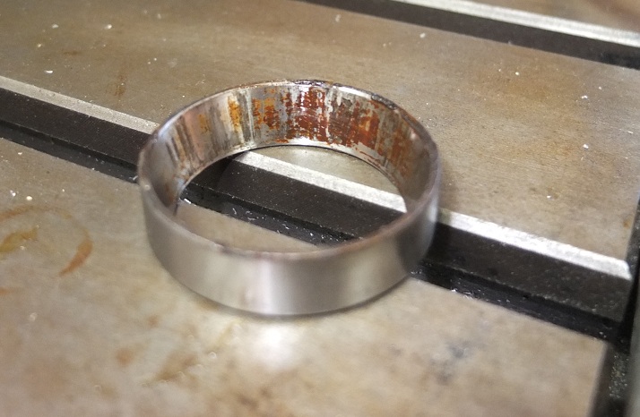

der_nanno said:
Make two or three tack-welds. That will distort the bearing cup sufficiently so it'll fall out under its own weight.
+1 this method works great.
+1 on the welding distortion plan. Alternatively, you can take a Dremel or die grinder and a small cut off wheel and enlarge the two recesses originally intended to make a spot to use a drift to remove the original much wider race. Then you can just tap the race out. Depends on the gear you have on hand as both ways work well. However, in the long haul, having the enlarged recesses will prevent frustration on the next bearing replacement.
Thanks Gents
2 large tack welds and then a bit of a tap (did not wait for it to cool down - patience is not one of my virtues) and out it came. The larger welds gave me a spot to get the drift onto and a very small tap and bing it was on the floor.
Thanks
Tim
