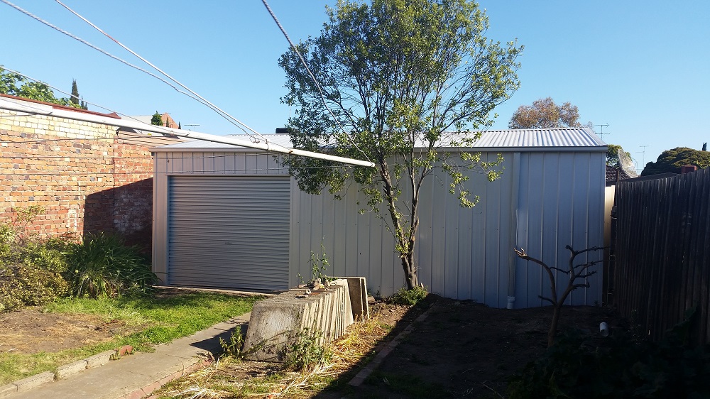

Shed is finally finished, but I do need to organise it inside with some shelving.

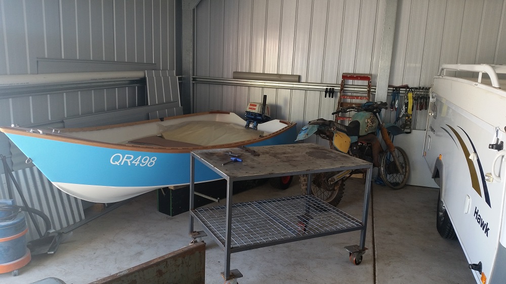

Moved some items in.
IT200N which is the next project/restoration
13' Tango skiff which was an earlier project.
And I have just picked up a welding table/trolley, which I am sure will come in handy!! ;D

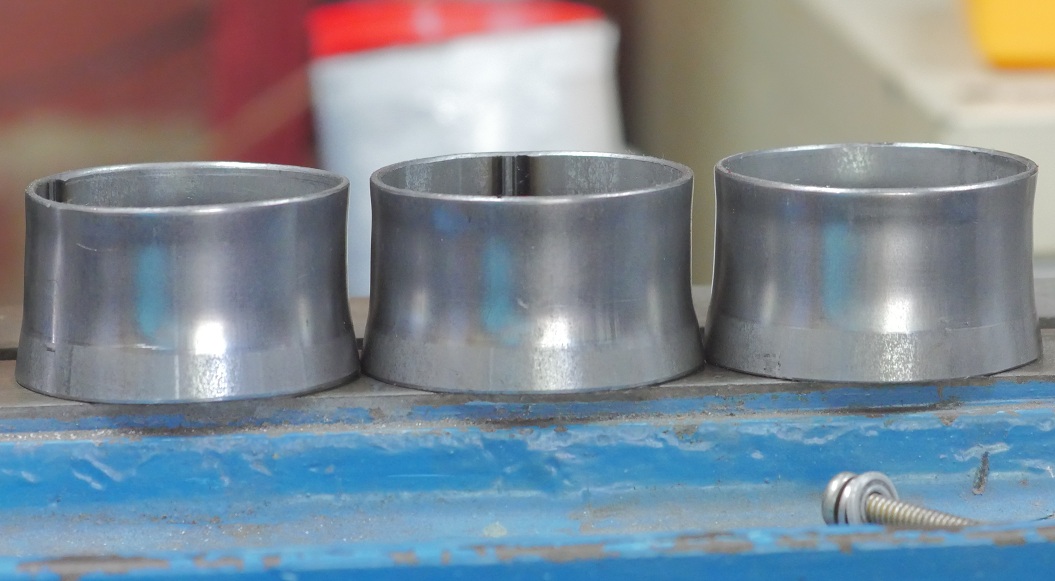

The triumph flat slide Mikuni's have a OD @ 60mm inlet and standard tube is OD63mm. The 2 options are to slit the tube and reweld to 60mm or swage the tube down to 60mm and get a nice flare to weld into the airbox. I have a 20 tonne bottle press and some chrome moly bore pipe to make the swage tool.
The ID for the swage tool was turned to 60mm and the tube came out at 59.4mm so I am going to open up the tool to 60.50mm and see how it goes.

I chose not to print and steal will be infinitely more durable, plus I can use tubes with a much much thinner wall, so more air can get through. I opened up my swage tool to 60.5mm and the tubes came out very well.

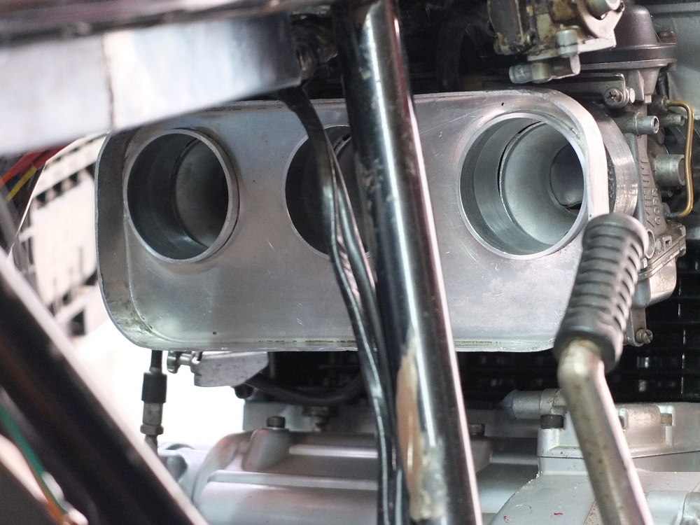

Found some 60mm OD ally tube in my material stack. I had a 60mm OD hole saw, that does cut a little over size. The plan being to make up the filter tray out of 1.8mm sheet formed around MDF forming plates with a fare amount of hammer time. Needed to anneal the corners once.
The tubes were cut to length and then bored out to 55.5mm ID and the a small groove cut into the OD to engage with the filter tray. To assemble. I modified my swage tool to expand the ally tube and rivet them into the tray. No welding required and tubes are rock solid.

May I ask you how you made the "tray" with the three holes for the air filter element?
Looks really nice,like a dye press or something,no welds...
Thanks!
Yes - guess the photos don't show the actual process. Doh!!!
In the photos you can see that I cut the blank out of aluminium sheet with a 20mm perimeter, and clamped it between 2 medium density fibre (19mm MDF) board former patterns. Probably should have annealed the corners first to make the forming easier, but you live and learn!!
Then I clamped the formers and sheet in my 8" vice and used a nylon hammer to start beating the perimeter over onto the former. Moving the part in the vice as needed. The straight sides form easily and can be done without annealing. In the corners there is an excess of material that needs to thicken up and grow out if the corners are going to be smooth. The MDF is a bit too soft to really bash out the corner. So I removed the ally tray from the formers - annealed the corners with a propane torch - and then used some solid 63mm steal round as a former in the vice and a steal hammer to finish the corners.
When the flange is fully formed the flange edge is far from flat due to the corners growing, so I clamped it onto the mill table and cleaned it up to a flat surface.
Final process was to cut the 60mm holes for the carbi inlets. The 3 holes used to clamp the MDF formers together, were at the correct spacing so those holes were used to guide the hole saw in the mill.
All in, including making the former patterns there was about 2hrs work in making the tray and probably 5 hrs for the whole air cleaner as you see it.
The MDF former pattern is pretty much stuffed now, with a steal former pattern it would be much easier and quicker to form the aluminium, but much more work to make the patterns.
Definitely no welds.
