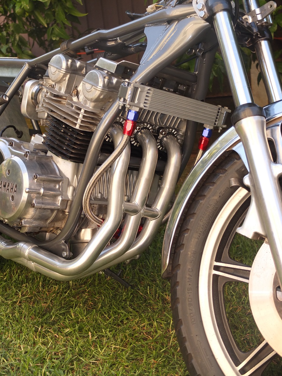

Headers arrived today (Courier drop off Sunday!) opened the box - not my headers, doh! >:(
I have gone with silver ceramic coating, same as the ones in the photo, https://www.jet-hot.com/.
Trust it will be sorted out tomorrow.
Getting there, everything is here, hope to make some noise tomorrow.

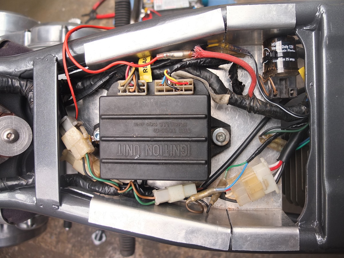

Would it be possibly that you post some pics how you dealt with the electrics on the bike (ignition box, relays etc.) thank you!
Planning to clean it up a bit more this weekend - once done I will post some photos. They are hidden in nooks and crannies, wherever I could find a spot.
The best thing I have done is clean up the loom using proper automotive connectors with 6.3mm spade terminals. Photos of the main electrical items are attached. The fuse box is not really hidden as you do need access, and I did not want to have to remove the seat if I blew a fuse. Battery (now ordered) is under the starter solenoid.
