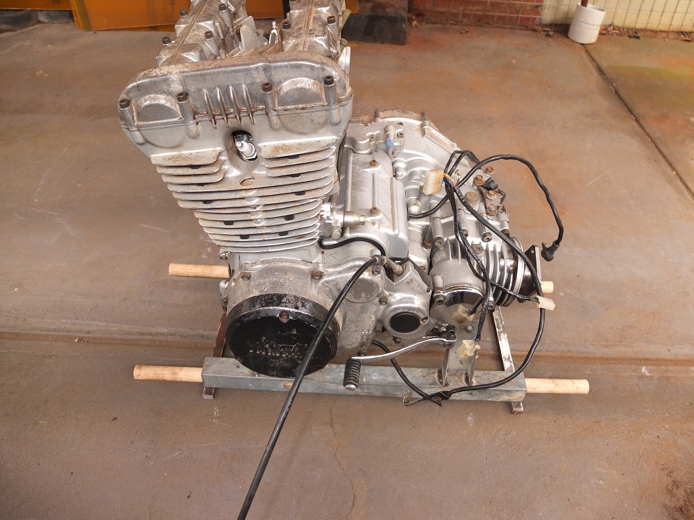

Productive day. Brought the engine back to my shed and stripped it down. As I said earlier the PO had started and thankfully lost interest, but he had left it open. The reason it would not turn over was due to the cam timing being completely out, causing a valve & piston clash :o. No damage done ;D. The crowns of the pistons had a layer of crud on them, but it had not gone beyond the compression ring. What is clear is that this engine has not done much work, if you look on the cylinder you can still see the original hone marks ;D ;D ;D.
It took about an hour to pull it down and four hours cleaning. The original owner had bought it for speedway and there was plenty of dirt built up on the outside to get off. I used a wire brush by hand so as no to ruin the silver engine paint. Not all perfect though as there was a thin layer of gunk in the bottom of the sump, and the carbies had some dusty build up in them. I guess the original owner did not have a great air cleaner for his speedway racing. The carbies must have blocked up before he did any internal damage to the engine.

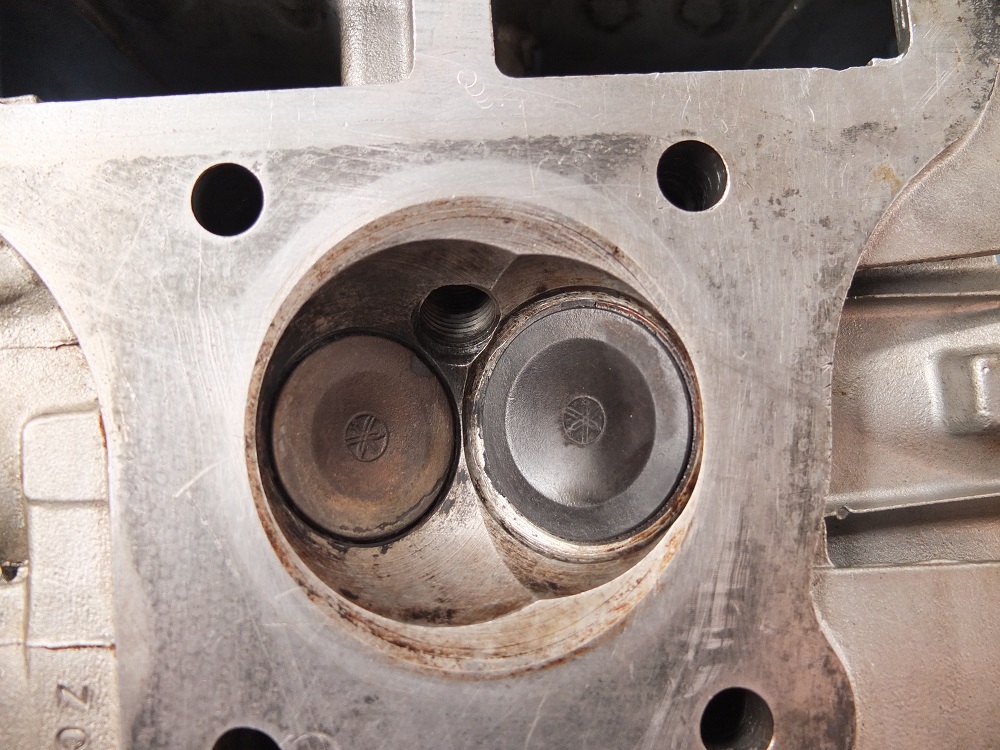

The head on this engine is definitely the high compression version. Have a look at the photo and you can see the complicated machining to create 2 dome areas. I could not save the base gasket off the 750 cylinders so I need to get another one before reassembly the 896 so I can lower the compression a little from the 11.4 calculated.
Quick video of Saturdays work https://www.youtube.com/watch?v=JkRFqIKB5ls
Photos of bits - the gudgeon pins in the pistons look like they have been hot especially the centre one.

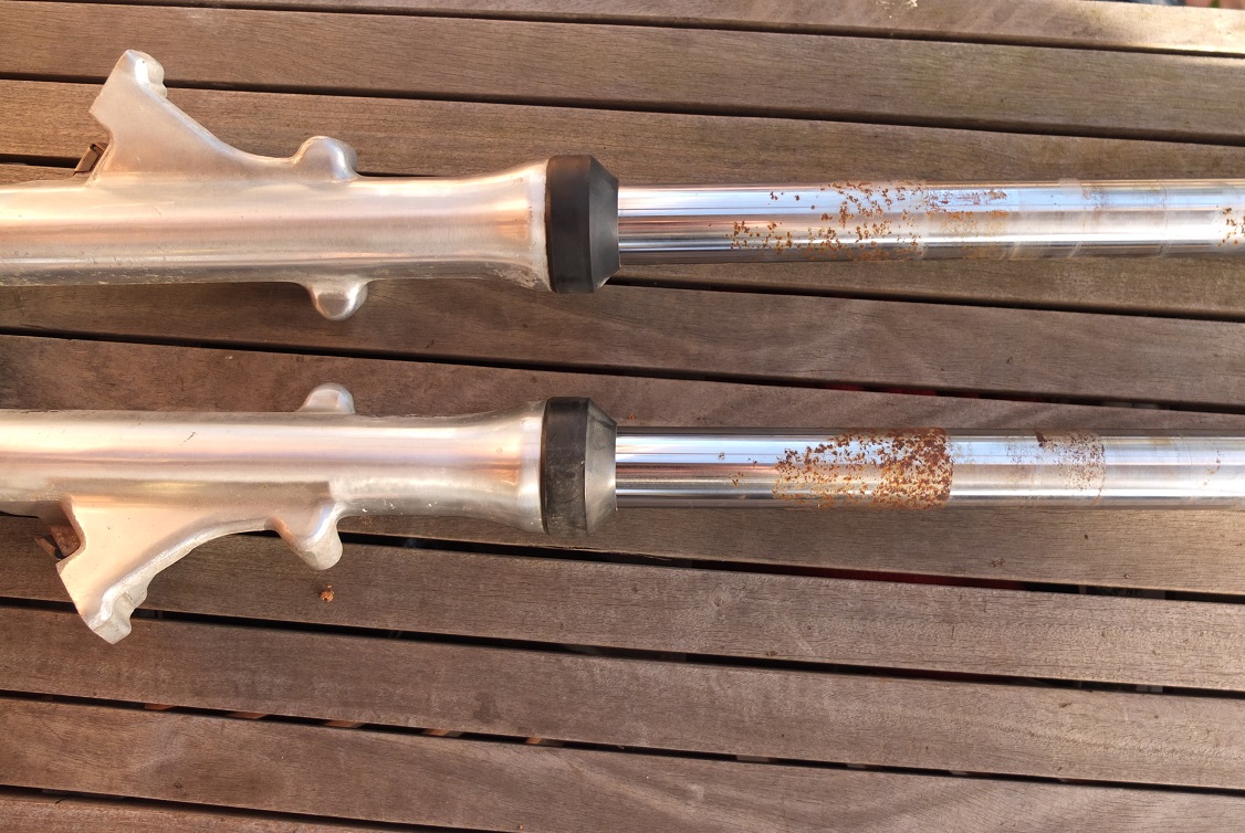

Had a few domestic jobs to do on Sunday, so progress was a bit limited.
Pulled the forks out, as the tubes need to be rechromed and then cleaned up the head and lapped the valves in, ready for reassembly.
Cheers Tim

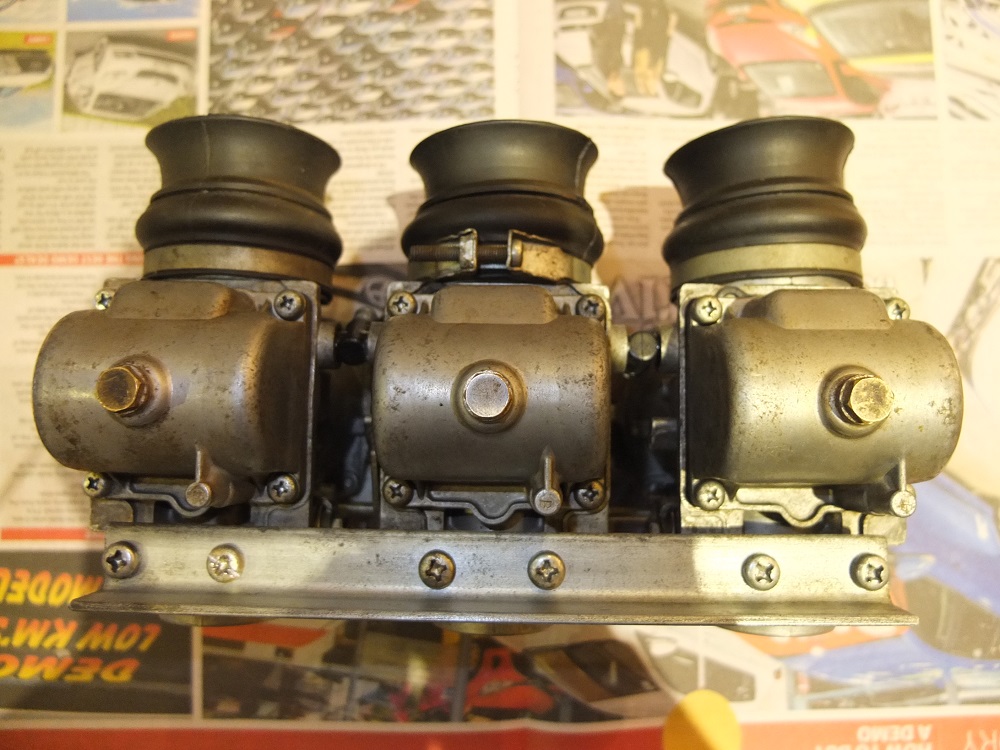

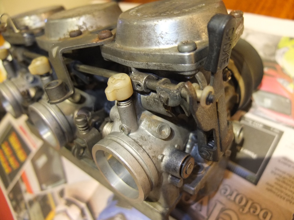

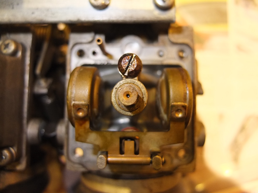

Pushed the boundaries with my beloved to night and rejetted the carbies on the kitchen table.
Standard XS750 is 130 mains and 42.5 pilots
My XS750 with pods and perforated baffles is running 140 mains and 45 pilots
For the XS896 I am starting with 165 mains and 47.5 pilots
You will see in the photos that the mains that were in the carbies were the tall hex type. That is the same type I bought in the new sizes, but after fitting them I am not sure that they are correct as they don't screw down fully. The last photo shows the standard round Mikuni jets (137.5 which is too small) but it screws down full. Suspect the PO bought the wrong jets.

I am pretty sure that those carbs use Large round main jets which have a different thread and are not sized the same way as large hex jets. What needle jets are in those carbs?
Thanks for the replies - yes they appear to be wrong. The 165s are bound to be the wrong final size so next time I will get the large round design. Interesting though I bought the tall hex jets from Mikuni OZ, so there must be Mikunis out there that use them!!!!

Most round slide (VM series carbs use Large Hex jets. Large hex jets are numbered to represent flow rates at 30cm of pressure IIRC. Large round jets are measured in mm of diameter, so a 150 is 1.5mm diameter.
In simple terms double the size of a hex jet from say 90 to 180 and it doubles the flow, but double the size of a round jet and flow increases by a factor of 4, so a 180 round flows 4 times as much as a 90 in a large round. There are tables on teh web that show a pretty close correlation for equivalent sized jets.

Thanks for the explanation on the jet sizing. It will be back to the round jets.
Thanks
Tim
