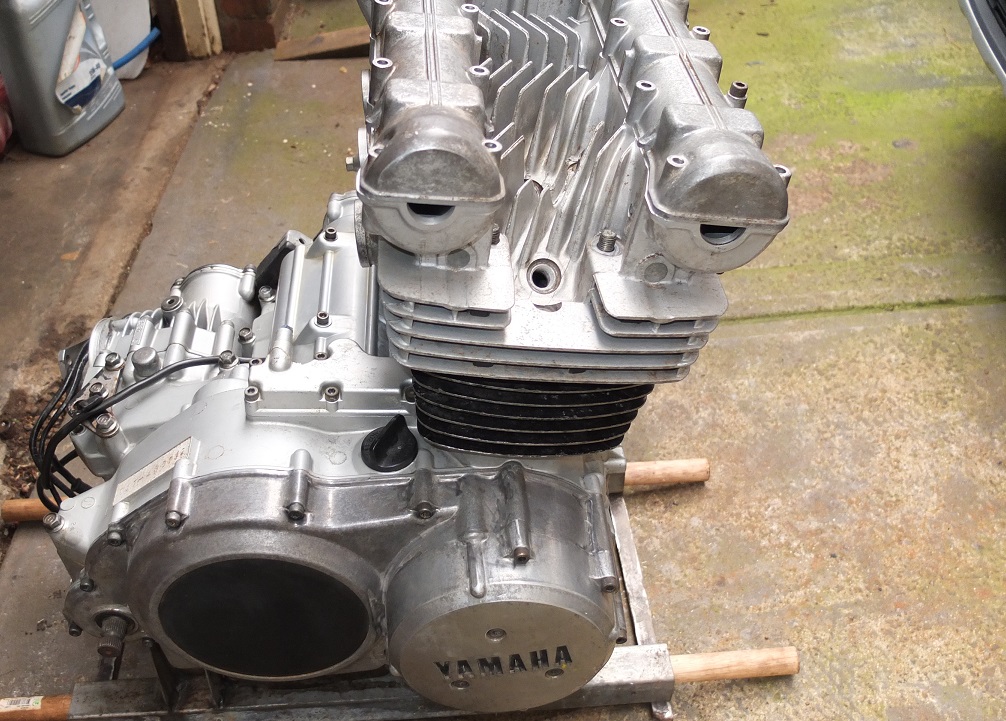

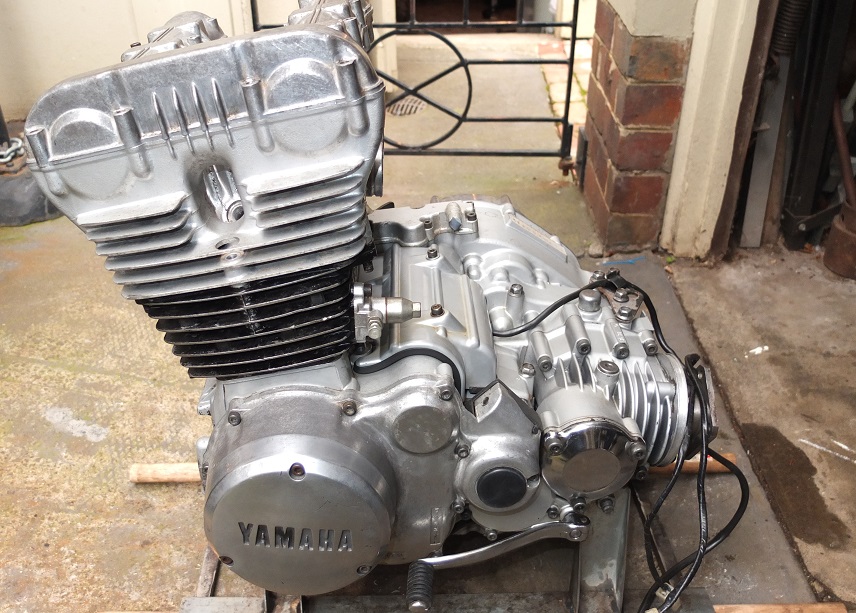

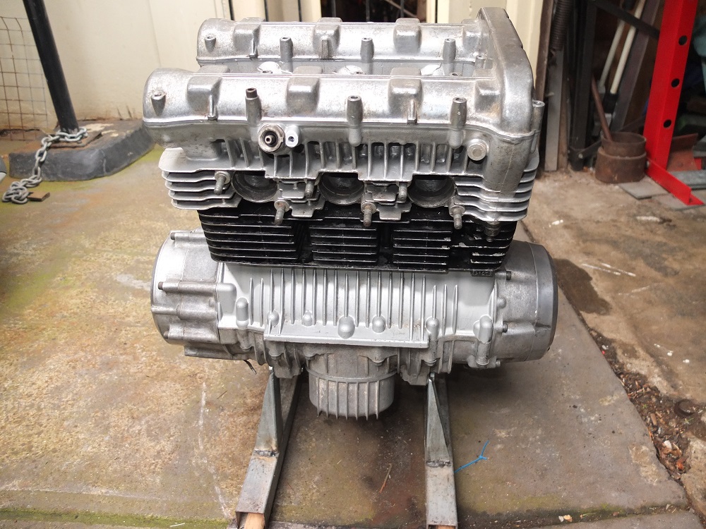

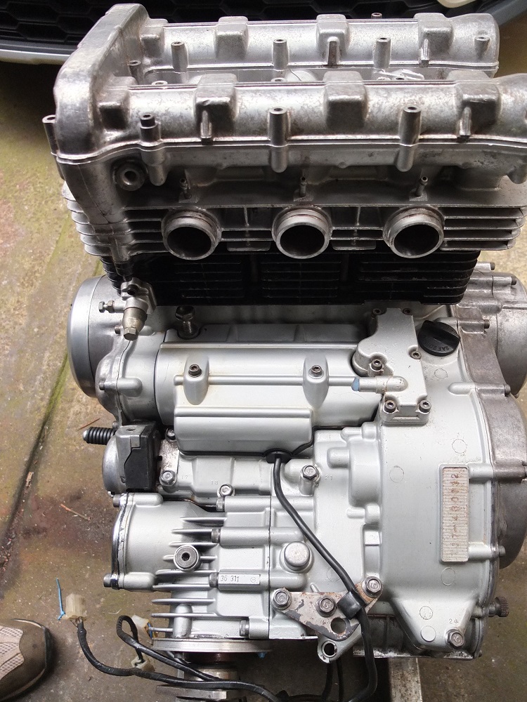

Reassembled the head today. New valve stem seals were the only new parts. All straight forward stuff, final timing of cams when the cam chain goes in later on.
Then I just continued to clean grim and muck from all the bolt heads and other crevices. In some ways the oil and dirt appear to have preserved the painted covers, as it is cleaning up pretty well.

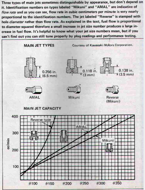

Most round slide (VM series carbs use Large Hex jets. Large hex jets are numbered to represent flow rates at 30cm of pressure IIRC. Large round jets are measured in mm of diameter, so a 150 is 1.5mm diameter.
In simple terms double the size of a hex jet from say 90 to 180 and it doubles the flow, but double the size of a round jet and flow increases by a factor of 4, so a 180 round flows 4 times as much as a 90 in a large round. There are tables on teh web that show a pretty close correlation for equivalent sized jets.
Thanks for the heads up. I found that comparison chart and as you said a huge difference in flows (refer attached). The 130 AMAL design that were in it are actually the equivalent to about a 105 round mikuni (reverse). So the PO actually leaned out the carbi significantly. The 160 AMAL that I bought are equivalent to a 120 round mikuni!!!!!! It is never a mistake, if you learn without doing damage - Thank you Teazer.

datadavid said:

Dig the jet cutaway will help splain it to others :P
