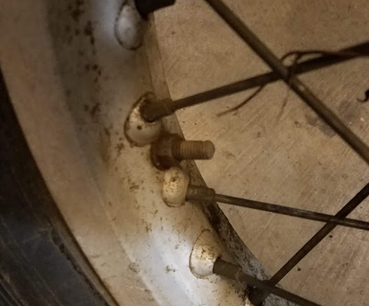

Wheels are almost definitely not stock. I don't think this bike would have come with shouldered aluminum? There are also there weird bolts poking out at regular intervals. Purpose?

Those bolts are clamps (rim locks) to keep the tire from slipping on the rim. They have to be loosened before you can remove the tire.
Rims are DID and look the same as were used on road racers and motocross bikes. That suggests that the rims or wheels may have come from a MX version of that bike or something similar. Also possible that a PO re-spoked the wheels with rims from a different bike. What diameter are they? The front sticker appears to say 1.60 - .... I can't read the diameter. The front hub looks like a DT style rather than MX250 style. Rear could be either, so probably re-spoked.
They are like the rims fitted to a TD3 which had a 1.60 -18 but the spoke angle would be wildly different on that bike. We picked up a NOS 1.60 -18 at a swap meet a few years ago and it ended up on the front of a CB160 road racer. They are generally slightly lighter than the H section flanged (Akront style) rims we all used to love.
Turnturtle is correct. That's a rim lock to prevent the tire moving on the rim when it runs with low air pressure for more grip.

The rims are a nice upgrade - the DT's still had steel rims as far as I remember (but I HATE rim locks LOL).

I own a dt250 DT2. do yourself a favor and throw out the rim lock. I used tiny square cut from a tin can and plumbers epoxy. makes for a smooth ride over 50 instead of an angular momentum tsunami. when you have this part in your hand you will see what I'm talking about. I run a 17t JT front sprocket. put shinko 244's. they definitly don't help on grooved highways or bridges.

Takes a lot of weights, but you can balance a rim with rim locks. On bikes I run on the street, but do real single track, I run them. If you’re dropping air pressure for off-road, they’re important. That said, if you’re running mostly street and nothing more than fire roads off-road, then get rid of them. It won’t hurt to keep that hole open, but I put a strip of duct tape, folded sticky side in, over the spokes.

its easy to do a good repair, go with the physics. EK=1/2m x v squared. you always want to loose weight and this crap is heavy. instead of adding lots of dead weight to compensate put the thing into the round file, do a quality repair of the rim and never look back. the 250 is rated at 20 hp so its not much of a stump puller. some contact cement a piece of leather over the hole, but I'm a jb weld and tin snips kind of guy.
