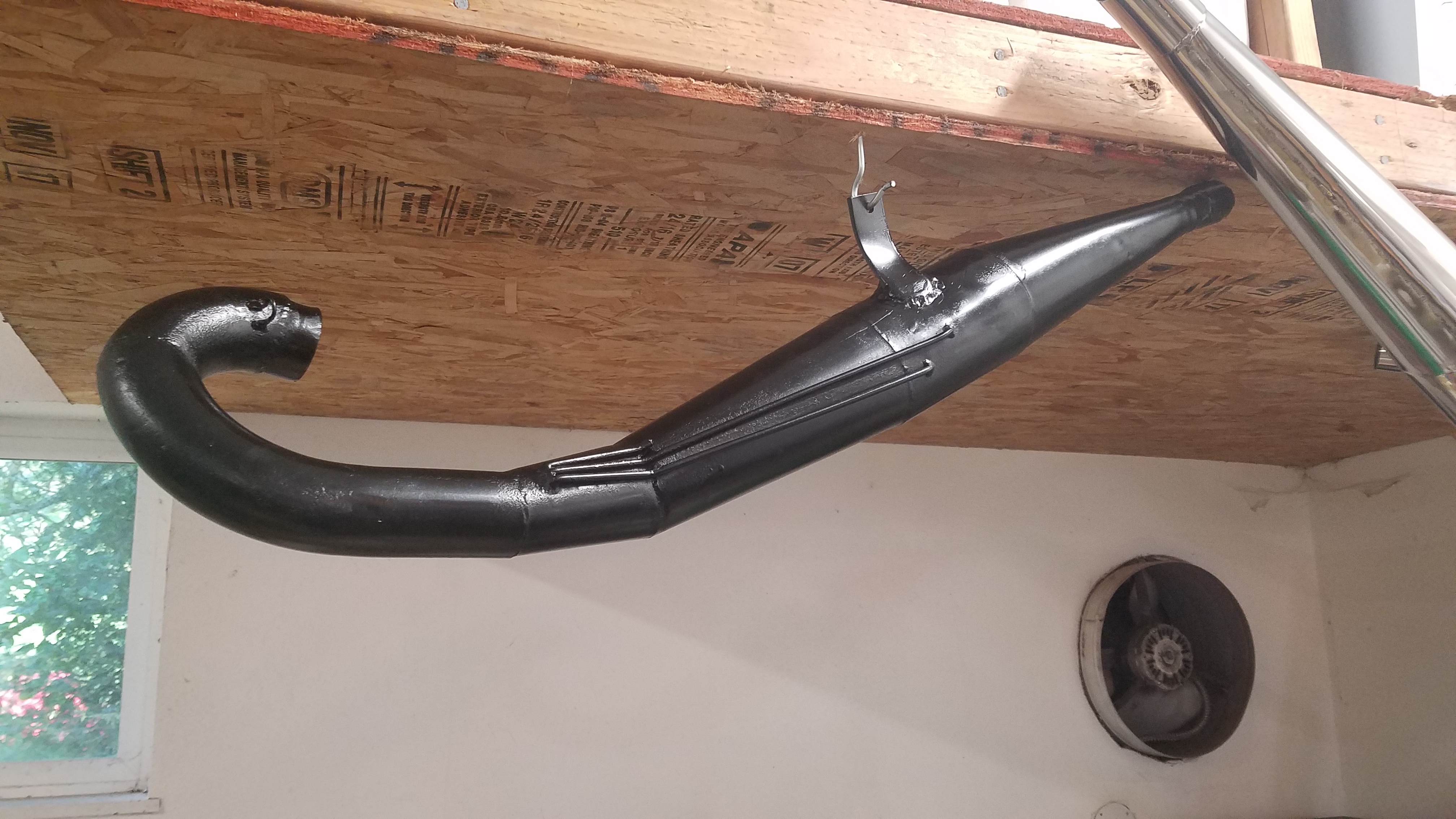

Got the chamber back from Pacific Pipe Repair. They pulled the dents and laid on some fresh black coating. Not 100% sure what the coating is, but I'm assuming it'll hold up to the heat.
