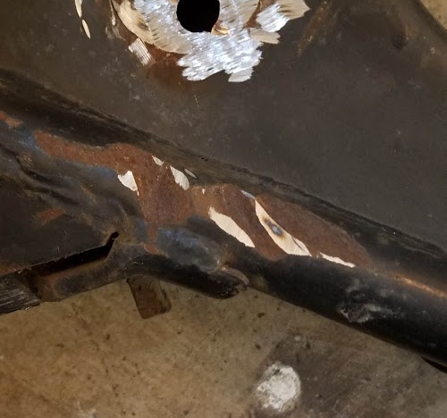

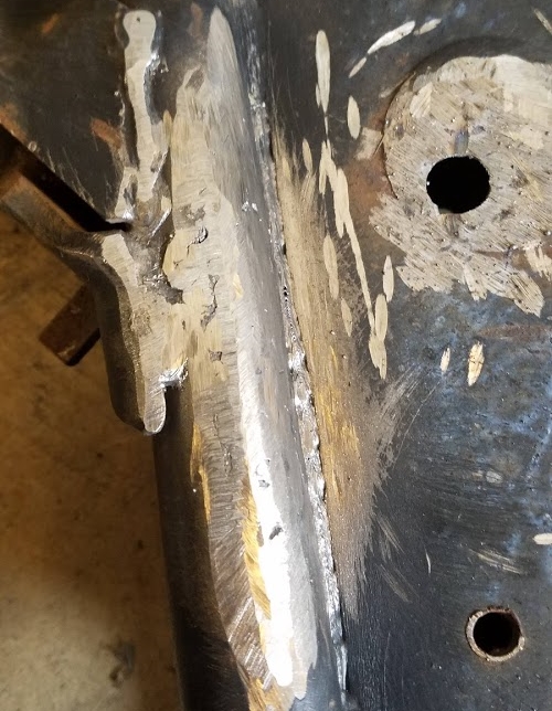

The previous owner went crazy with an angle grinder, so I figured one good turn deserves another. Flipped the wire feed welder into low voltage mode and started filling in the gouges. Definitely not perfect, but it's an improvement. I might go over it one more time before I hit it with the flappy-sanding thingy.

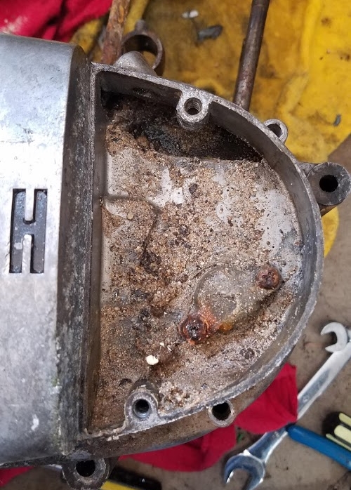

Engine tear down started and I broke the clutch basket, so time to hit eBay again. I got the usual number of stuck screws and will need to drill a couple of them out.

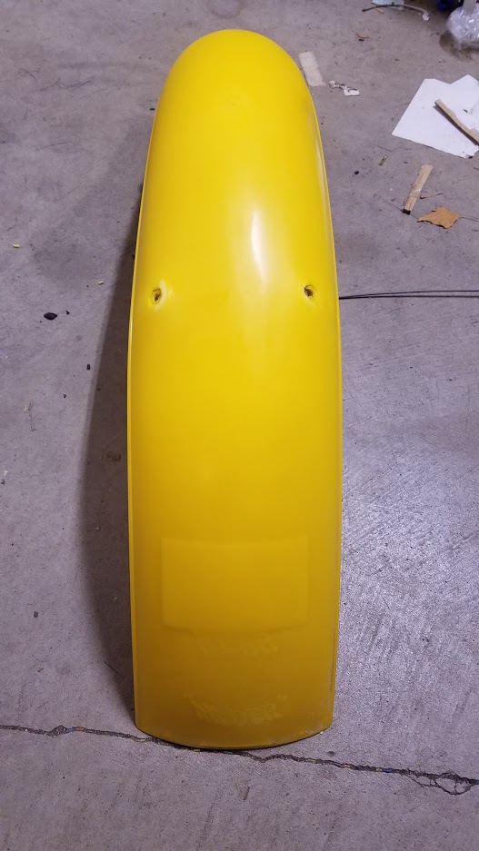

Started on the rear fender clean up last night. Went over the fender with an orbital sander and 320 grit. I'll start the hand sanding tonight.

Looking like a good start - one thing I found out is that any scratches/sun bleaching that you don't get out with the coarser grit you never will.
For sure. I'm going back to start at 220 grit when I do the hand sanding, I just didn't want to go too course with the power sander.
Finished the wet sanding through to 1000 grit and then hit it with some plastic polish. Not perfect, but suitable for something that will be covered with dirt and mud. :P
