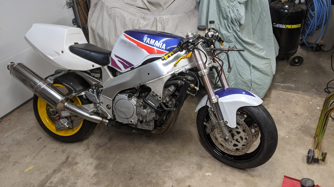

I got some busy time on the bike this weekend. I adjusted and snugged down the carbs and the airbox, flushed the fuel tank and hooked up the electrical, vaccuum, and fuel line to the tank. Some fresh gas and the bike is idling nicely. That got a number of checkboxes out of the way. While it was warm and idling, I tested the clutch in and out of gear and just didn't feel right. So..... I shut it all down and drained the oil and installed a fresh filter. I had already bought a whole new Yamaha OEM clutch so I pulled the cover and the disk stack. This is what I found:
Ugly but an easy fix and I think I caught it in time. I have a new flat tab lock washer already too. I'll finish it up tomorrow.
Fresh clutch, springs and oil done. I rode it under it's own power for the first time today around my neighborhood. It's running pretty well from what I can tell in the first two gears at least, I didn't try to take it out on the public roads (yet?) I have body work and some fab to do for the tach and temp gauge setup but otherwise, brakes and clutch are all new and feel right but need to bed in. So close.... Yippe-Kai-Yay!

Took it out for a longer test run a couple of miles to a gas station. EXUP valve and all the gears are working, lol, yowza it'll run. I might play with the carbs some more. I also need to finish the dash. The ziptied tach is very temporary....and bodywork.....
