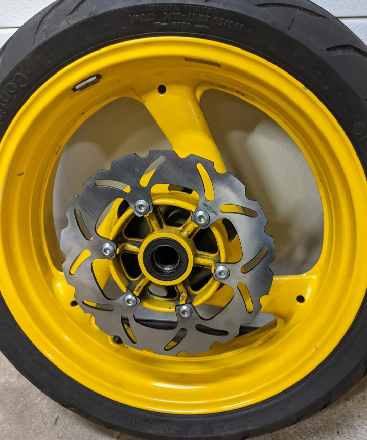

Still need to dig through my storage for those disks. I've had rethink on the brake mods for now I'll do new lines and refresh on the stock calipers and install the new front rotors. The blue dot caliper mod to the stock forks needs a few more components I'll collect for later. Hopefully I'll save myself some time for other things that need attention.

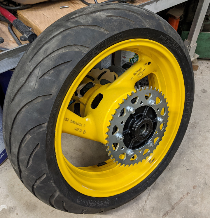

I had to pull a good rear caliper and rebuild it from the #4 bike as well. The rear brakes pads were loooong gone and the caliper was frozen hard.

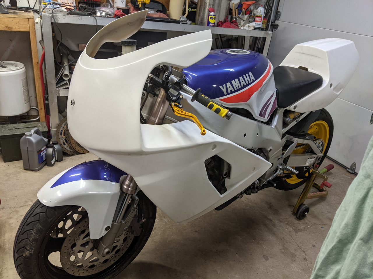

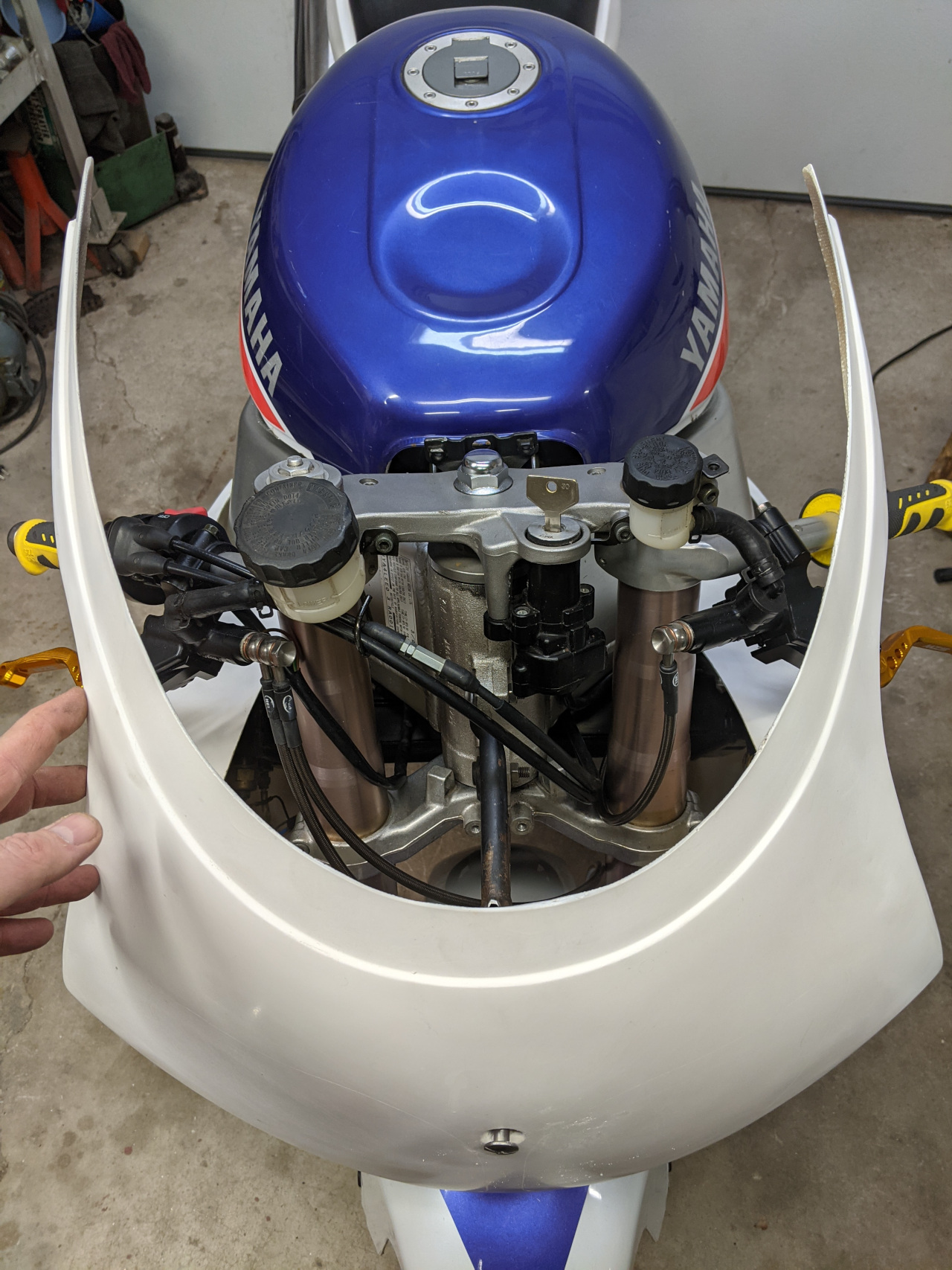

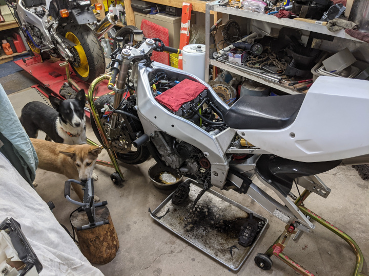

Not a great pic but my wife adopted a little blonde husky mix girl pup. Her and Zed are hilarious. I'm also doing more test fit up of the carbon fiber hugger and the fiberglass tail. This one uses the stock seat so it's pretty much already done. I loooove the other daytona style tail but it'll require a bit of alloy framework under the glass for support.

Yeah, rebuilding brakes suuucks but it's great when it's all done. Finally got in the 45T rear sprocket so I put my torque wrench to good use and finished up the rear wheel. Need to find a compatible front tire. I'm still waiting on brake pads and a thing or two to wrap up the brakes, it's pretty close now. I also found that I had 6 nice caliper bolts so I went and drilled them for safety wire. A little at a time I'm getting stuff done.
I'd been waiting on a few things like the 16T supersprox front sprocket to arrive. The stock ratio being 16/43, I decided on 16T front and up two teeth in the rear to a 45. I have a 15T supersprox front if I decide to change the sprocket ratio to 3:1 later. I did all 520 components instead of the stock 530 chain/sprocket combos. There's a noticeable difference in the weight between 520 and 530 kits but I didn't weigh them. I put on a cool WoodCraft shark fin too. Maybe it'll save some toes or fingers on the track. As in the pic, I still need to finish setting the wheel/chain and alignment and pop off two links and rivet a new master with it all lined up tonight hopefully.
