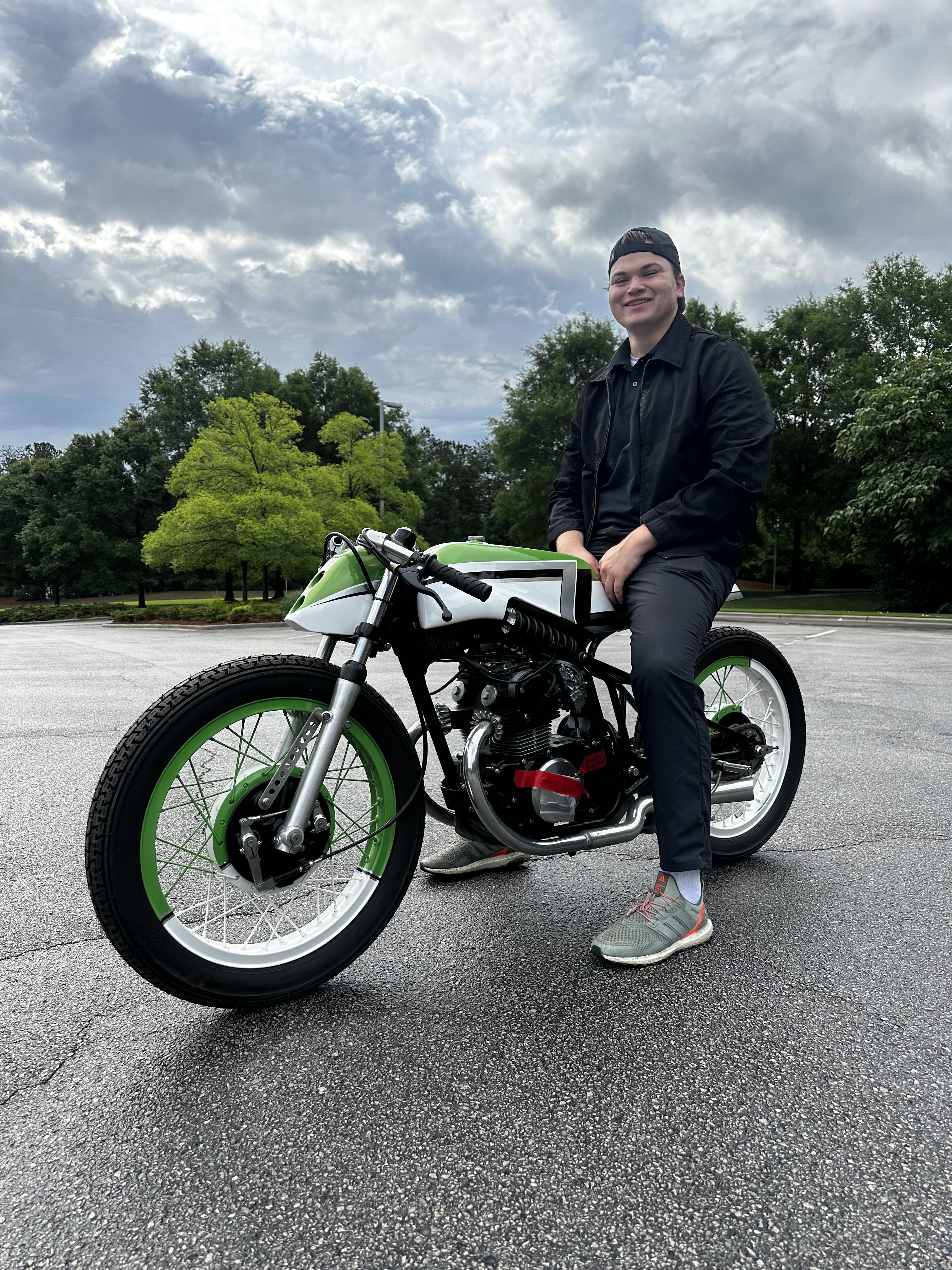

Howdy. Zeke brought Zooid home for Thanksgiving and is back home in the shop to make it a rideable bike and not just eye candy. Both Fuller and Zeke are kind enough to give me something to tinker with…the bike was always suppose to come back so we could dial in the engine tuning.

Now for a new state of tune.
“We are going to 19” K65 90/90-19’ skinny tires.
We may go to another set of wheels and make it as light as possible. Powder Coating is heavy.
The first thing I did was fix the electronic ignition because it was fried.
Then pulled the side case and put a timing light on it. It was retarded one tooth because we decked the head so much and statically timed it but didn’t put a light on it.
Removed the flat slides and put some stock 175 carbs and finally it ran 100% better. Ordered some VM22 Mikuni’s from Treatland TV.
I picked up another Cb 200 for 100 bucks and it has been sitting on the back porch for 10 years. My wife wants it gone. So I am going to take that Cb200 cam out and slot the cam sprocket like we did for our Victoria Build. Time the valve events as they should be. Have always wanted to put the CB 160 PE carbs on it for grins because they are 22mm and the intakes are longer. May do that to compare to the VM’s
You cannot put long enough intakes on this to make the flatslides streetable. This is what I learned from building the Bultaco Dragbike. TM24’s should be on 125-150cc’s not 90cc. When I ran this by ChatGPT it said to me, “You apparently didn’t listen to the guys in your forum.”
Hey they looked cool so did the cam ear from the cb160. Fuller said he just wants to tool around on it and he says it is too F’n loud. I fired it up the day after the 4th for my neighbors who didn’t quit shooting fireworks until 4 am. Bahahahha!
I have rewired the bike to relocate the battery under the bike for the battery box Zeke made. We had it in the head lamp just shoved in there.
Hope all are well. Cheers from Texas
