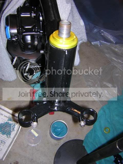

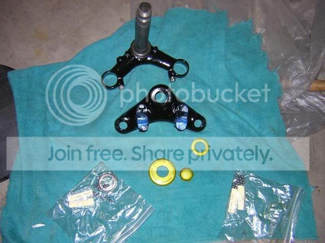

putting the triple tree together:
painted pieces:
grease used for ball bearings:
grease in action:
lower tree installed:
job done:

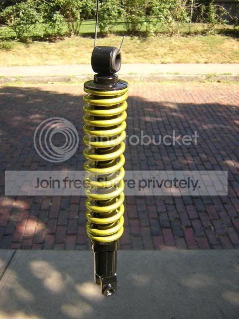

rear shocks.....
and one outside in the sun:
cannot wait to put them on so i can see how it will look.

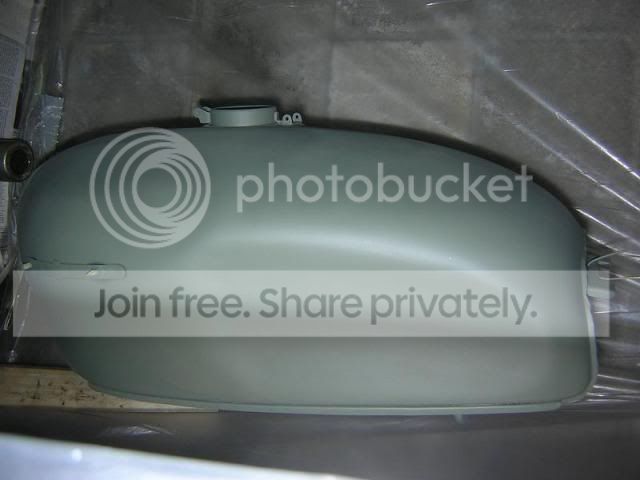

man... that looks awesome! how did you finalize your tank dents? I can not seem to get them perfectly smooth? i have shot a layer of primer on it to get a better idea of the flaws... now i could use a bit of help...

i smoothed it as much as i could with fine sand paper and then i used some filler primer (duplicolor's FP 101 Gray Primer Surfacer: http://www.duplicolor.com/products/primer.html) to smooth it out even further. i am not sure yet how it will look when done, but i'll keep you posted.

also primed the tank:
and put three layers of gloss black with a couple of layers of clear. i have to wet-sand it as well and smooth out a small drip that i got. i guess i will have to paint it with at least one more layer of black before i paint the stripes on.

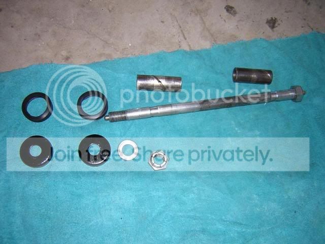

cleaned up all the swingarm pieces:
got some new acorn nuts for the upper bolt on the rear shocks. the new nuts were a bit too short, so i put a couple of large washers:
and
