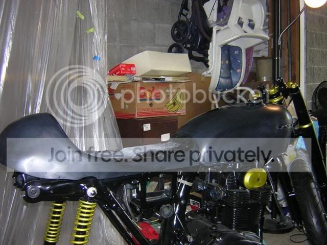

also, it's been a week since i put the last coat of clear, so it means i can wet-sand it and get it ready for further work. i hit the tank and the seat with 1000 grit wet sandpaper. it took a while, but the results are great. smooth as a baby's butt. i put the tank and the seat on the bike to start figuring out the location of the stripe. well, here are the tank and seat on the bike. they don't look shiny because they still need to get a few more coats of clear.
later,
g.

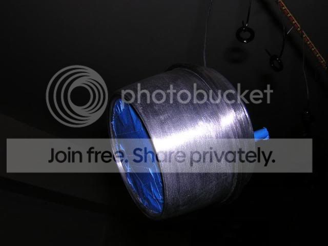

the speedo that i got with the bike was missing a reset "button" for the trip odometer. i got a different speedo at a local used parts store for $10 and took the trip odometer with the button out. i opened the old speedo and put the new trip odometer in. was thinking about painting all the parts separately and then assembling the speedo, but given the large likelihood of scratching it while putting it back together, i decided to put it together first and then paint it. so, i cleaned the speedo while it was apart and since i did not even open the tach, i just cleaned it while it was intact.
i masked it and did another wipe with mineral spirits and acetone.
speedo ready for paint:
tach ready for paint:
both will be gloss black with a gold/yellow bezel.

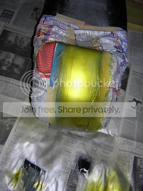

next came prep work for painting the stripes on the tank and the seat. i used a rubber band that went around the tank so that i could get a center line and then used a measuring tape to mark off edges for the stripes.
i used a blue masking tape to mask off outer edges and 1/8" masking tape (from the hobby store - used for painting model cars/planes) to separate the wide and the narrow stripe.
masked tank:
masked seat:
then i used some newspaper to mask off the surrounding area:
ready to be hit with paint....
and the ground metalcast comes on:
the seat gets 3 coats:
and the tank as well:
next came 3 coats of metalcast yellow:

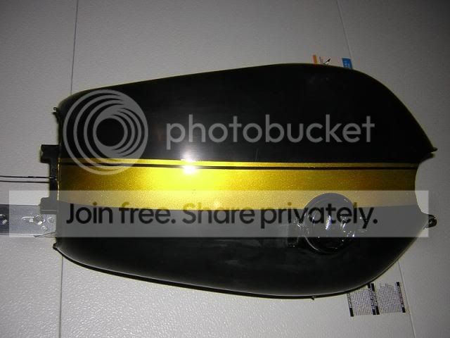

well, stripes turned out nice.
the tank:
the seat:
and this is how it will sit on the bike:
getting closer.......
just to give you an idea of how shiny it should be in the end...
i wet-sanded the headlight bucket with 1000 grit (just like the tank and the seat) and hit it with three coats of clear.
the result is a rather deep shine:
since i am doing the same with the tank and the seat, it should turn fairly similar to that. i just have to wait 7 days for the stripes to dry (i also hit it with 2 coats of clear after the yellow color) so i can put some clear over the entire tank.
