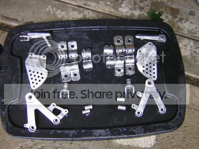

these are the bolts and spacers that i will use for the rearsets:
the idea is to get something like greg from ohio cafe racers did (http://www.ohiocaferacers.com/)

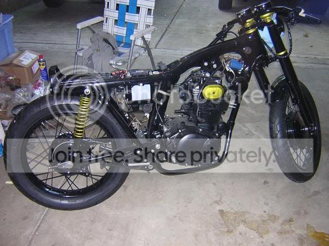

finally got the rear brake shoes:
and the rear wheel is on:
ha, it's a roller:

a buddy of mine (jesse that put the rubber on the wheels) came over last night as i was preparing to put the chain on and helped me out.
a new chain:
we had to cut some links off - ground a pin and punched it out. i thought it would have been more difficult, but it was actually not all that.
the chain is on:

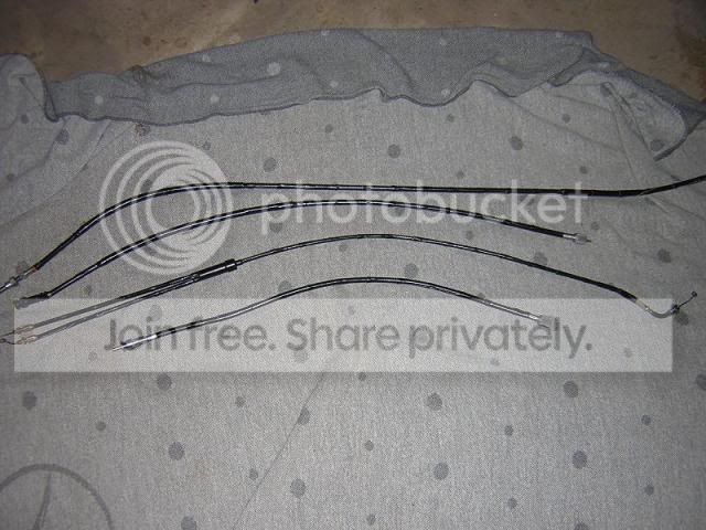

cleaned all the cables:
i figured i would try reusing old cables and if it does not work out, i'll get some new over the winter. i properly lubed all the cables and i had some liquid grease that i use to lube my mountain bike chain:
since cables were tan/gray, i decided to wrap them in black gorilla tape. hopefully it holds up:

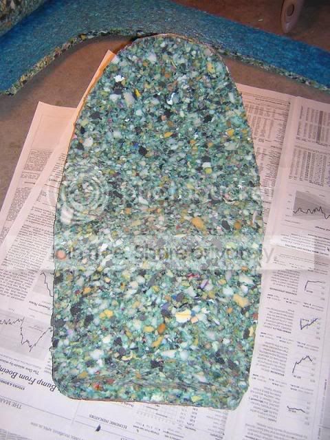

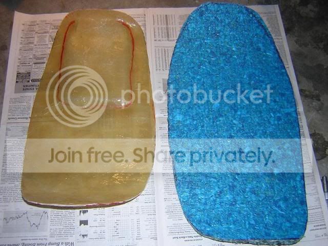

did some work on the seat pan:
i created a seat pan from fiberglass when i was making the seat. as a cushion, i am using the thickest carpet under-padding that i could find at lowe's. it was dirt cheap and plenty leftover. btw, i used two layers and glued everything with spray adhesive.

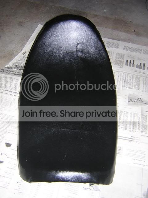

i made the cover out of black vinyl (got it at joann's fabric store):
it was tedious to get it all shaped properly, but it turned out ok. the vinyl is also glued on:

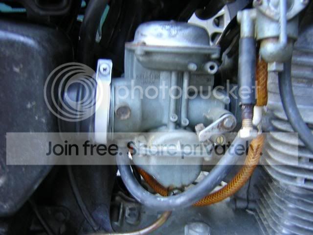

did some work on the carbs...
this is how carbs looked when i got the bike:
and the petcock:
disassembled and in the process of cleaning:
after an eternity of spraying them with the carb cleaner and using the finest steel wool and a small brush, the results:
both carbs:
this is how the cleaned carbs and the petcock sit on the bike:
