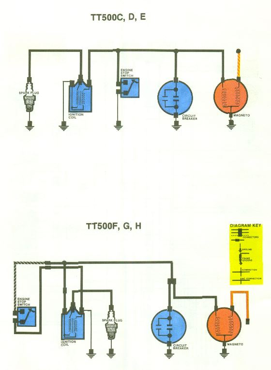

The ignition circuit and the lighting circuit are separate. If you are running lights you definitely want a cap or battery but the ignition doesn't rely on it to start. Don't forget the TT500, they didn't use a battery/cap at all.
