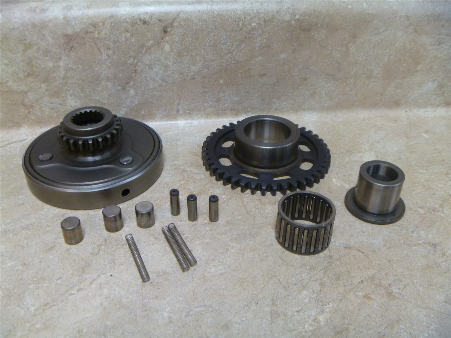

Look here: See that caged needle bearing, that can get toasted from the chatter, mine has the same ruts in the needles and feels notchy on the shaft. that pile is on eBay::
http://www.ebay.com/itm/Honda-650-NIGHTHAWK-CB650-SC-CB650SC-Used-Engine-Starter-Clutch-1984-HB48-/111553214260?hash=item19f916f734:g:F7cAAOSwMKpUZqPb&vxp=mtr

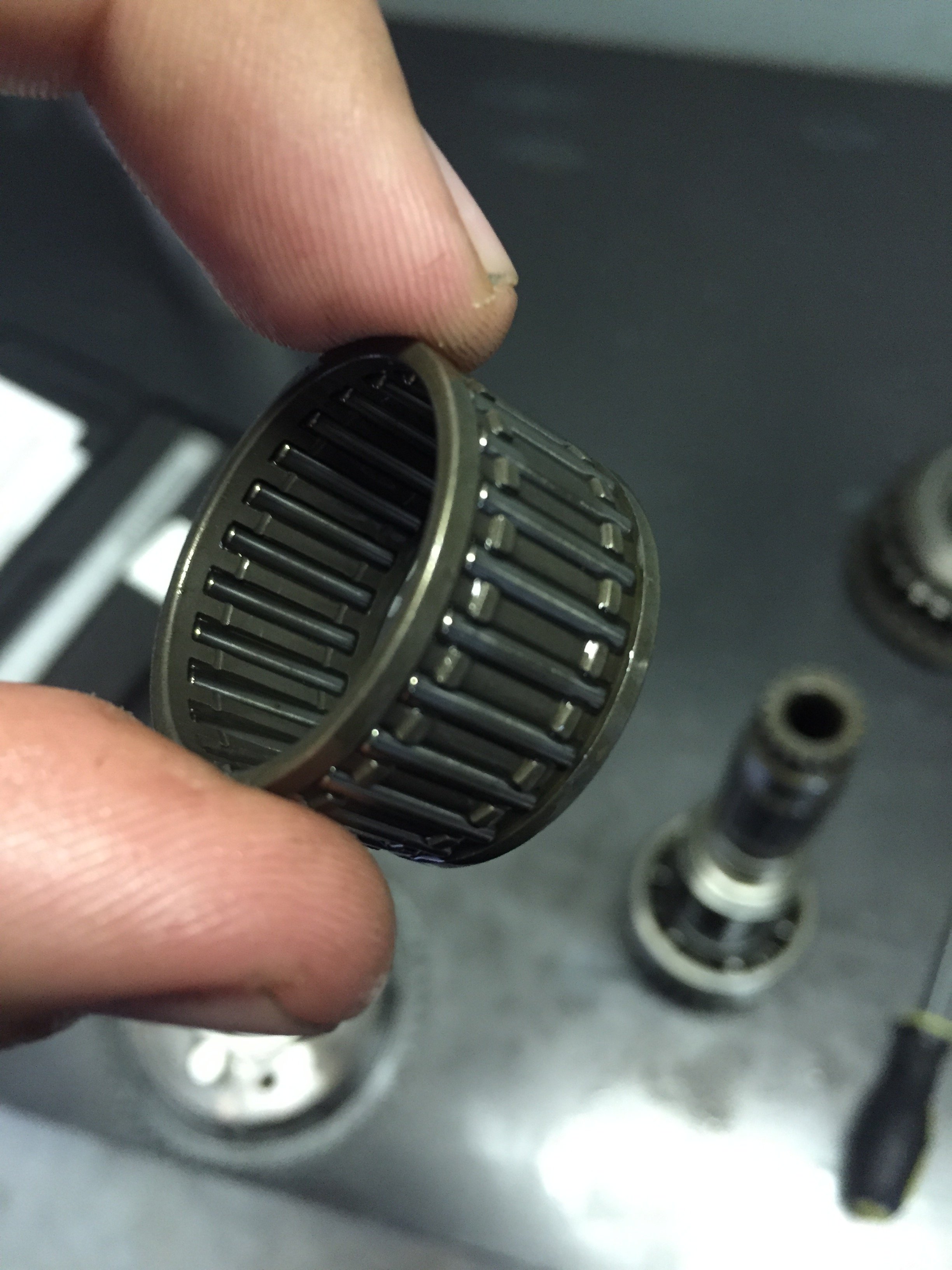

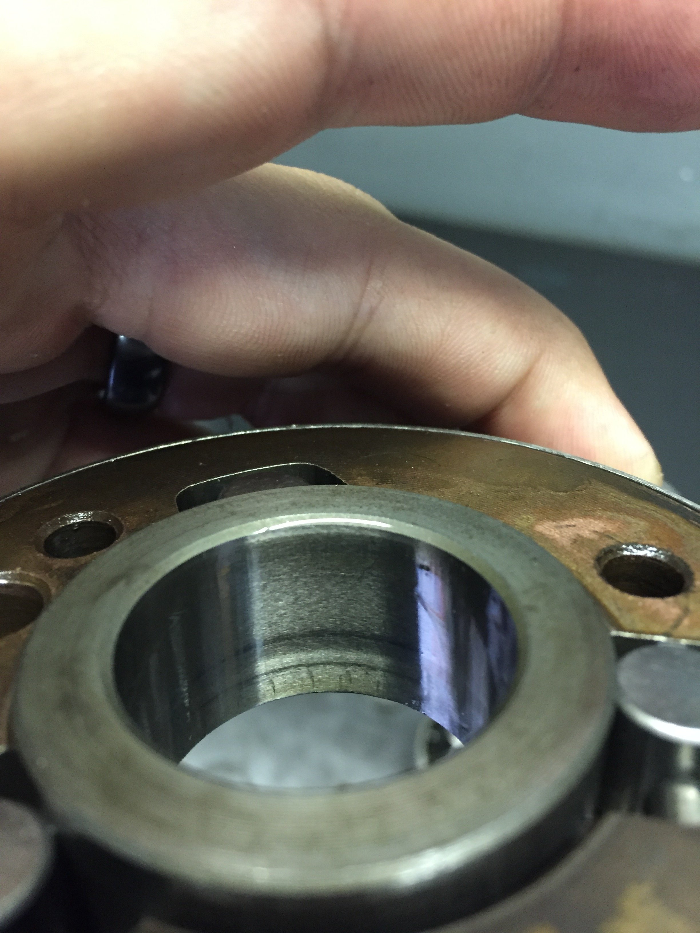

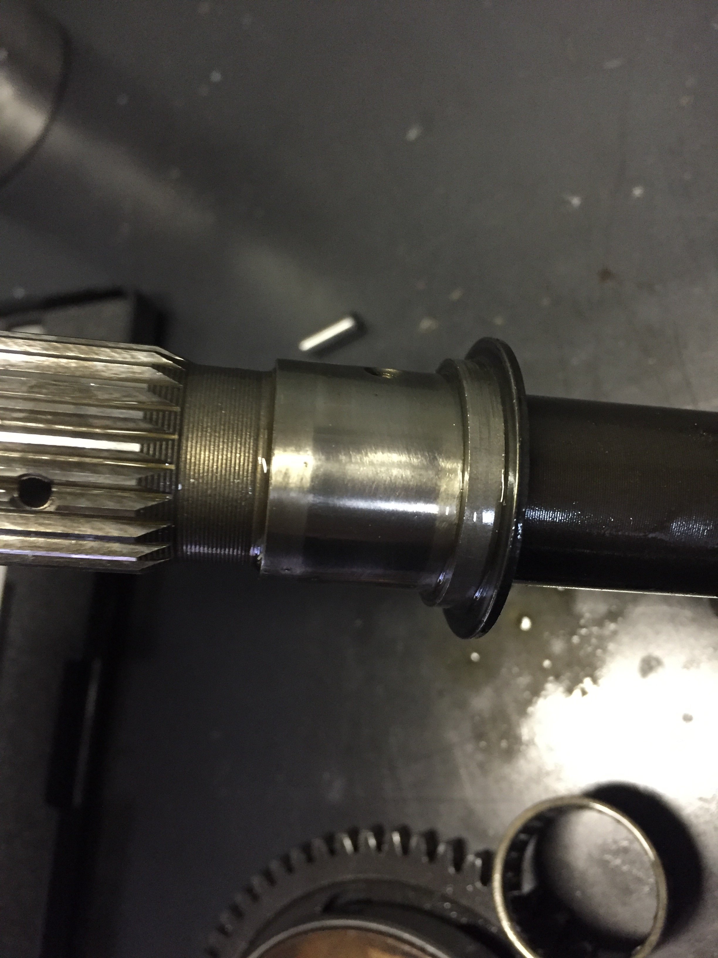

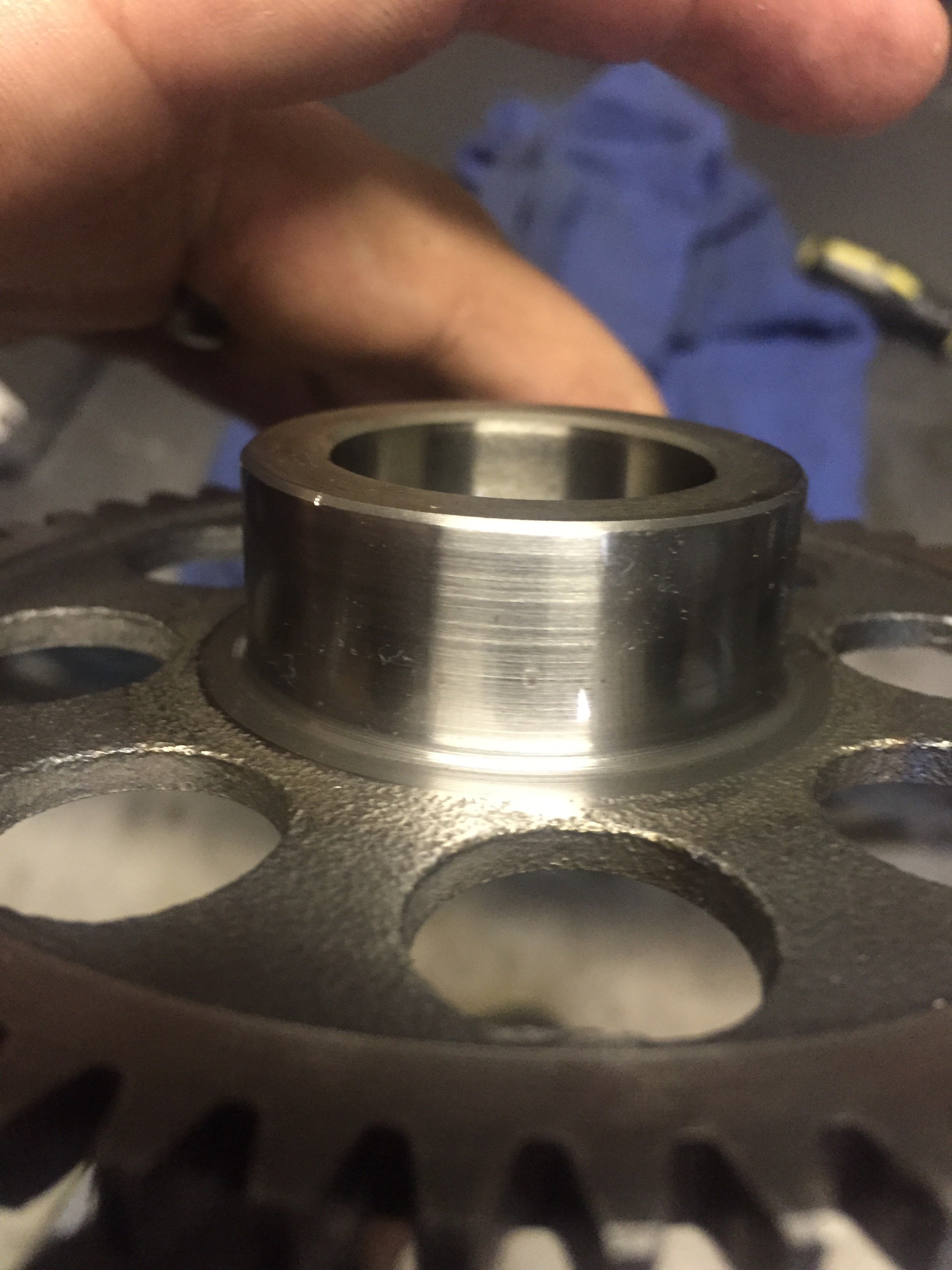

Here are some pictures of mine, i can't feel any chatter on any see face and the bearing looks great.
Yep looks good! hows the surface where the rollers grab? If everything looks good put it all back together clean then use a squrt bottle to saturate it with some oil, same as you will use in the motor 10/40 likely no synthetic at least until you get it going good, I like Valvoline 10/40 neat, clutches work good with it it seems, but i guess that's a whole nuther can of worms, so use what you use.
Second thought... with all the frustration... I would cut my losses and buy that pile off eBay, you will have all parts that were working together before... smaller risk of loosing more time and gaskets.

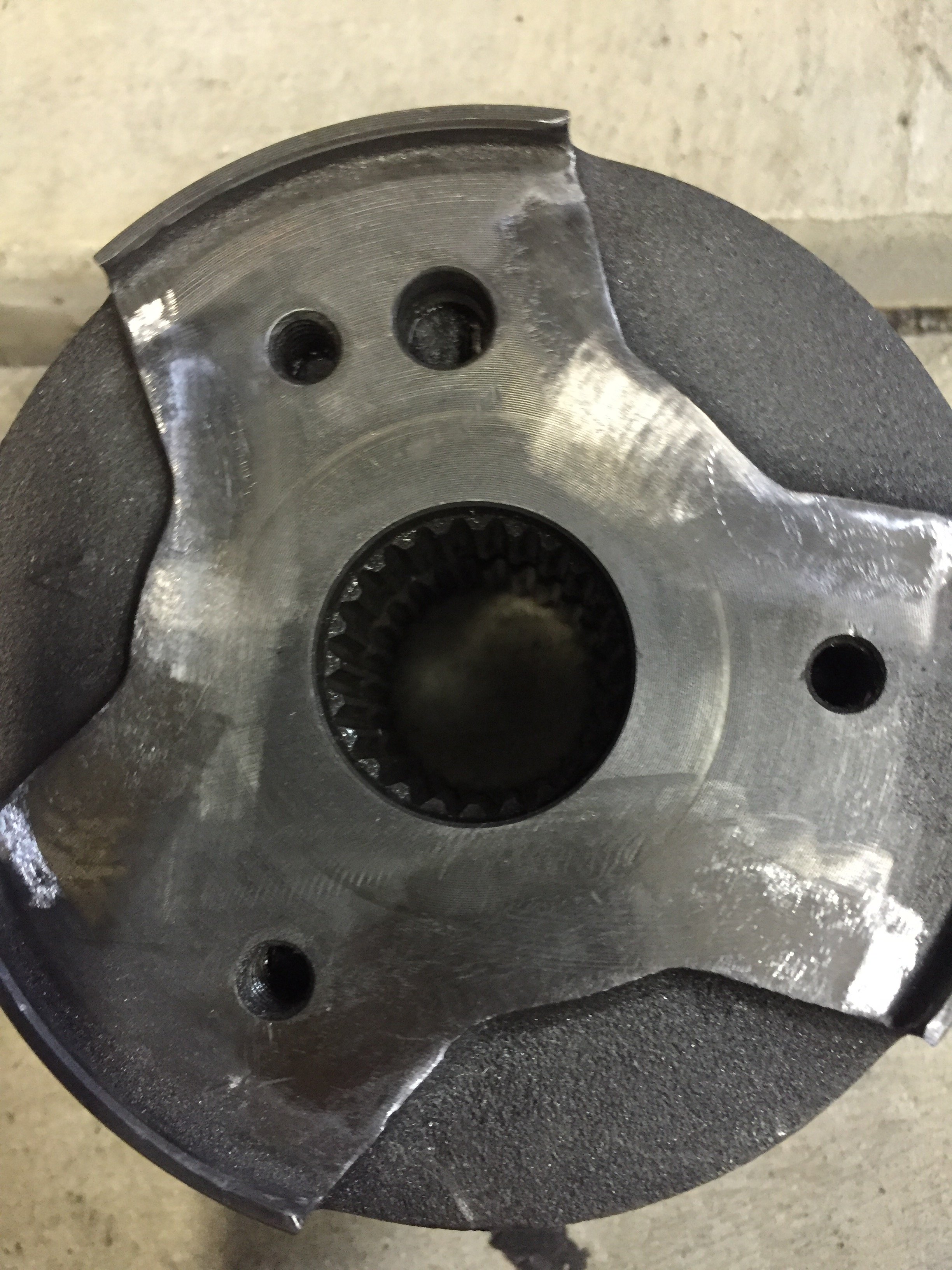

At this point the job is so easy to me I don't care.
I polished up the gear face and the place the rollers rub and threw it together last night.
Guess what now works!!!

Sometimes we just need to go the extra mile and over think how these things work, glad you got it sorted :o

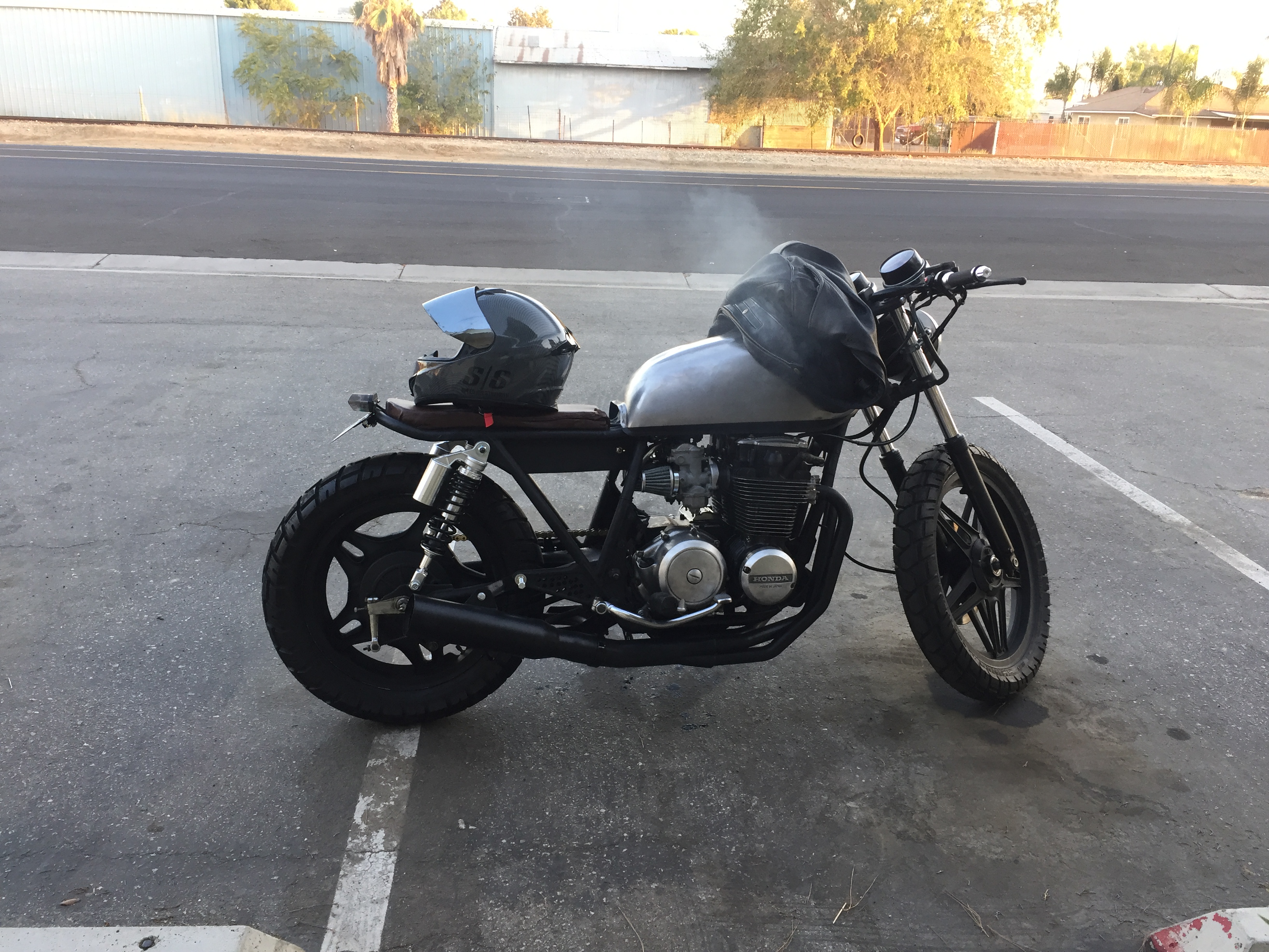

Well here I am broke down in a bad neighborhood.........started loosing power at 6k then down to 4K. I went to flip a u to get home and she died.......leaking oil like crazy not really sure we're from either.

Guess that bad noise was something else then.. sure it does not say triumph or matchless or something like that on the covers?
Hopefully nothing too serious.
Yeah may have been a bad idea to ride it before finding the oil leak, but the starter clutch was the issue at hand.
