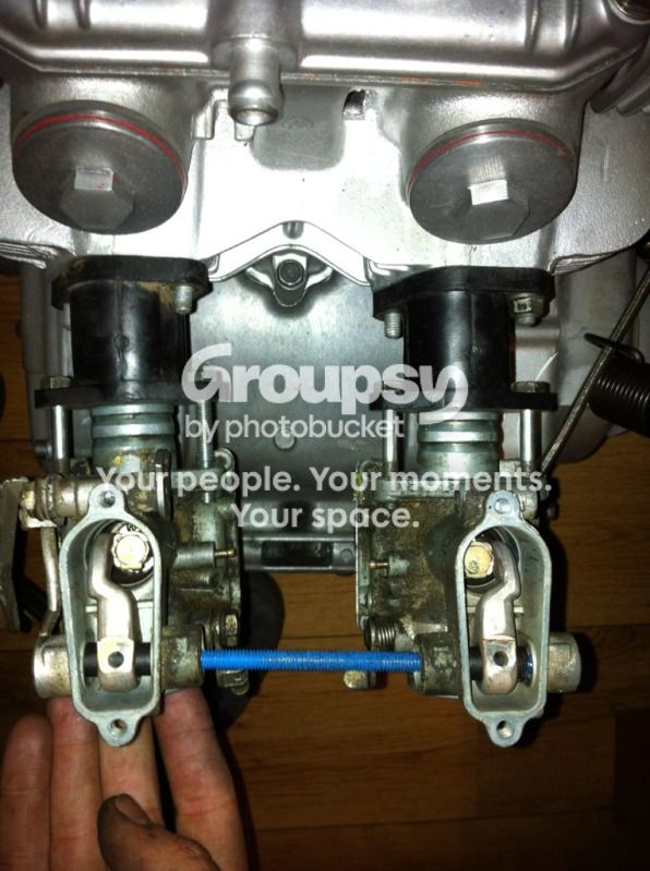

I have a question about the intake manifolds. If anybody with a cb200 could check, it would be awesome and greatly appreciated.
We've found cb350 (well, that's what the seller said...) carbs on a oldtimer-venue last week.
Guy wanted 10 bucks for them. To me, that's a 'can't go wrong' price ;)
Bought them and working on them right now. I already found out the holes (yes, all of them!) are alligned so i only have to mill the tubular pieces that would go into the rubber intake manifolds on the 350 to make them fit. Gotta love Honda!
But, i ran into a problem wich i can't find the answer for. The intake manifolds of the 200 are crooked. Atleast, one is. Since i tore them off a gazillion times i don't know if it's supposed to, and if so, wich one is crooked. In the first picture you can clearly see the right carb is straight with the cilinder, but the left one bends inwards. Normally, that won't be a problem as the cb200 carbs are not on one rail or something. The 350's are however and i need to know if one of the manifolds on the 200 is crooked. Could be, for clearance issues or something..
The m6 blue rod is in there for measuring, i'm gonna make a new throttle axle from stainless and ditch the mounting plate. Cablestopper and such is going on a little mounting plate i still have to make.
On the second picture i'm holding the crooked carb straight but you can see on picture 3 it creates a gap between cilinder and intake. Do not want :P
Question once again: Is it original that one intake is crooked, and if so, is it the left or the right one? They're interchangeble so i'm gonna order another straight one. Just need to know if it's the lefty or righty.

Definitely looks like someone dropped the bike and bent the intake. To my knowledge they are supposed to be straight.
Re: CB200 '73 tracker project
Hmm that's a bummer if it's bent. But to be honest, i don't think it's possible to bent it by the amount it is in right now and not break it. It's a fairly decent thickness.. Gonna go ebayin' for an intake anyway.
Thanks!
Mine are straight as well. The intake is not solid metal all the way through, so is it possible it got stretched while leaning on something over time?
Most def possible. Bike sat in a shed for couple years without jiffy or centerstand. Figured it out btw. i had a scrap piece of aluminium square tubing lying around and i drilled holes in them, as if it were the carburators. Wrenched it all down and the manifold was forced straight again. I left it that way overnight and it's all good now. Thanks!

I suspect that you have those on the wrong sides, but they are different for sure. I didn't believe it, so I had a look at a 200 head in the shop and for sure, they are not parallel. On this one, the right side is angled out slightly and teh left is almost straight.
Fortunately you need new manifolds anyway, so you can make them to fit the new carbs.
