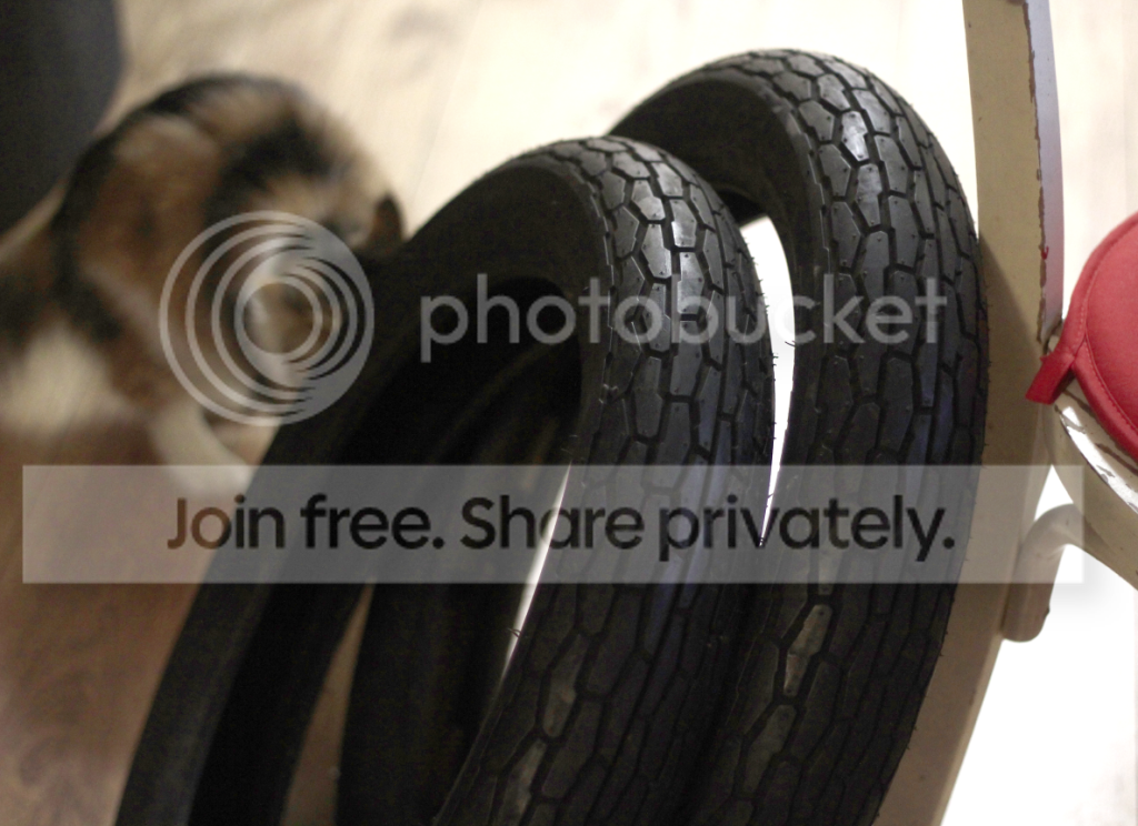

Two weeks ago my friend Bert and I went to a vintage bike (parts) show in Utrecht. Never been to such an event and it was awesome! Two halls filled with old vintage bikes and parts and did some great finds there.
Bought two Dunlop f17-tyres for only 50 euro together. Also bought very cheap closed-cell-foam for my seat. 10 bucks, enough to make two seats. Also a MX throttlehandle for only 5 euro and some small parts. Bert went home with three T-shirts....:P

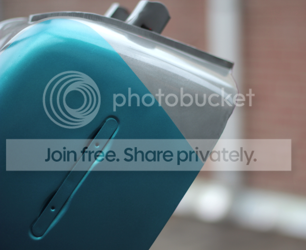

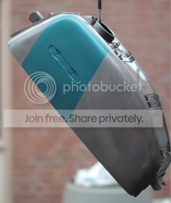

The tank was blasted a while ago so i went to the paintshop to pick a nice colour. Made a quite random pick and came home with 'caribean blue' metallic and a can of 2k clearcoat.
Sanded the tank with 800 grit to get a smooth surface for the paint. Did not use a higher grit because i like the texture it makes when sanding it in circles. Took a few hours but can't say i regret it :D
Since Bert can do anything including awesome paintjobs, he was given the honour of painting my tank ;)

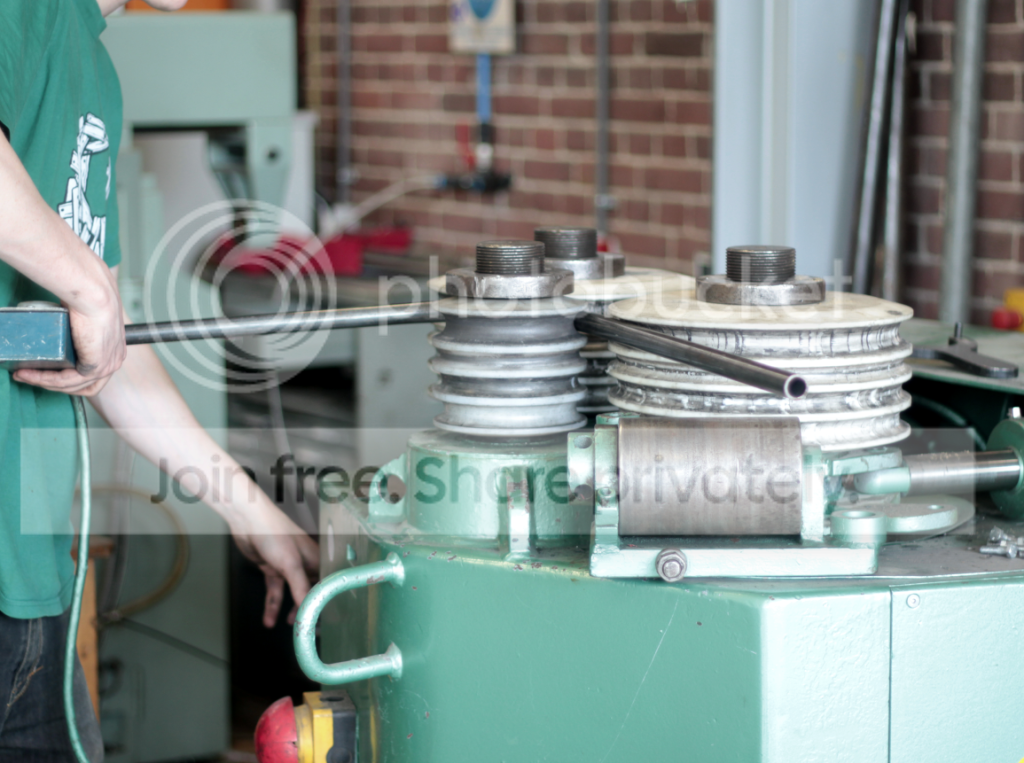

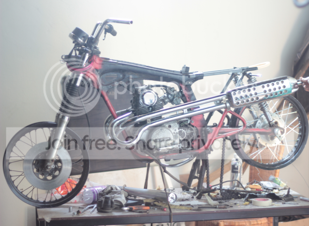

Stripped down the whole frame and tried the exhaust with the engine of my old 125 to see where the exhaust mount should be and because the 125 and 200 engine is not the same, we will make a adjustable mount. We took the frame to school and started on the tubing of the hoop. They've got a big machine there called "mother of all hoopmakers" which made it a lot easier. Monday is welding day.
If anyone wonders: the 125 engine fits like a glove in the 200 frame.

Great update! I've been waiting for the next installment. The tank came out very nice. the bare metal look with the coat of clear is great and I don't think the blue is too girly nor are the other colors you mentioned. I'd need to see the the rest of the paints and colors to see how it all comes together and give a more informed opinion... but you are on the right "tracker" :P
Re: CB200 '73 tracker project
Your bike is going to be awesome. I'll bet you it will even make bike of the month. If not that then at least nominations. I would go with a dark color on the frame something that lets the blue on the tank stand out. But I have no idea what that could be.

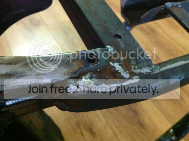

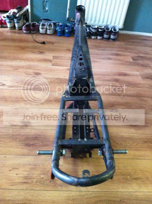

Finally, i got my frame back :D Instead of having it welded by the workshop-guy, bert welded most of it himself.
Looks awesome, exactly how i pictured it, now it's time to take the old sanding paper and finish it of.
