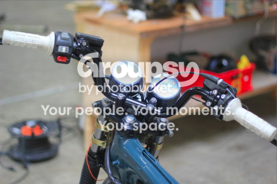

Btw: Can you tell me what handlebar you got there ? It looks really cool and comfortable.
-Sven
Re: CB200 '73 tracker project
Sven, as far as i know they are the original handlebars that came with the bike. At least, they were on it when i bought it. I gave them a new powdercoat which makes them look totally different.
Wanted to update some more but haven't had the time...Spending two whole days now making a battery casing, and i find it very hard to do... everything is crooked and some parts are too short or too long ???
Alsmost every part of it has been made twice now, but i'm finally starting to get the hang of it. I expect it will be finished tomorrow and it wil be pretty pretty pretty when it is done ;)
Ah okay, thanks for the reply Jene !
I think I will then just buy those, the LSL Flat Track Handlebar:
They seem pretty cool too^^
-Sven

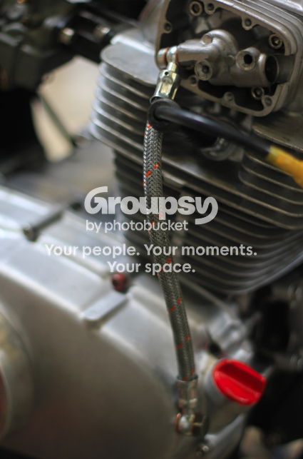

Let's start with the biggest progress! THE ENGINE IS RUNNING! All the credits go to Bert, who spend 3 days in a pile of wires, grease and battery's to make it work :) The mailman brought in a nice package with the missing links to make everything run, and then some. CMS even got me this cool keychain haha 8)
It seems everything works, the coil died in the battle, so i have to find a replacement for that old bastard.
The oil canal Bert rerouted works like a charm to, so it seems. Since i don't have a battery yet and the kickstarter died as well, we use the old drill-method to fire it up for now.

Just caught up with this thread this afternoon. Very cool looking bike! Have you thought about running a lower set of bars and lowering the headlight/gauges? It looks nice as-is but those changes would give it that sleek and mean modern tracker look ;D
Hey Barnburner,
yes, i have thought about different front-options,handlebars etc, but in reality this bike is really small, even though the pics don't always show it. In my opinion it needs something bigger in the front end or something. I'm scared that lowering the handlebars will make my bike 'disappear' even more, even though it would look more bulky...So I guess i keep it this way for now :)
looking great. are these the original bars with the wiring & throttle inside the bar? if so how did you adress that? new controls?
any plans for tail light / blinkers?
