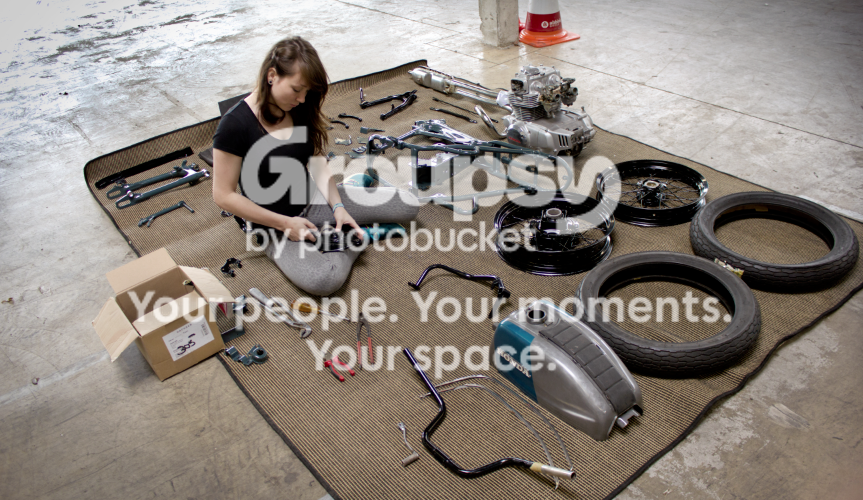

Pretty pretty pretty parts <3
Re: CB200 '73 tracker project
The last shot is just cool. Looks like a lego set you got fro christmas or something. You are on the home stretch for sure now.

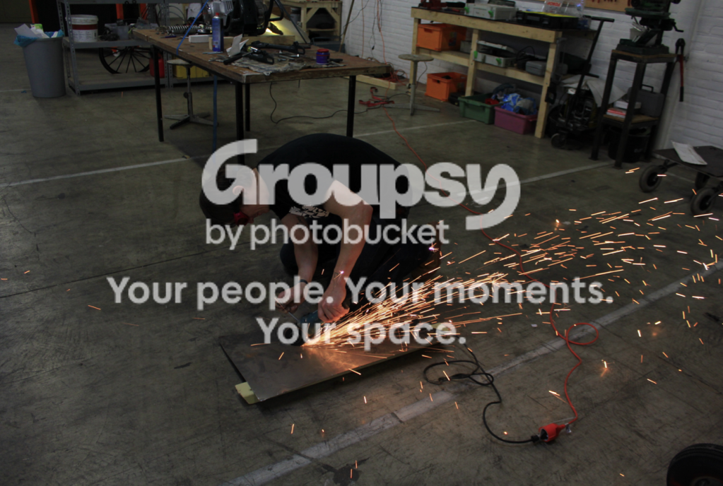

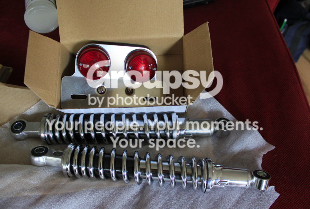

I feel Bert and I made a lot of progress last week, we made a seatpan, shaped a seat, bought some tubes and finished the wheels, Bert tore the forks apart and he made a mount for the brake caliper and since it was my birthday last saturday, Berts brother and dad bought me a set of new springs and a taillight.
Seatpan was made of paper first, to check the size and shape. After that Bert cut it out of a piece of metal. I shaped the foam using a sharp knife and a hairblower to heat the blade.
The guy from whom i bought the foam suggested hot water but since we do not have it overthere, this worked just fine.
Used a funny type of glue to stick both parts together and shaped the rest while on the frame. I think it came out nice. It is still a bit rough when the seat is finished you won't notice.

Happy birthday-parts!
