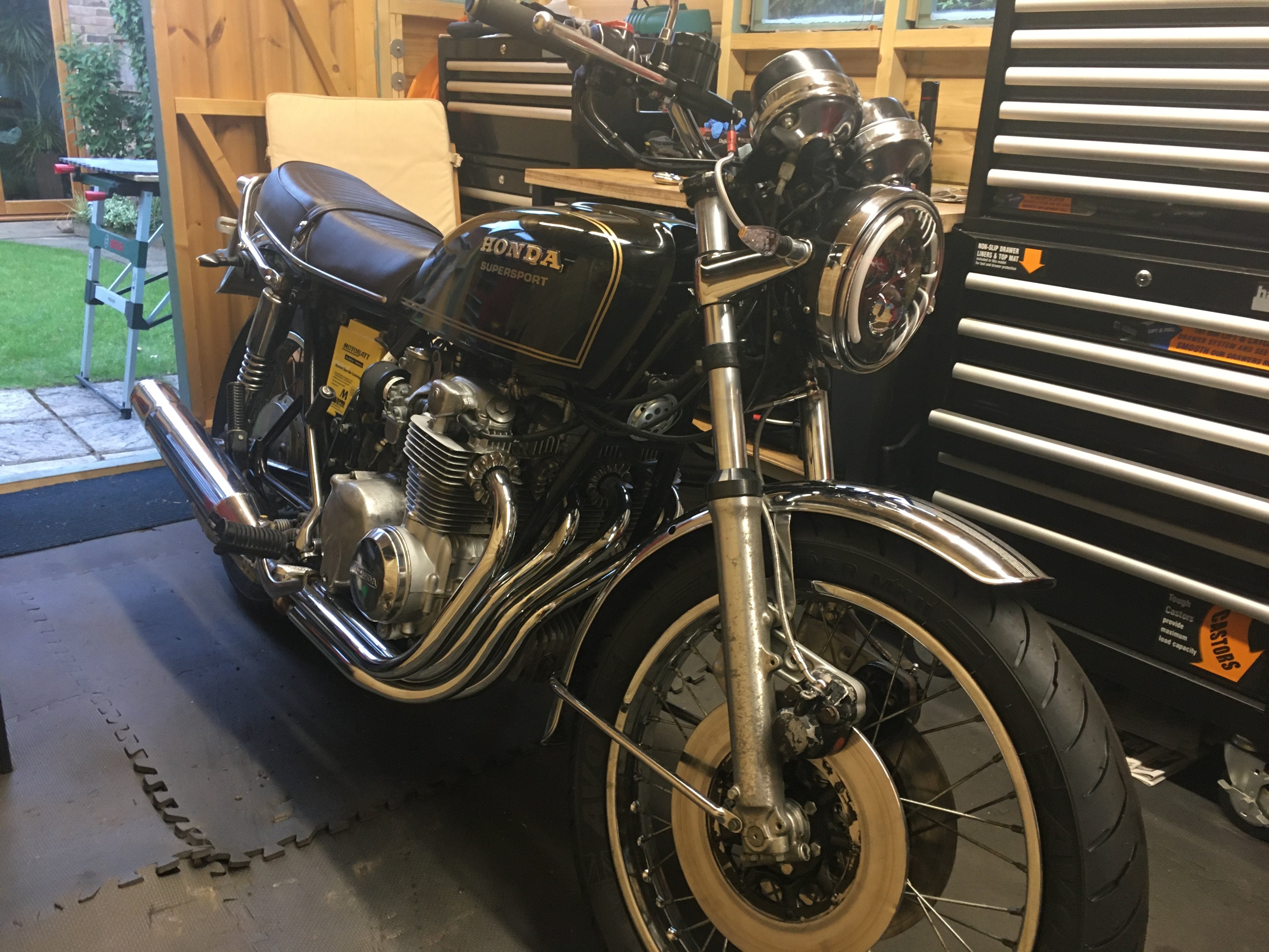

At last some progress to report !
found a supposedly decent CB550F tank here in the UK on ebay so snapped it up.
its been repaired before but to a high standard, the paint is black with gold stripes and lettering.
i couldnt resist a quick DA coumpounding and WOW it looks great ( from the right angle !)

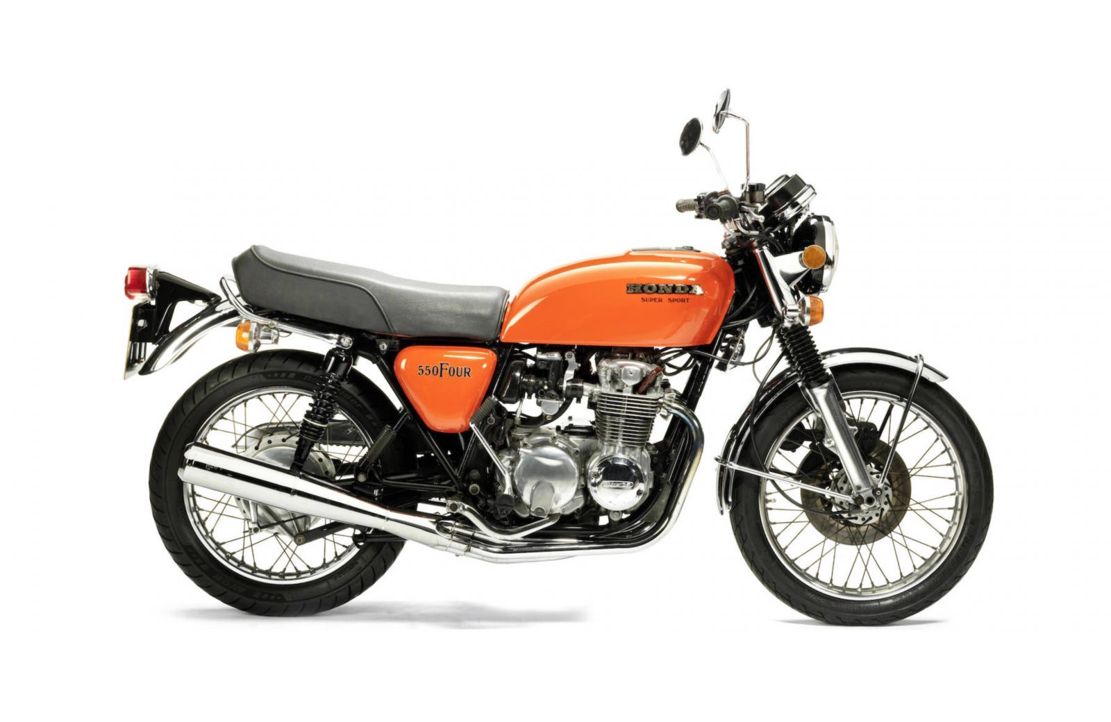

my plan is to go Lively Orange or a close RAL alternative, but the Black and Gold does look good......
I’m leaning towards Orange..... so today filled, sanded and primed the side cover in prep for an Orange Experiment.....
That's come on a treat. Black n gold smacks of John Player Special colours.....perhaps?
Yes it does look like JPS, its a classy look.
the tank paint does need redoing, i showed its best side above :-)
i’m going to test the orange look with the side panels, i have a set of the correct blue ‘550 Four’ stickers to complete the look.

Cool....orange with grey lettering or accents/stripes is a good combination IMO.
