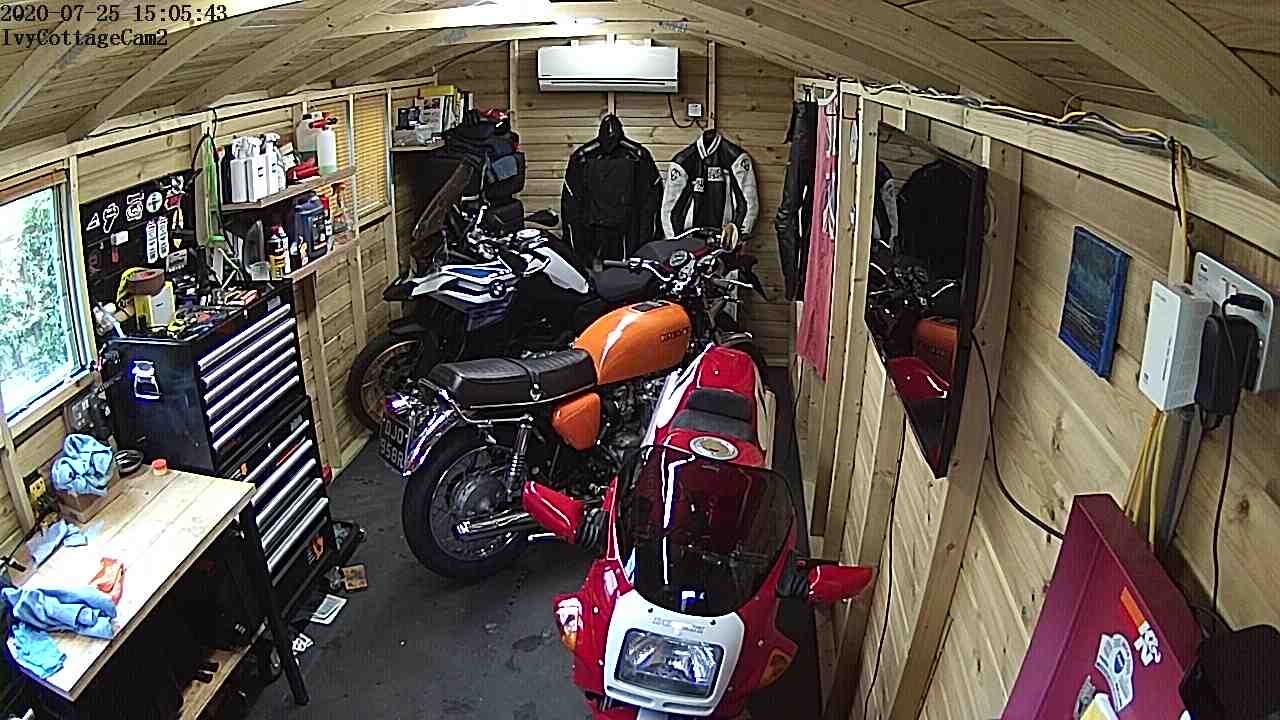

Here’s a view from the security cam showing the trio in the workshop.
the tank is very rough at the moment, but looks ok from range in lowres
