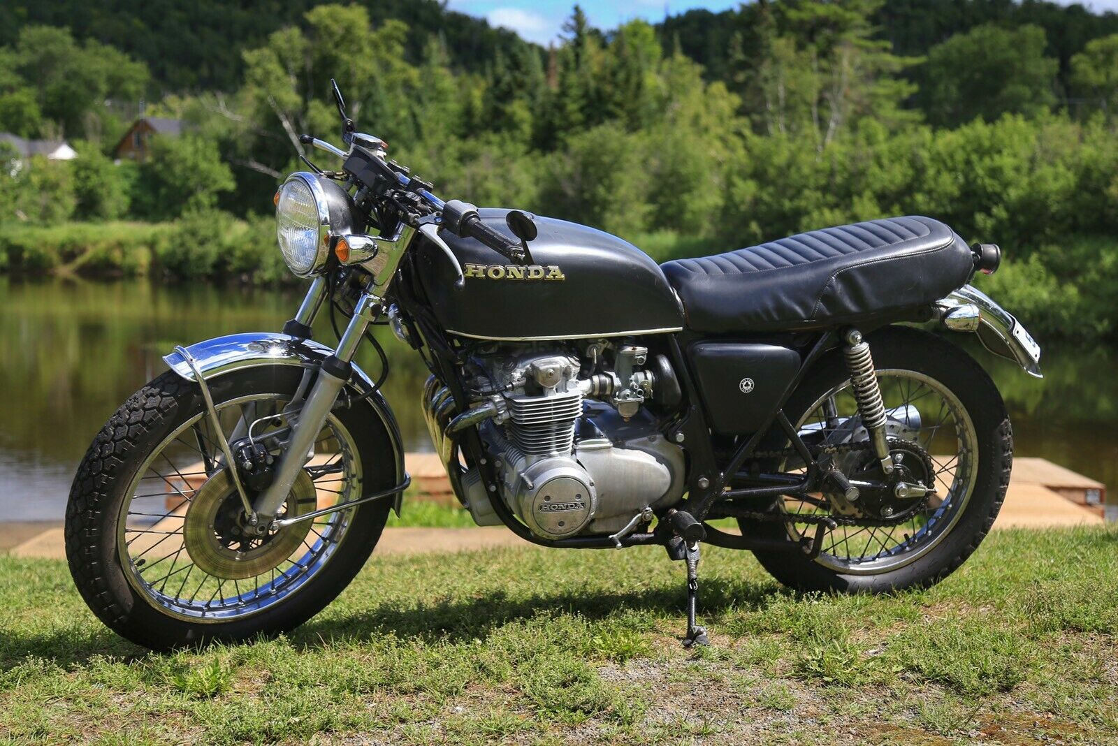

Hi Steve great looking bike. Love what you've done with it. I recently bought a CB550 that needs some work too. Hope mine looks as good as yours when it's done. The only problem is, i know nothing about motorcycle mechanics. Here are some pics...

Excellent, good looking bike and you have the sexy exhaust!
whereabouts are you?
steve
In Montreal. Jimbonaut was the one who referred me to the site.
Thanks, I too like this exhaust, unfortunately it had a small repair on it that rusted through. Will probably need to replace it next season. You've done some really nice things to your bike, and I love that you've tried to keep it as original as possible. I love the handlebar you put on. Was actually thinking of replacing my handlebar with one identical to that in order get some clearance between my tachometer and master cylinder.
Have you kept the original gauges?
The handlebars are just the european spec, i much prefer them
i am keeping the original gauges at least for now, am planning custom faces for them .....

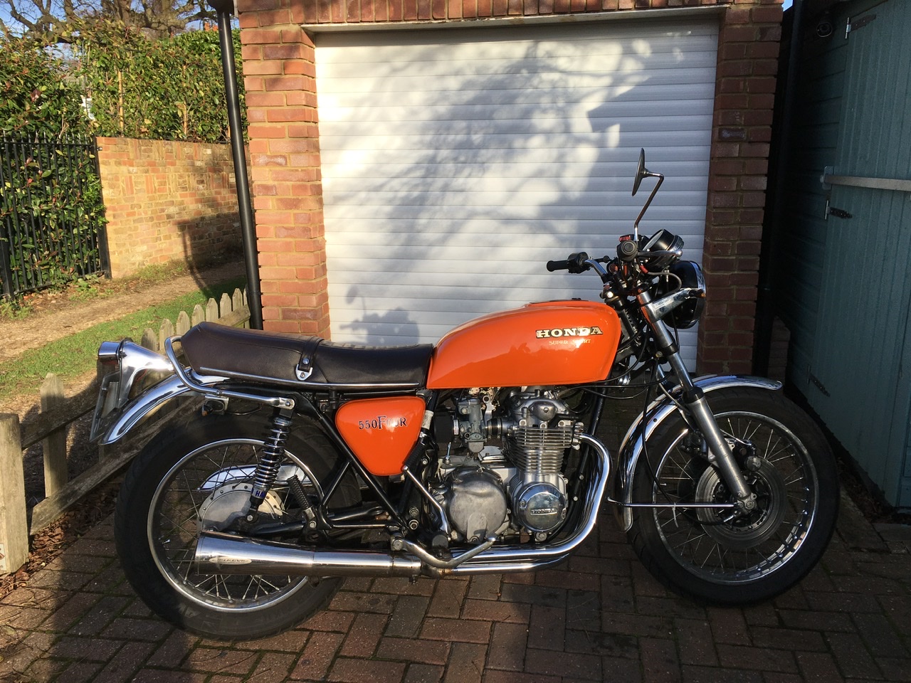

Small update, Scruffy has new Hagon adjustable rear shocks, with matching progressive fork springs.
seems to handle well but i do need to tune the suspension for my usage style, mainlynlocal cafe rides and country blasts.
Next it’s head off for 600cc conversion, and then proper tuning of the carbs etc.
i’m loving Scruffy, really nice to ride, looks good and a real contrast with my other bikes.

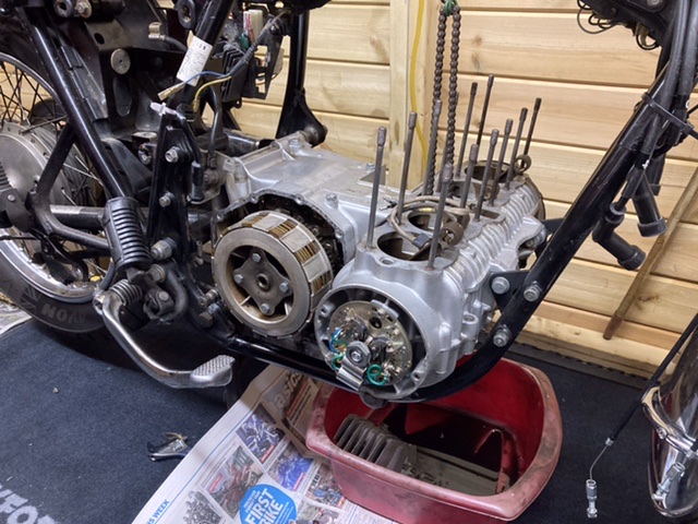

Project Scruffy Racer enters Phase III - Go Big !
have a set of +3mm pistons to take motor out to 600cc, and today started stripping down the bike ready to take the head off.
this bike came to me siezed solid, with burned out electrics and literally nothing working......Phase I was to get it running, Phase II to make it look and handle ok, so it’ll be interesting to see the state of the bores/pistons/valves.
here’s where we are after a morning in the workshop :)
i’m hoping to get the head in for boring this week, if the engineers are working
does anyone have advice on any worthwhile mods to the head whilst it’s off?
steve

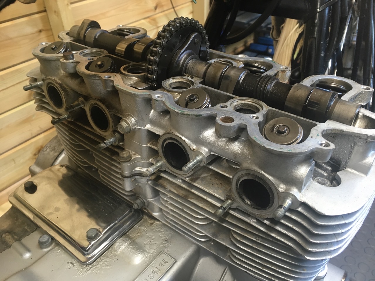

Engine came apart pretty well
head pulled off easily after a gentle tap or two with rubber hammer
barrels needed gentle prying in the thoughtfully provided slots
head all rebuilt now and barrels are at the engineers for boring out
+3mm pistons look quite a bit bigger than stock!
