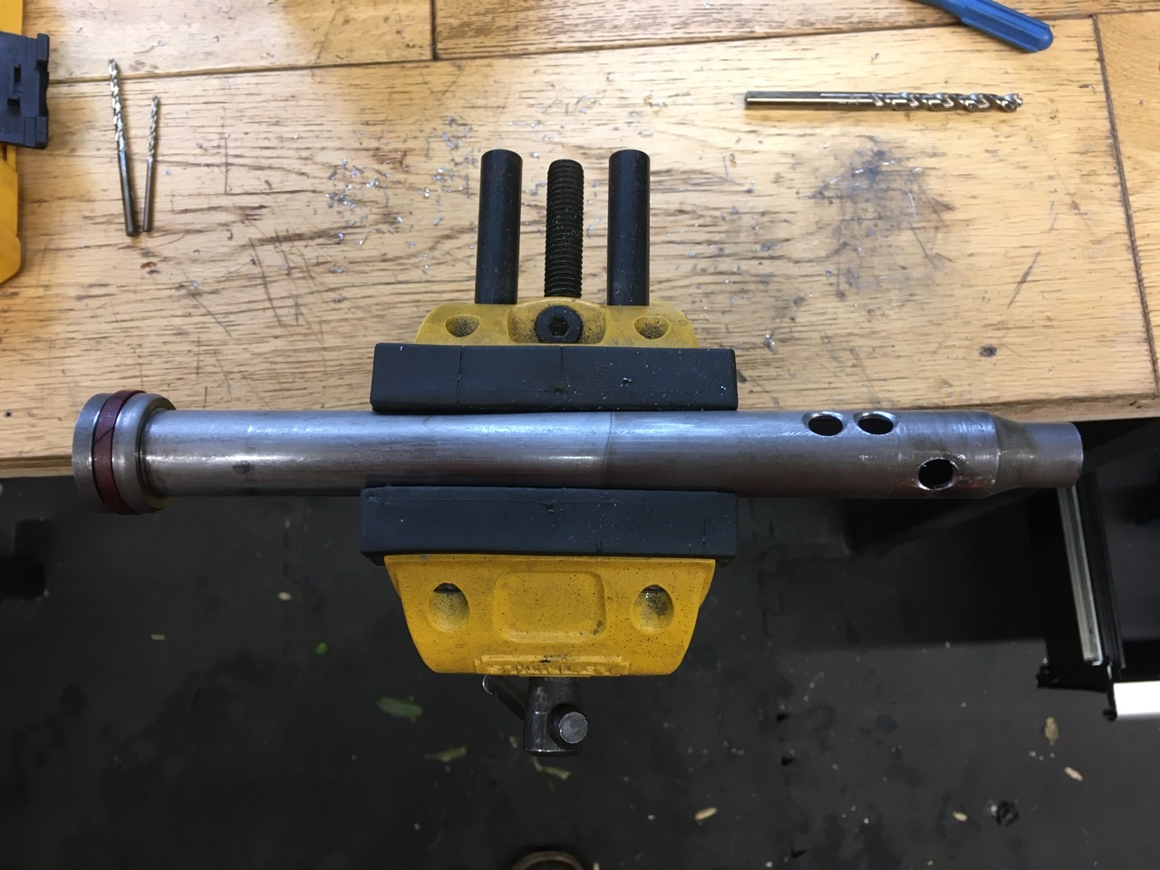

Yss emulators arrived on a cold wet day, so heating on in the workshop and fitted them
the only ‘difficult’ part is drilling additional holes in the damper rods.
instructions called for a total of four 8mm holes
original configuration was four 5mm holes, but these were quute close together so i wasnt happy opening them up to 8mm
i calculated that 6 6,5mm holes had almost exactly the same area as four 8mm ones, so thats what i went for.
reassembled easily, just need some dryish roads for testing :)

tested the bike today and a bit underwhelmed.
initially there was very little change, but i realised that two of my new holes would be covered by the ‘foot’ so i added two addition 6.5mm holes higher up.
this did seem to improve the harshness somewhat, but not as much as i had hoped.
i’m using 12.5w oil so might try 7.5 or 10, but didnt have enough in the garage.
any thoughts from anyone who has used these emulators before ?
