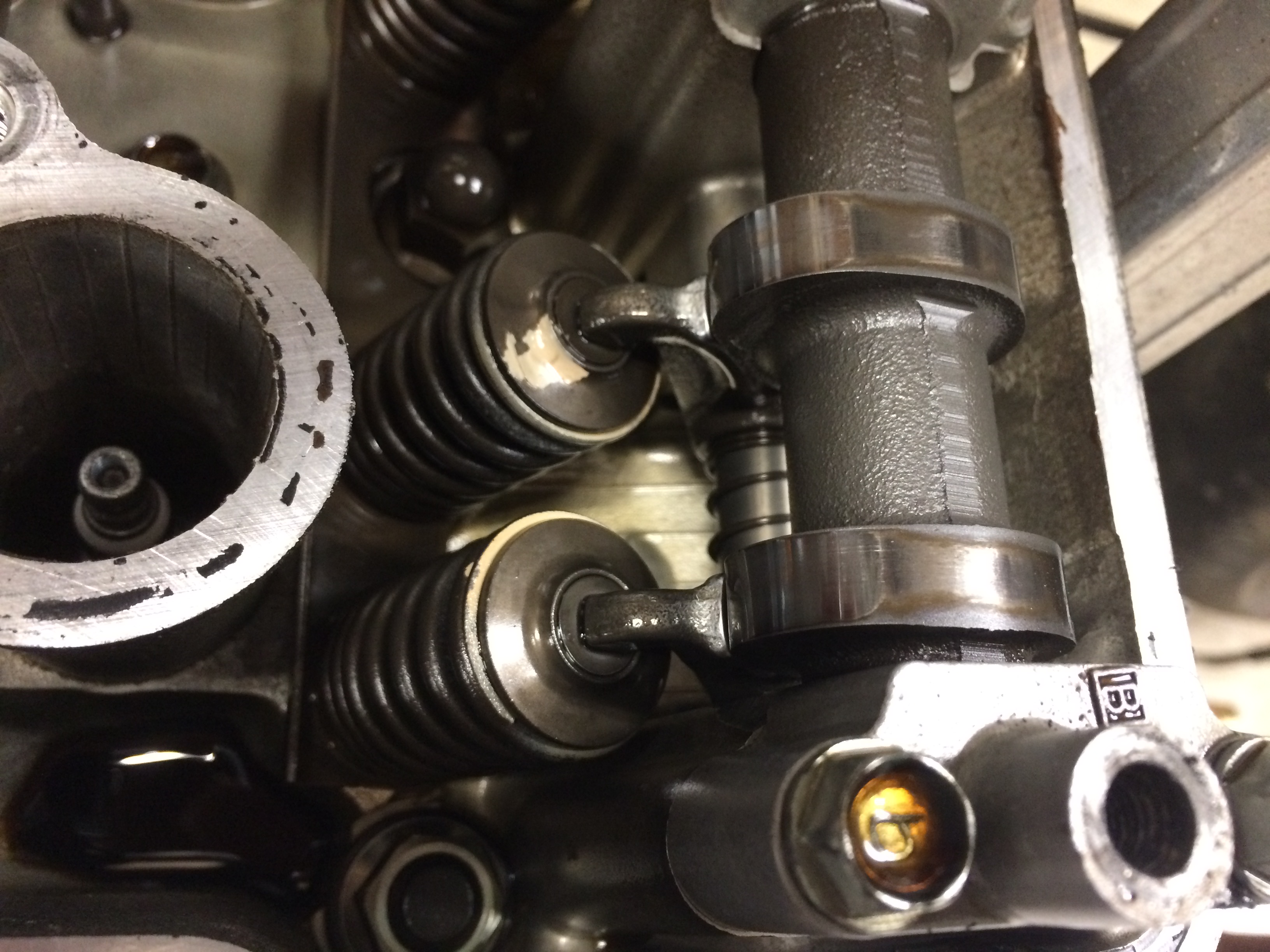

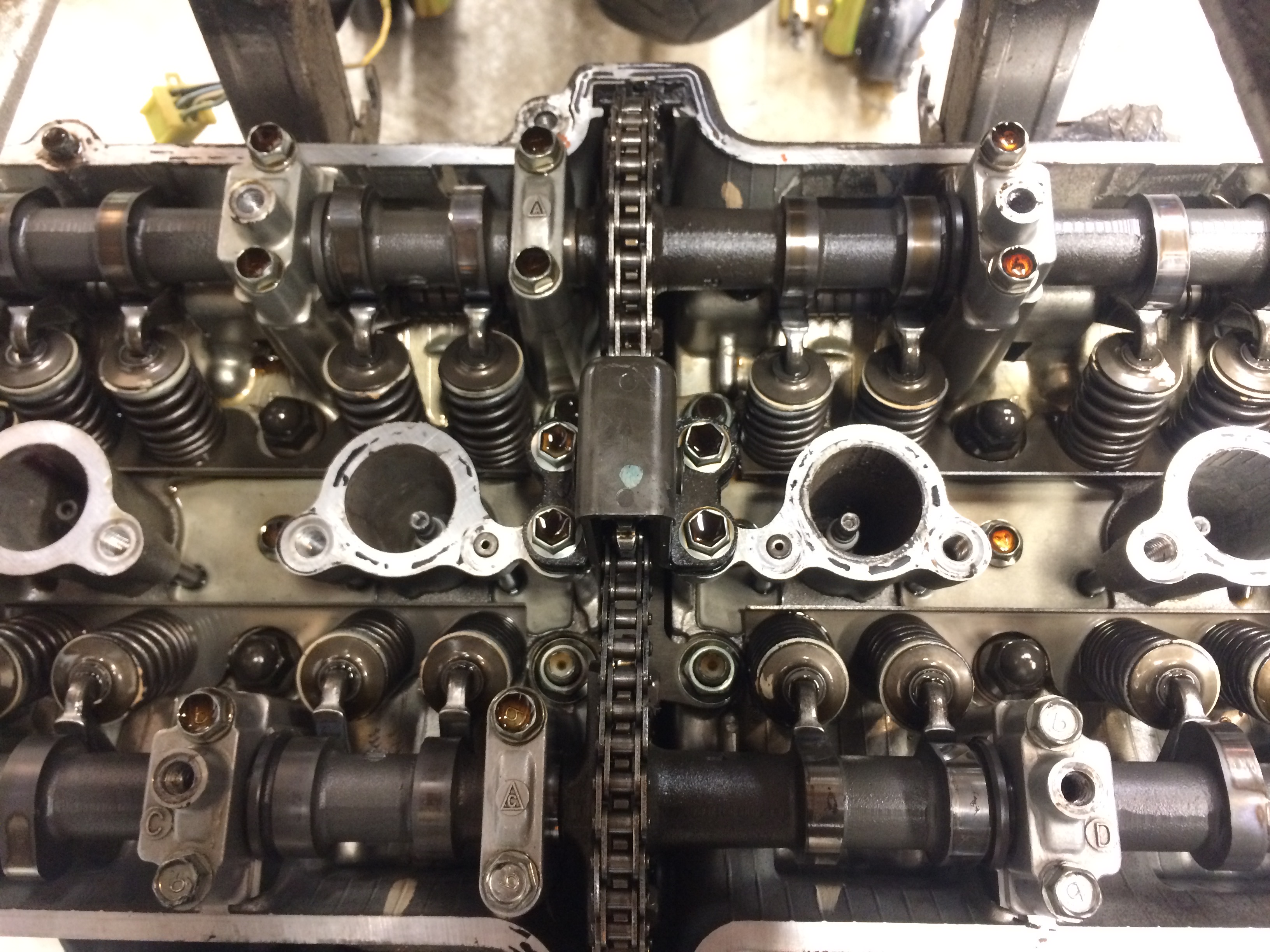

Well i finally have some time to work on this. I wanted to check the compression, but my compression tester died on the second cylinder, I did pull the valve cover to discover....shims? 86 should have adjuster screws. I think its a 91-92 based off the Engine VIN. (R716-120195) I started pulling things off as literally everything on this bike needs attention. Its a rolling basket case.

That's a better setup than the earlier screw adjuster type. Those shims will be easy to measure and swap. Cool!
Also good for an additional 16hp!

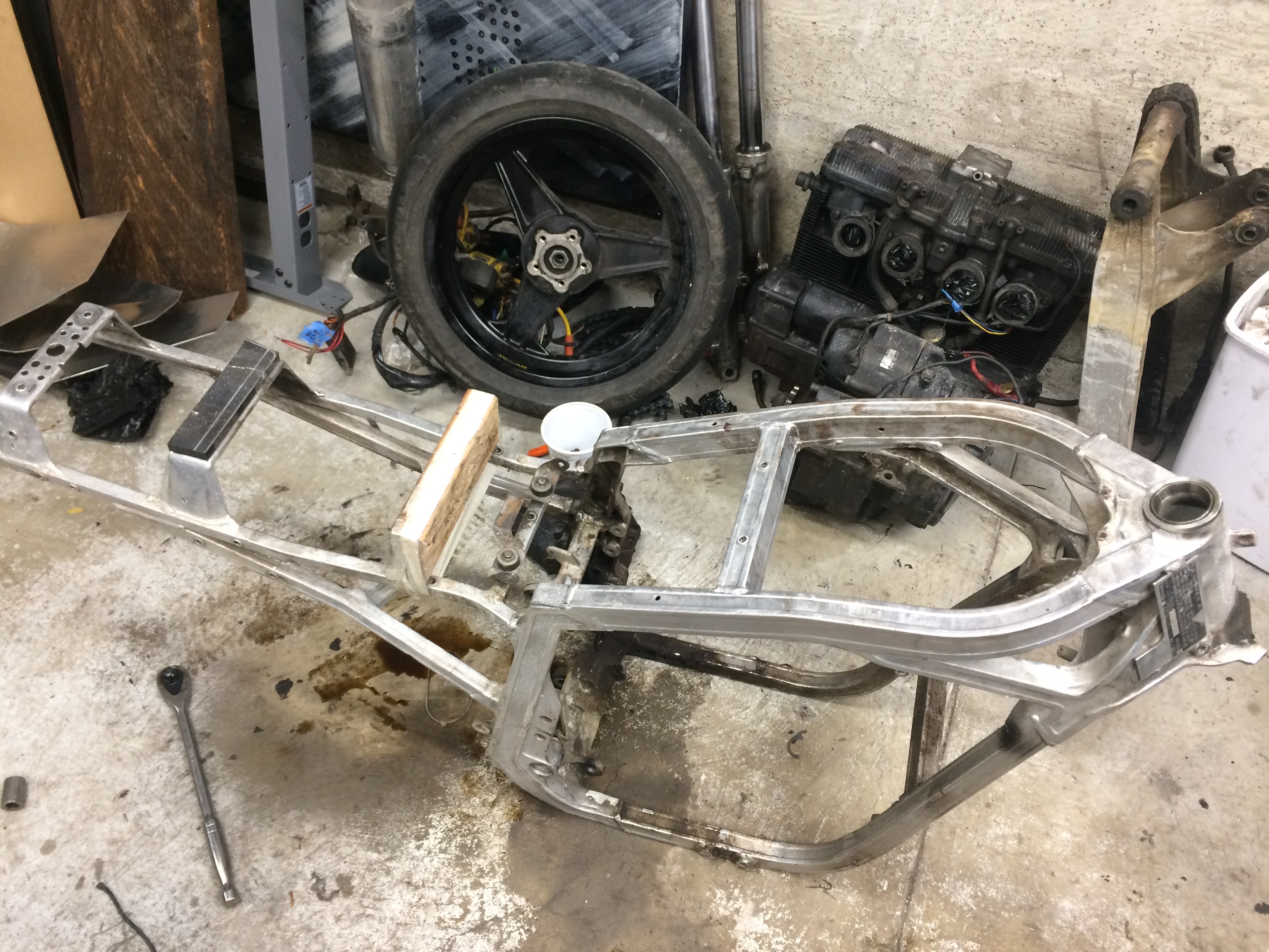

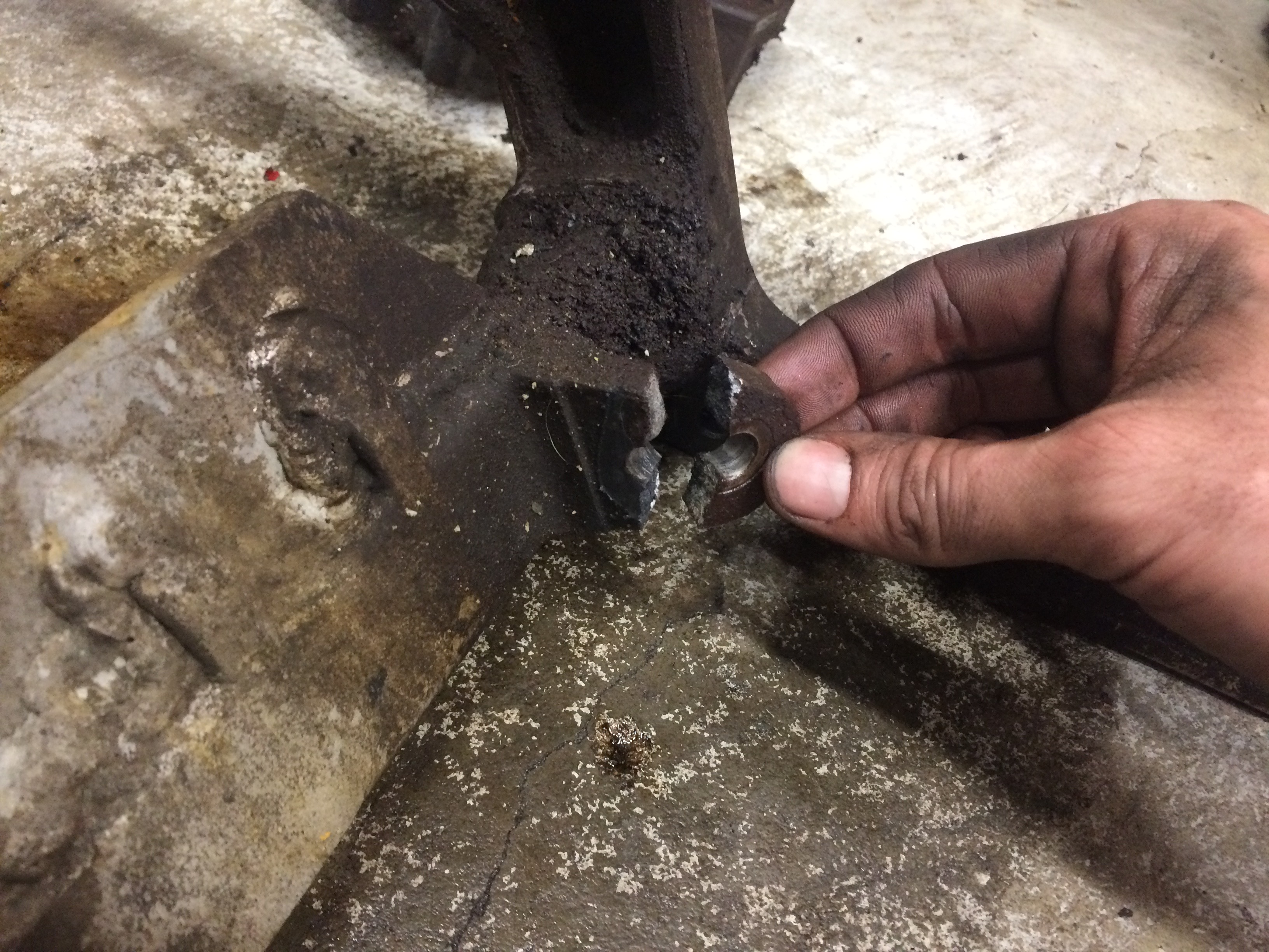

I have met a large debacle. I initially wasn't going to pull the motor, but the previous owner resprayed the it at one time and did a piss poor job of it. There is over-spray all over the frame and swing-arm, and the paint on the motor is flaking off badly. I pulled the engine to clean the frame properly and repaint the motor but while doing so I discovered one of the engine mount lugs on the frame has sheared off.
Im feeling like i should cut and run. There's too much ham-fisted stupid shit going on here. Its all parted out and ready to go, I could probably recoup my cost and then some based off the unusual parts.
Or.....
I could continue on. I have a friend who is more than qualified to repair this frame, and he'll probably do it for a 6 pack. Hell, I may even have him do some frame bracing while he's at it.
My concern is i'm gonna ride it, not like it, and want to sell it after putting a bunch of hard work into it.(been there done that) What is one of these worth if it was clean and everything had been gone through, with almost no original parts? $2000? (Bay area prices)

I feel your pain. it is decision time.... Looks like a lot of work to make nice, how healthy is the motor. Judging by the rest of the bike probably not good
As I see it, not much is stock - motor is a later Slingshot, rear wheel isn't stock, front wheel is a Dymag - OMG that wheel is worth a fortune - no it's not - I will swap it for a something more suitable at no cost to you.......
Any sign that the bike had been raced? Bolts drilled for lockwire etc? Or is it just a mongrel?
Point is that it will never be 100% original but could be a fun bike and yes it will take time to rebuild and if you don't like it, someone will get a great bike to ride. I cannot tell you how many bikes I have built over the years and sold almost immediately because I already lost interest in them. You do not want to become me, but this one could be a fun project to build and resurrect.
I would plow on on an build it as a endurance racer look or other slightly customized look and get your cash back and have some fun building an updated slabbie maybe with newer USD forks.
Build it quick as a low buck racer, fix the frame, clean it up a little, bolt it back together and get it running. You can minimize your time and $ investment and still come out with a bike that will be alot of fun to ride and should still sell easily enough if it's not your thing in the end. My .02. fwiw
I just got off the phone with my buddy that will do the welding. He love the early GSXRs so maybe not the most un-biased opinion. he has convinced me to build it and do some frame bracing, while the repair is being done. I'm now looking for a junk frame to cut up and brace this frame with like the factory racers
I dunno if i'm going to go this crazy but i'm entertaining the idea.

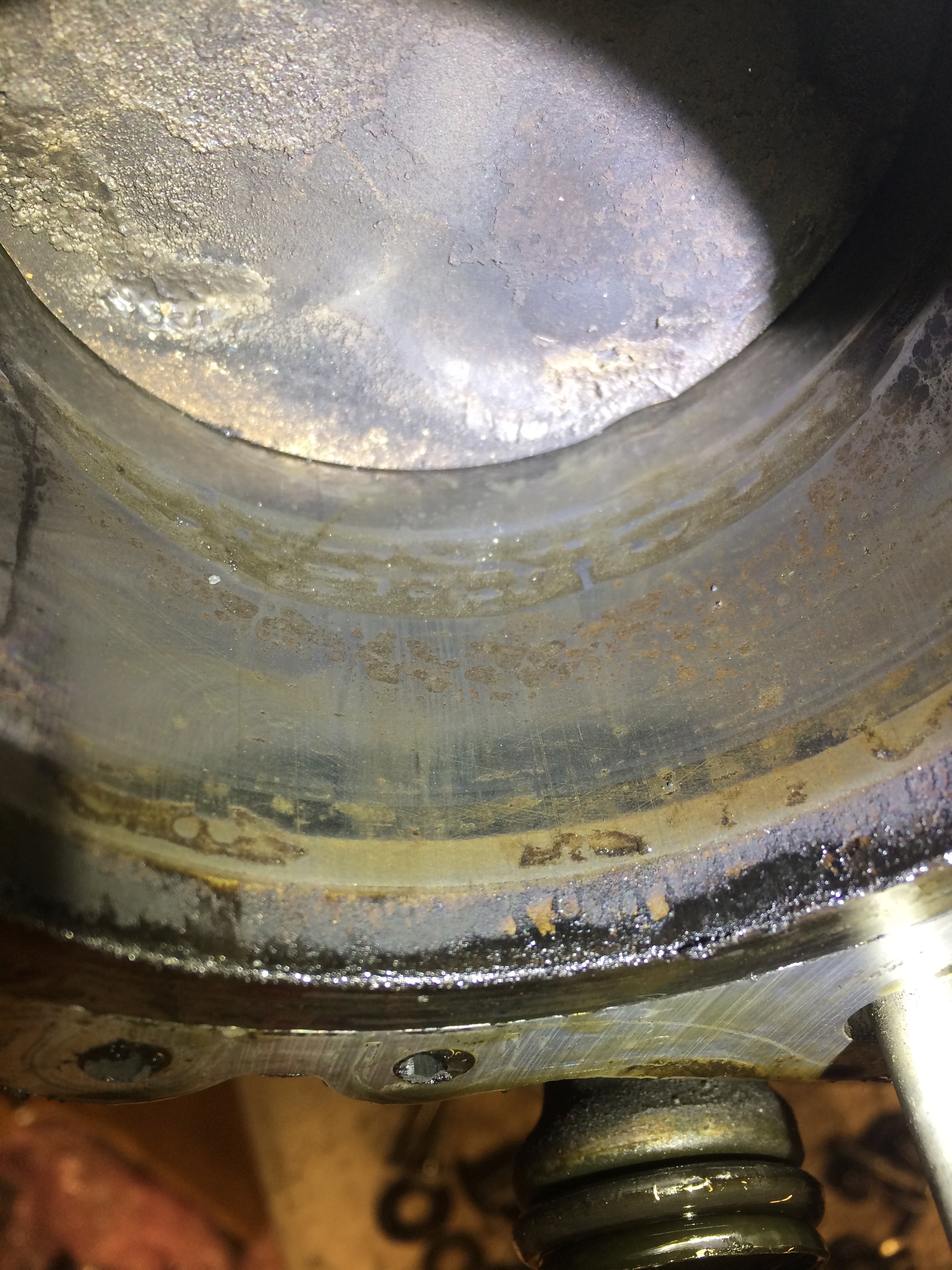

Here is the straw that broke the Gixxers back. Definitely wont be able to keep it under $1000 if i decide to proceed. Dirtbag's part out bikes, they don't rebuild motors. gonna think on it a while before i decide what to do.
Well after thinking about it for a bit, I have decided to proceed. I'm too excited by the potential end result. There's no way I'm going to make my purposed $1000 budget, but if i can keep it under $2000 id be happy. I have started looking for a deal on a 1100 engine, but no luck yet.
