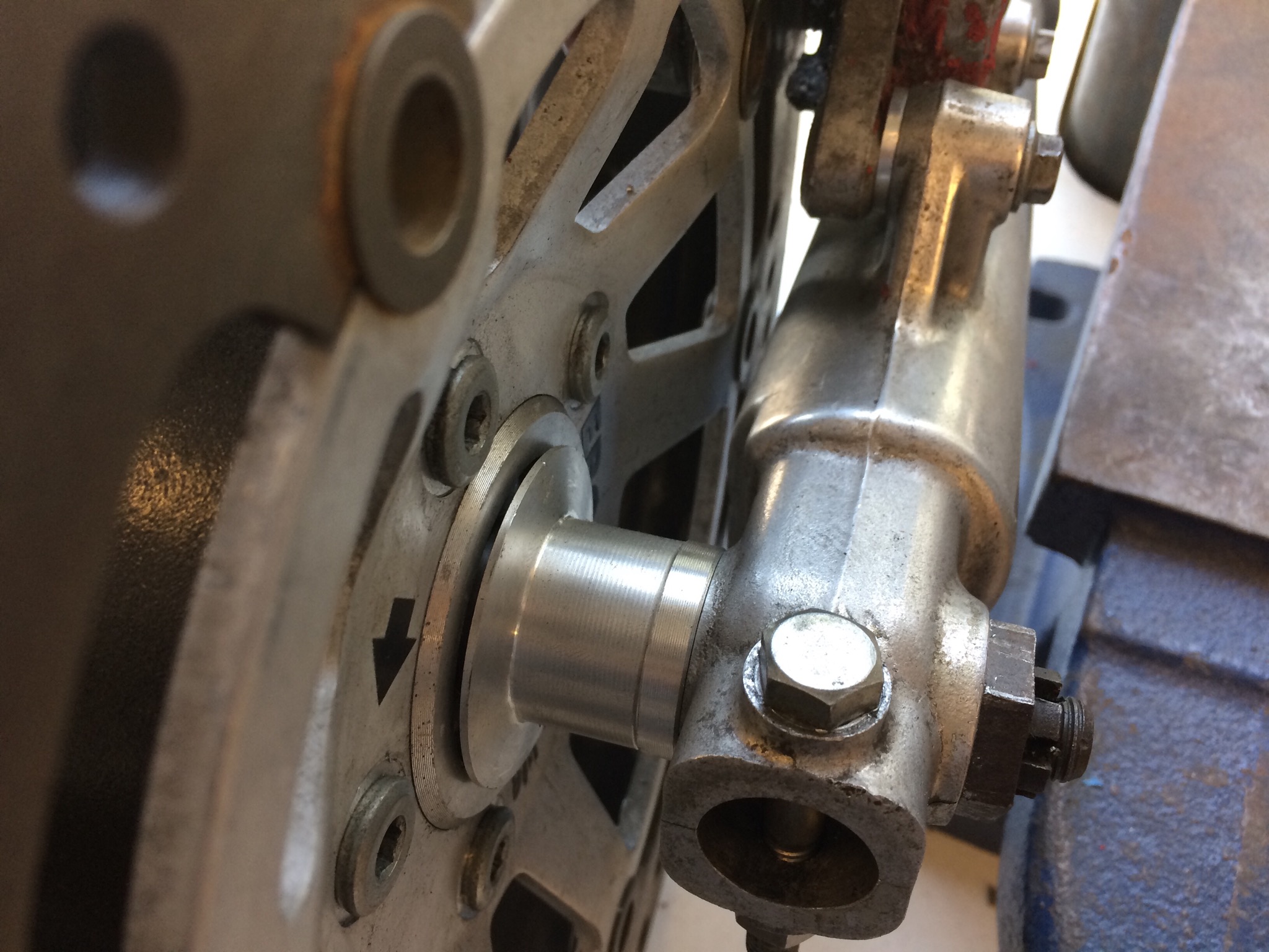

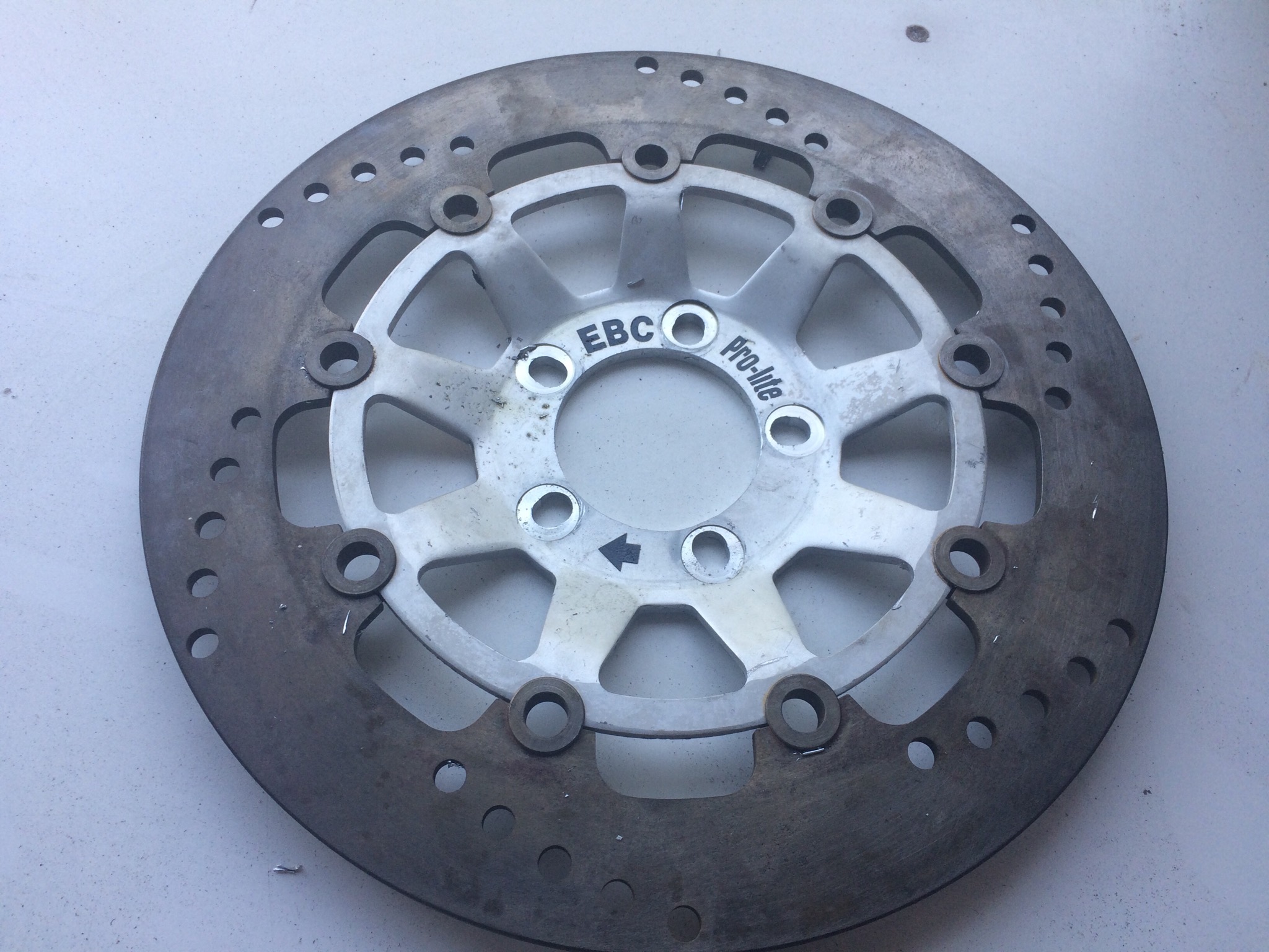

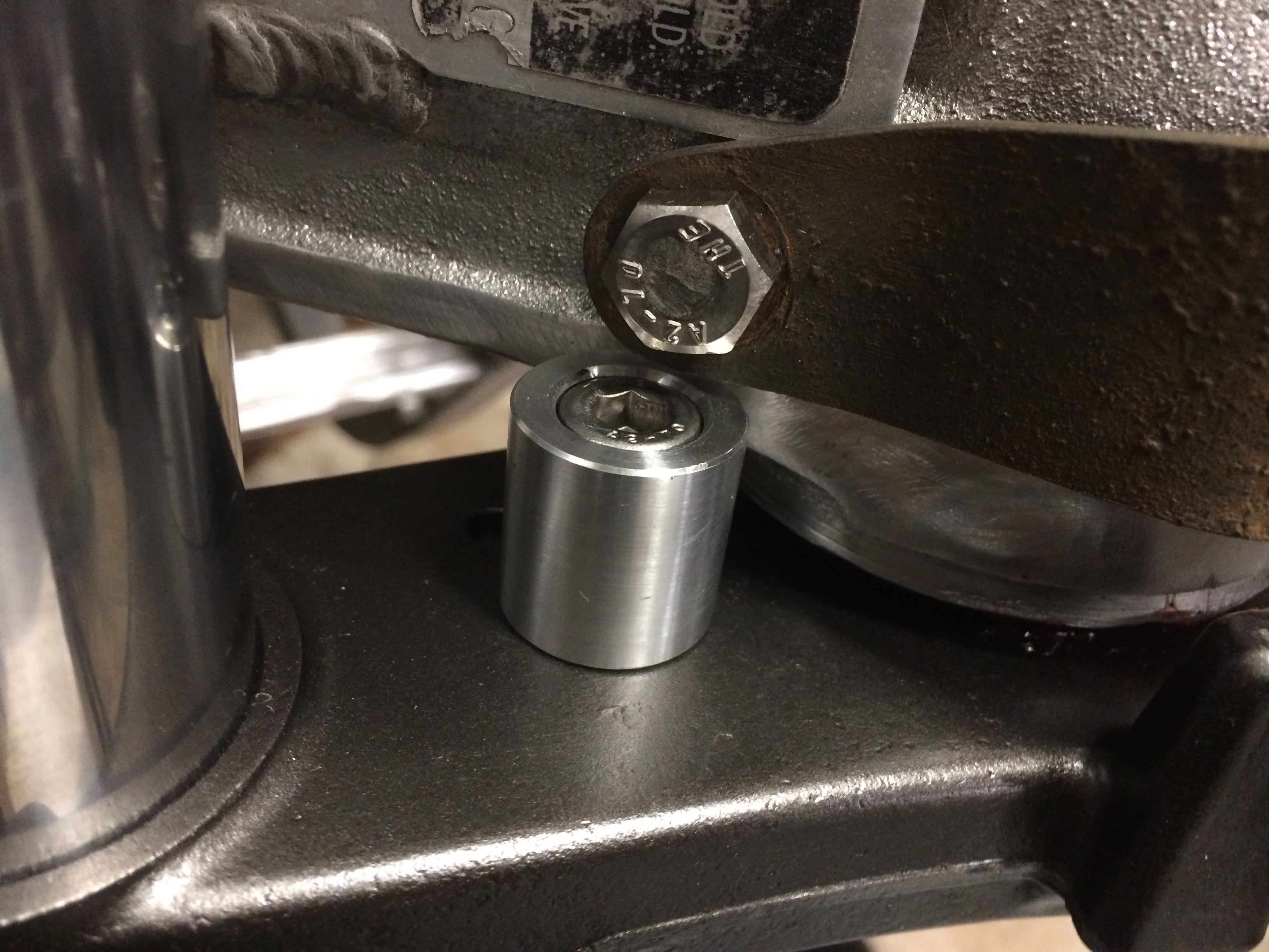

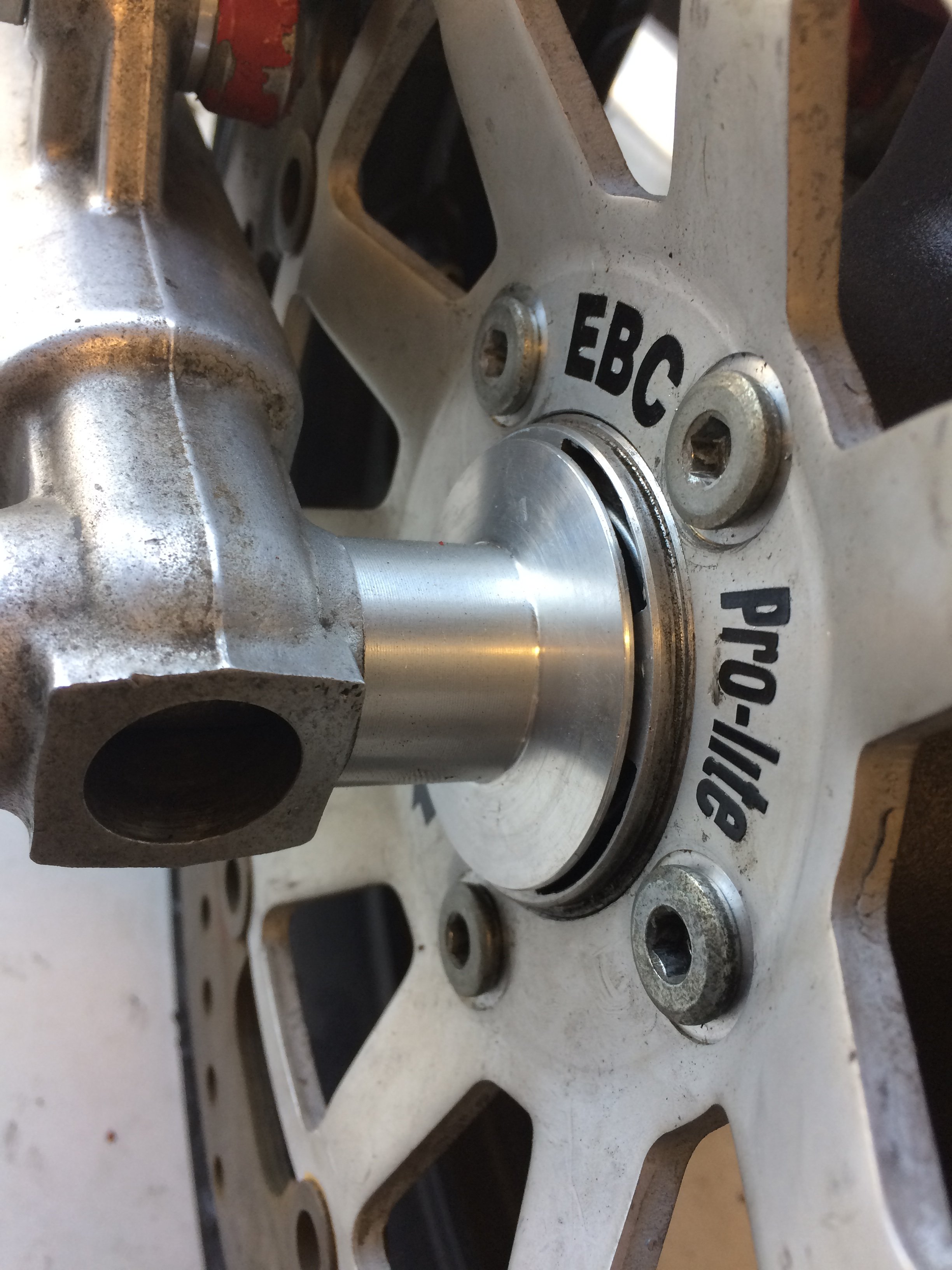

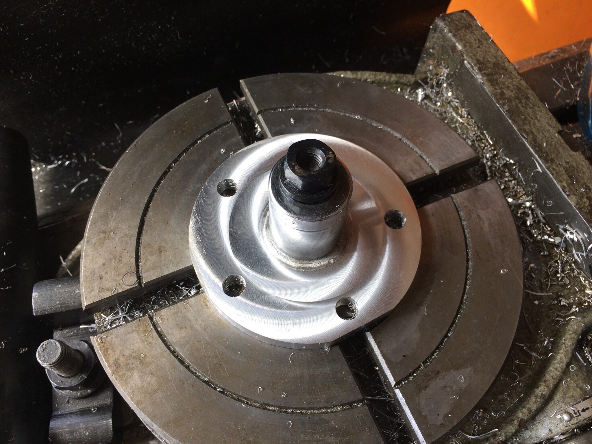

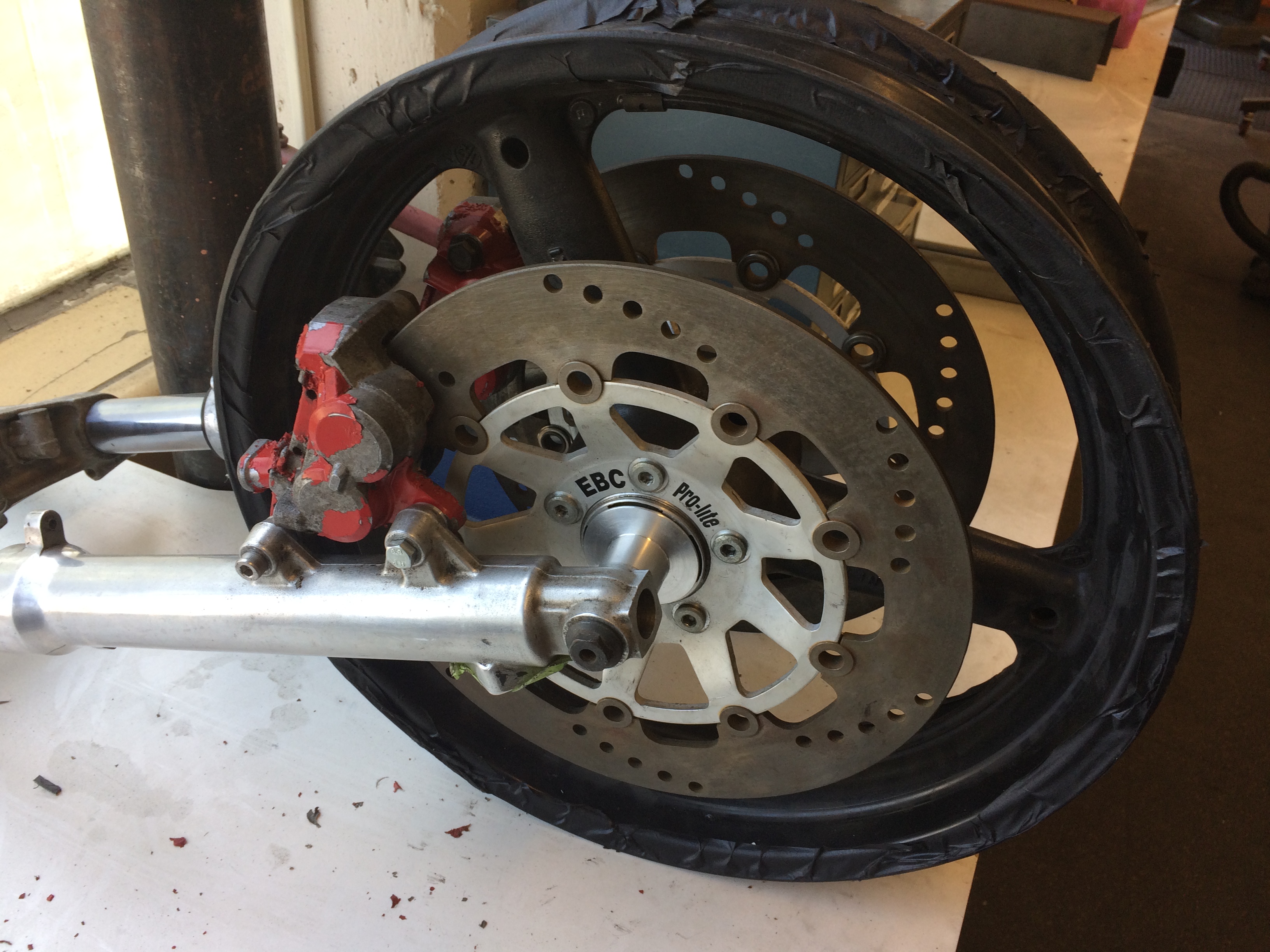

front end sorted out. Took a bit more machining than I hoped for but it all came together. I used the bandit wheels, ebc rotors and original calipers. The rotors needed a bigger PCD, and the ID opened up to fit the bandit wheels. The calipers needed a small washer to center them on the disk, and since I was missing a wheel spacer, I decided to make them all from scratch and delete the speedo drive while I was at it.

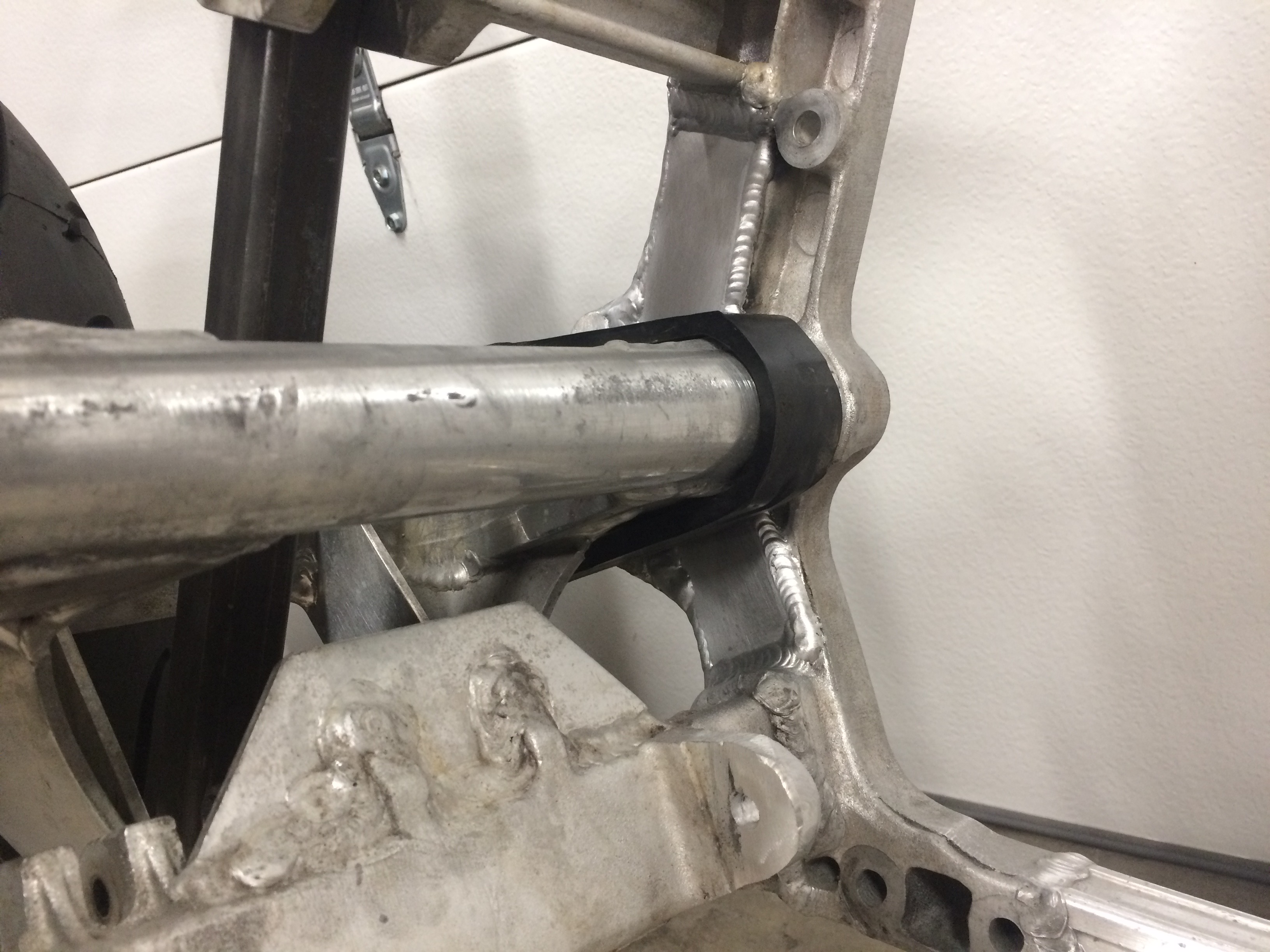

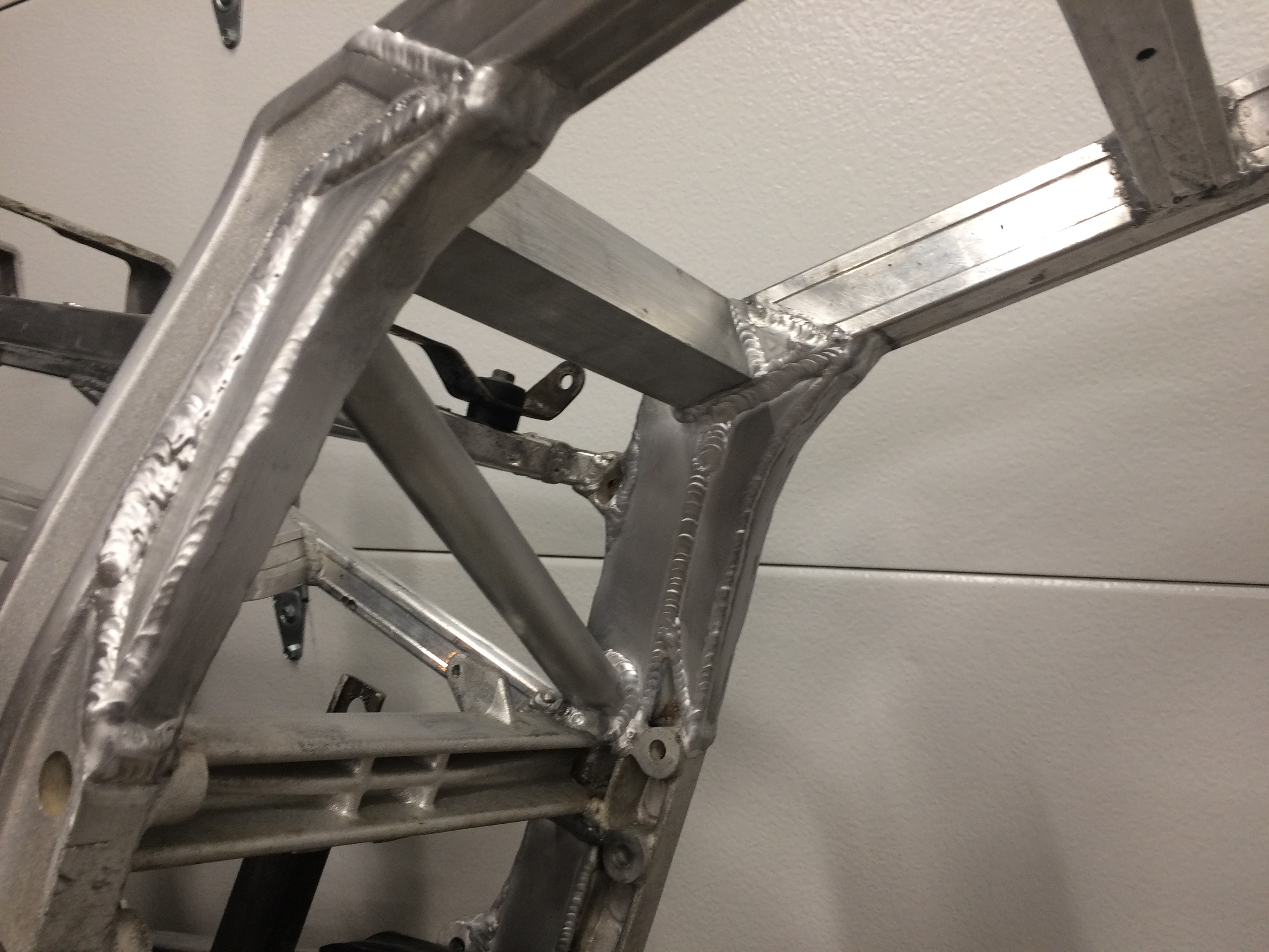

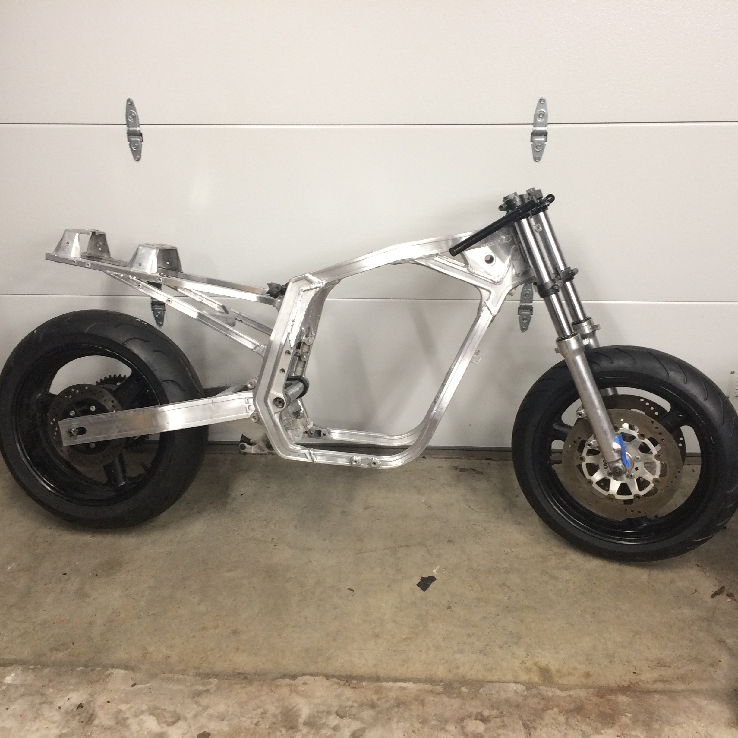

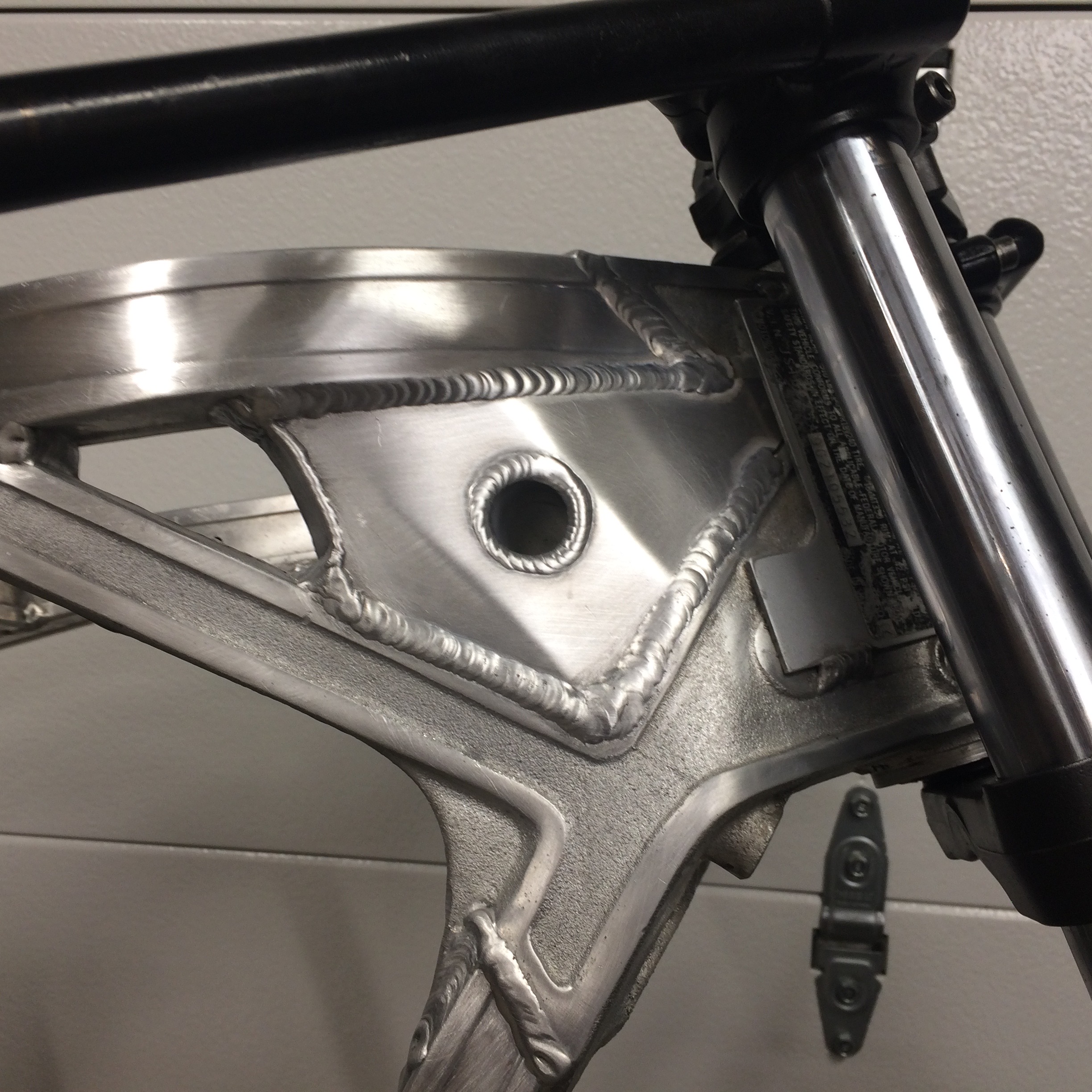

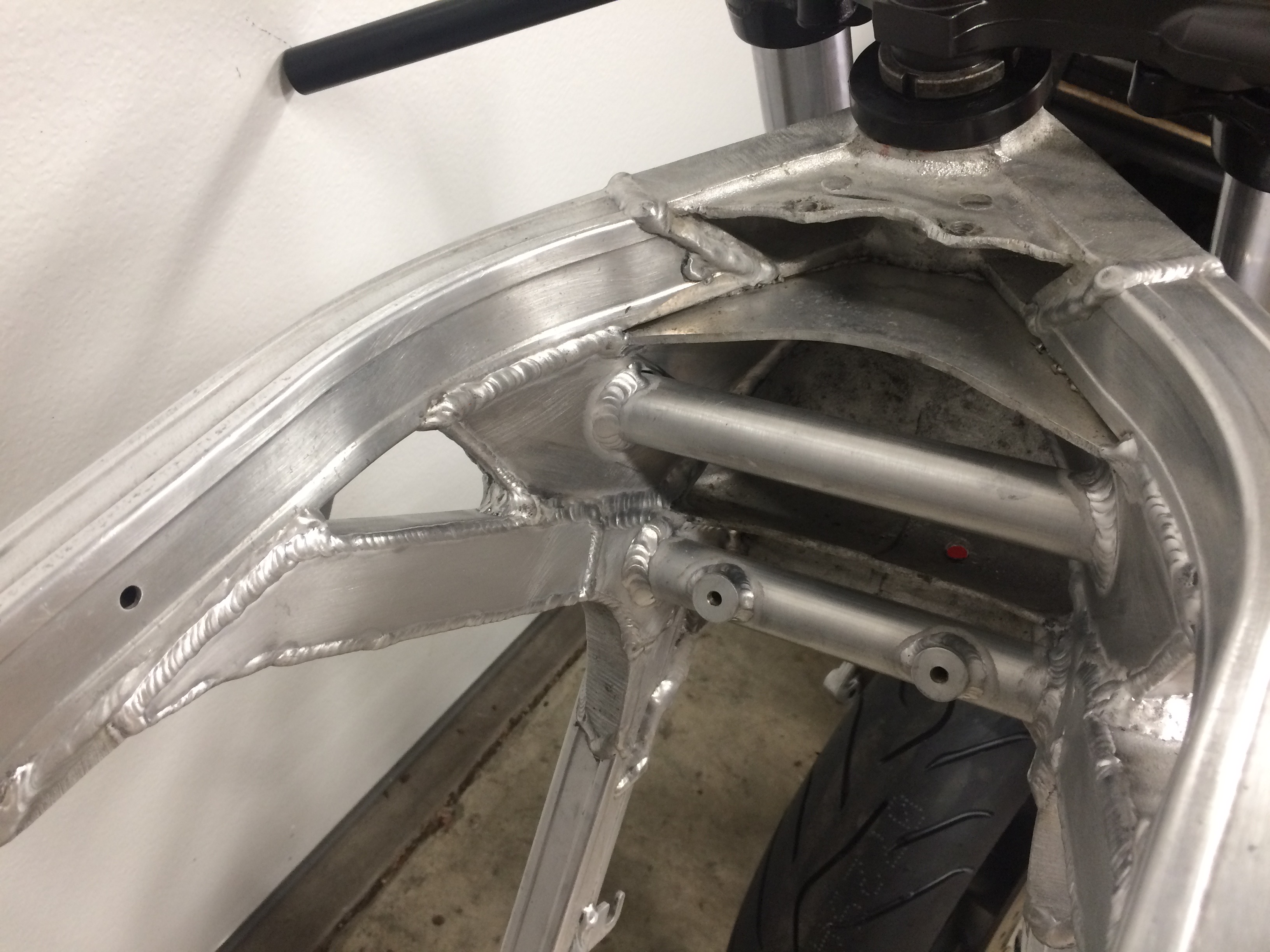

the frame has been boxed in and braced. The broken motor mount is repaired. This frame is a proprietary alloy that is basically 7005. I used 6061 for the braces and 5556 filler rod. The castings were difficult to weld, twice I had something in the casting explode and pop molten aluminum out at me. I want to brace the swingarm as well, but I'm going to wait till its on the road so I can do a comparison. I painted the triple trees with gun kote and installed new bearings. I went through all the bearings in the rear end and cleaned them out and packed with new grease. Its rolling again, sitting on Metzler Sportec M3, which i spooned on sweating it out on the garage floor(I'm a Luddite when it comes to tire machines). Never ridden a metzler tire before, excited to try them out. I'm still on the hunt for an engine.

I know nothing about aluminum welding (very little about steel welding). But, as a GoldWing rider, welding extrusions to castings all with different alloys is a bit scary. It took Honda until 2005 (building 2006 models) to finally get theirs right.

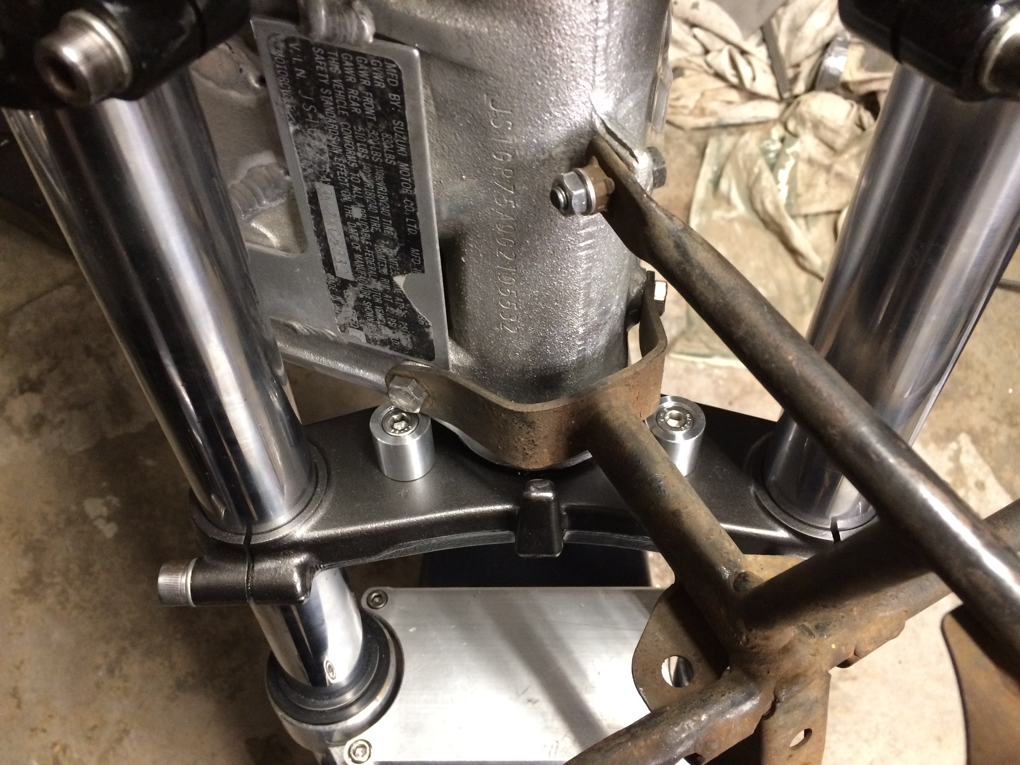

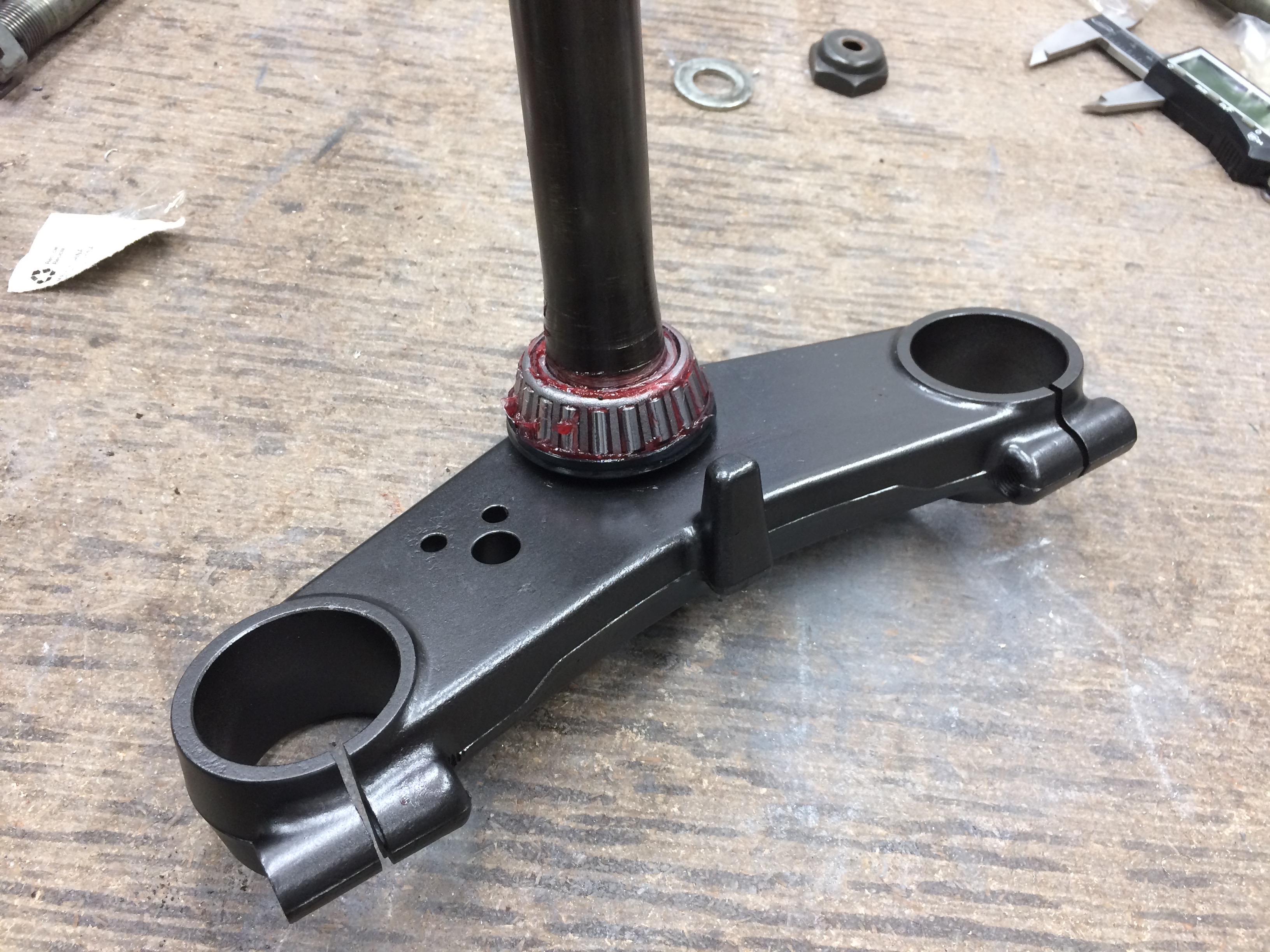

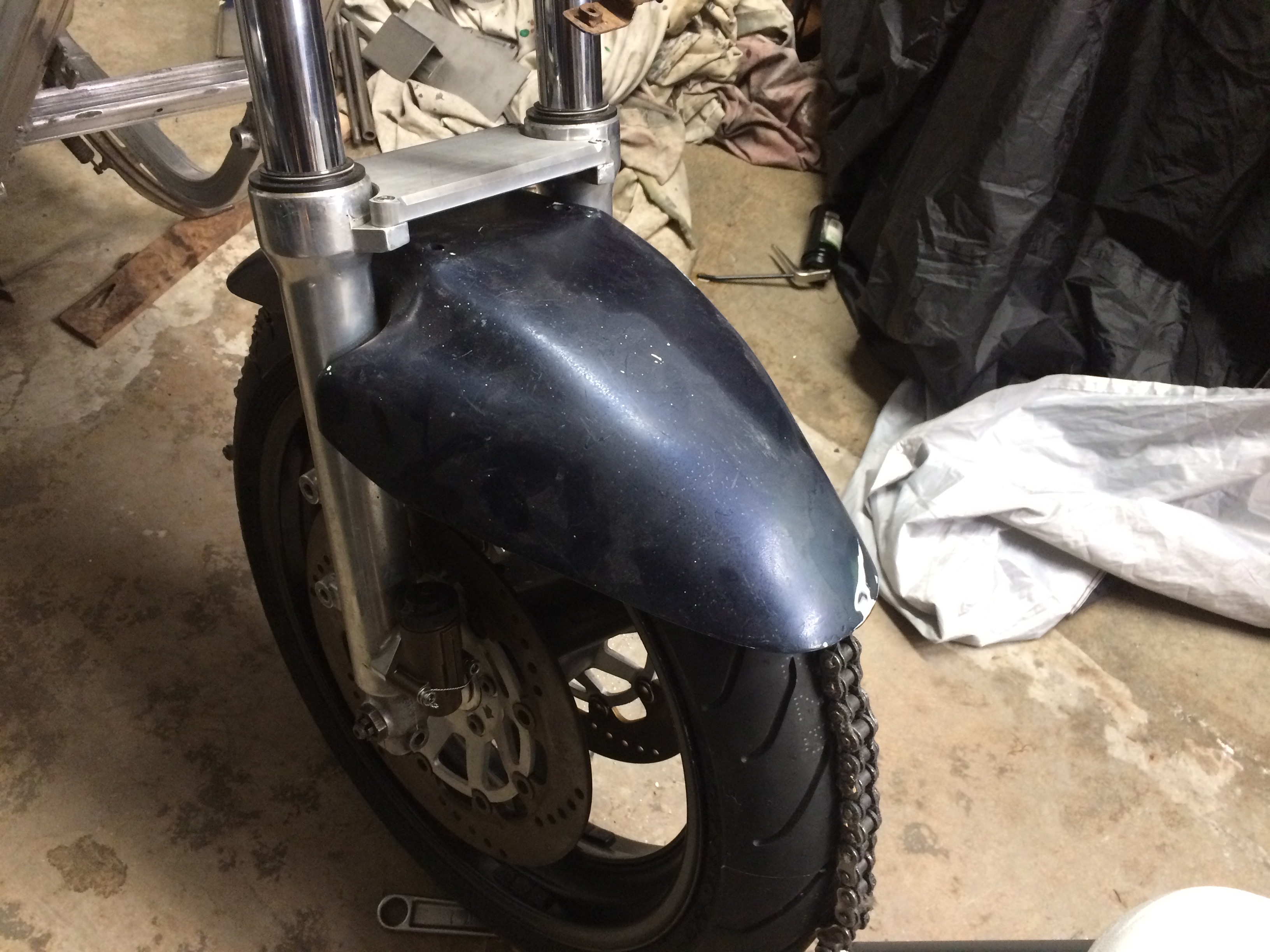

The old steer stops were broken off so I turned some bushings and bolted them to the lower triple. i also started on a fork brace/fender mount for the late model fender. Not sure how I will mount the fender and whittle the brace down yet.

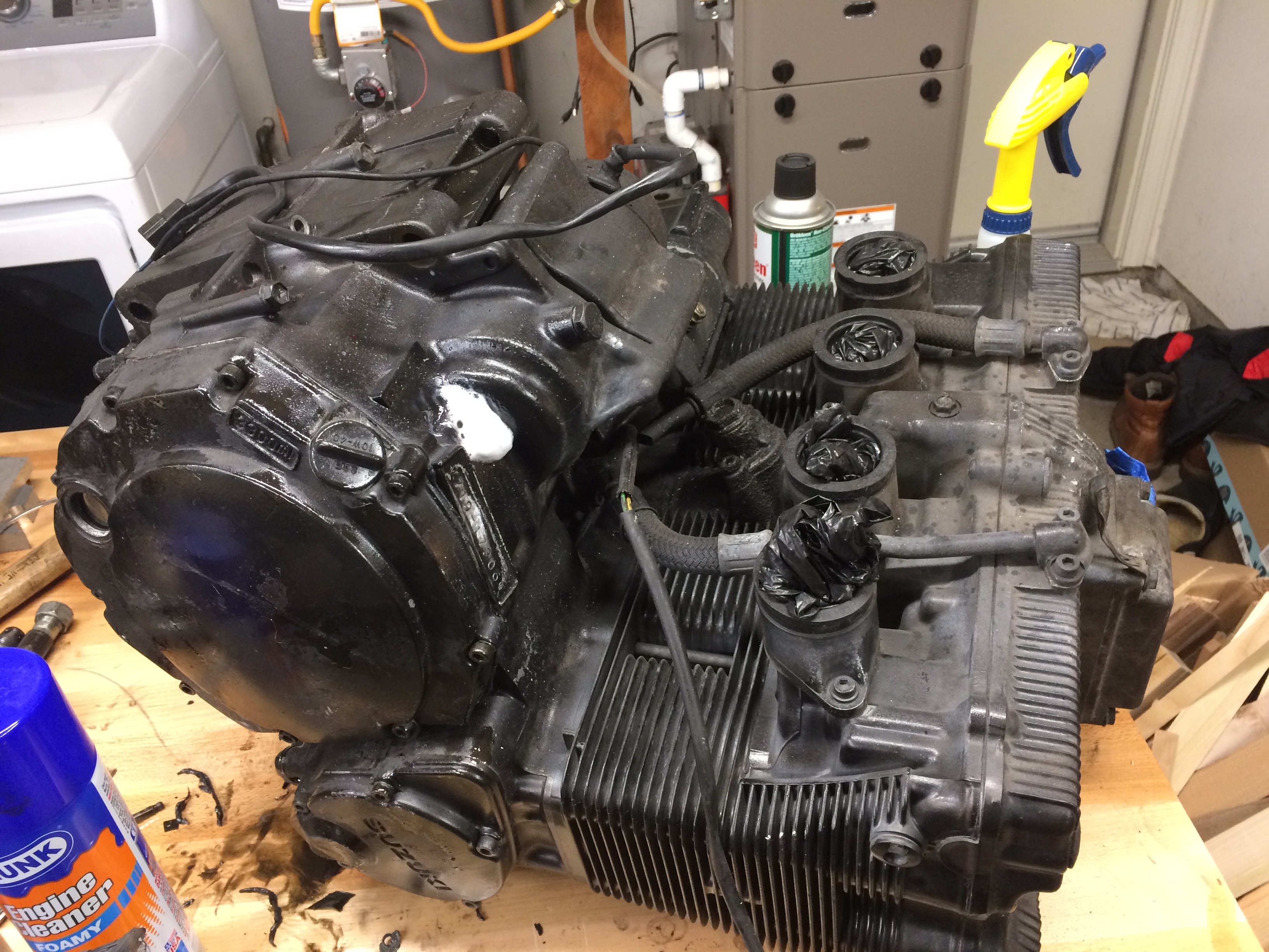

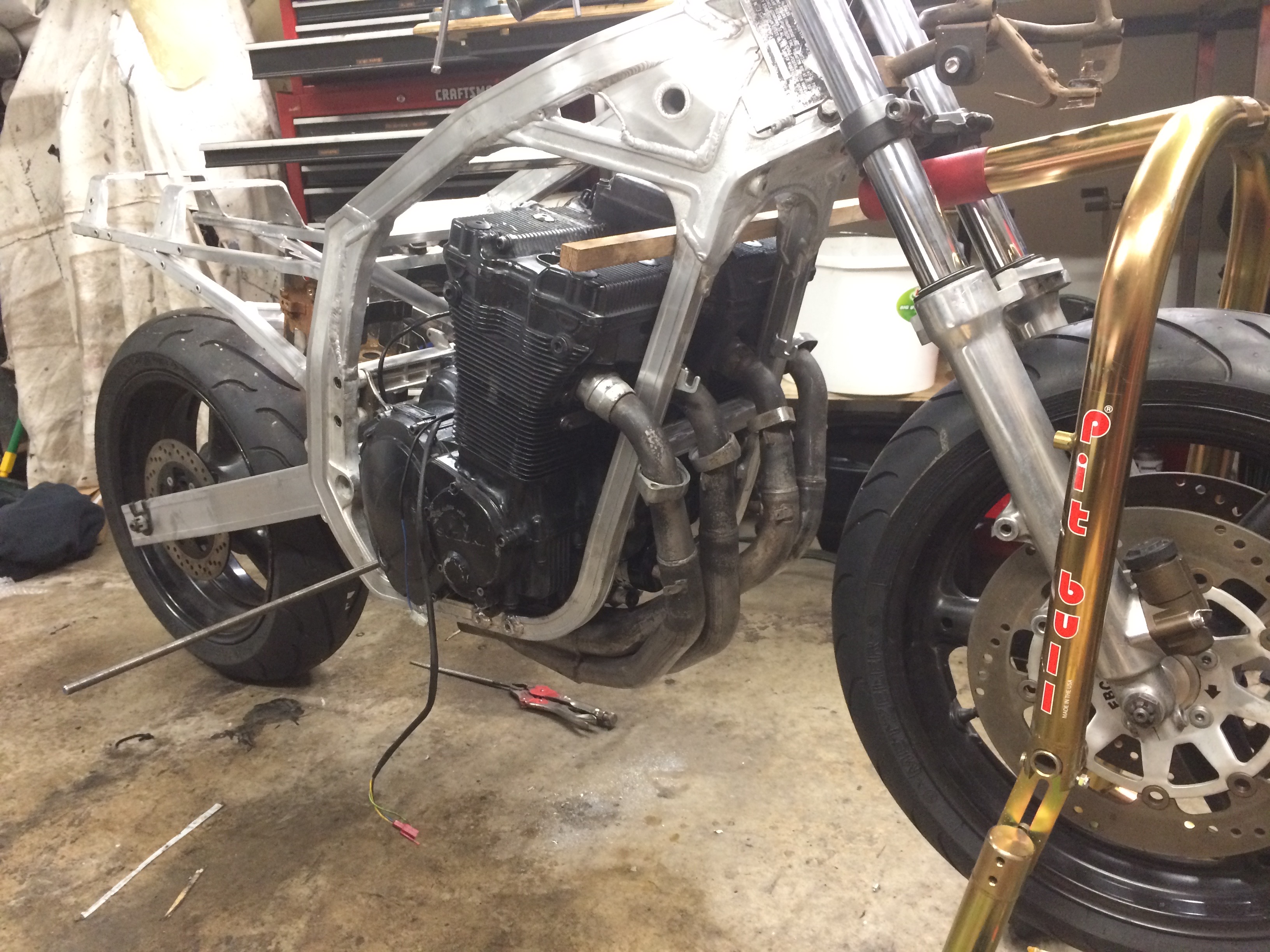

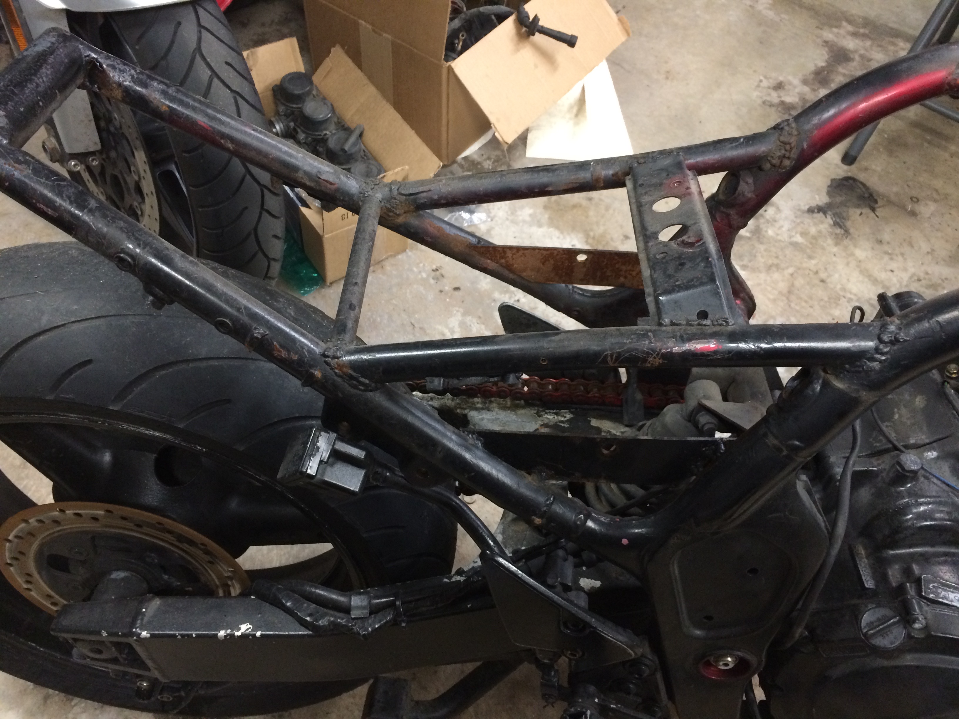

I found a Bandit 1200 to use as a donor. I probably paid a little too much for it considering what a turd this thing was; no title, booger welds galore, loads of hacked parts. I was hoping to part out what I didn't need and recoup some cost but aside from what I need there isn't anything else really to sell off. The engine fired up and sounded OK. needs a clutch bad. It was pretty greasy so i hosed it down with Gunk it and cleaned it up a bit. The 1200 engine slid right into the 750 frame after I took the valve cover and a cam cap, There is loads of room to remove the valve cover to check clearances. I need to sort out the motor mounts, I'm wondering if i should oversize the mounting bolts to remove the slop.

The Bandit is, umm, interesting. I had a B6 with a B12 engine shoe-horned in it about 7-8 years ago. Fun bike power-wise but someone along the line put a VFR SSSA on it and messed up the rear geometry some. Never did sort the right shock for it before I sold it.
Anyways, I’ve heard that the Bandits and Gsxr’s use either 10mm or 12mm hardware for the same engine mount depending on model and year. I’d go with bigger bolts to take up the slop.
Later, Doug
the bottom rear motor mount is 12mm on the B12 instead of 10 on the GSXR 750. I'm thinking about changing all the bolts up to the next imperial size to remove the factory slop, so 1/2" where 12mm is used. 7/16" where 10mm is used and 3/8" where 8mm is used. It should help tie the engine and frame together better, but i dont know if its worth the hassle. This engine appears to be stock so, all i'm going to do is get an ignition advance, jet kit, and build free flowing pipe and this engine should be making around 120hp.
