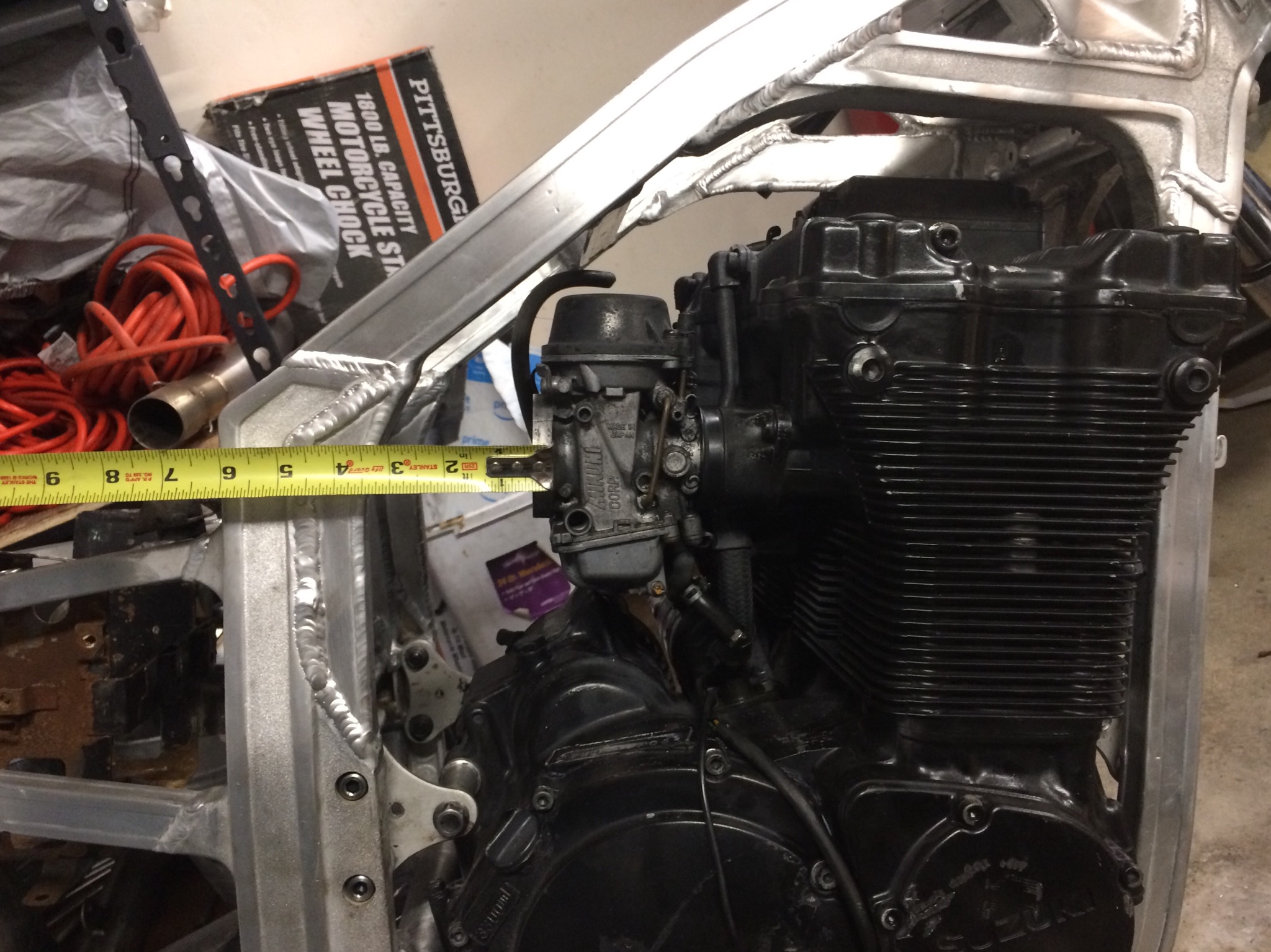

Good news is the engine is bolted in. I had to make 1 custom bolt but used stock for everything else. Bad news is through my ingenious frame bracing I have painted myself into a corner. I’m going to use the stock bandit carbs but there is little room for an air filter. Suggestions?

Well insulated plenum on top of motor and ram air scoops out the front ;) If you don't have 43mm forks use the Bandit ones. Check the wheels as well, they may be 1/4"~1/2" wider than what your using. Either way, Bandit forks are worth a few hundred bucks to fit on older GS 1000~1100, as are the wheels as an upgrade
I like the ram scoop idea.... I think I will make a plenum with a big filter under the gas tank as it will be the easiest route to get this bike on the road.
I already am using bandit wheels, with the stock GSXR forks. the forks I have are freshly rebuilt and ready to go so I'm going to use those right now. The ones that came on the donor are pitted and have road rash.
can anybody point me to info on building a functional airbox, intake size calculators etc...?

So it looks like K&N can make me a custom filter for a reasonable price. The recommended filter length is 3" I would go to 2.25" which is a 30% reduction in filter surface area. The end of the pod would only be 2" from the bell mouth. Im worried this wouldn't flow correctly. how much space do you need from the end of the pod to the bell-mouth?

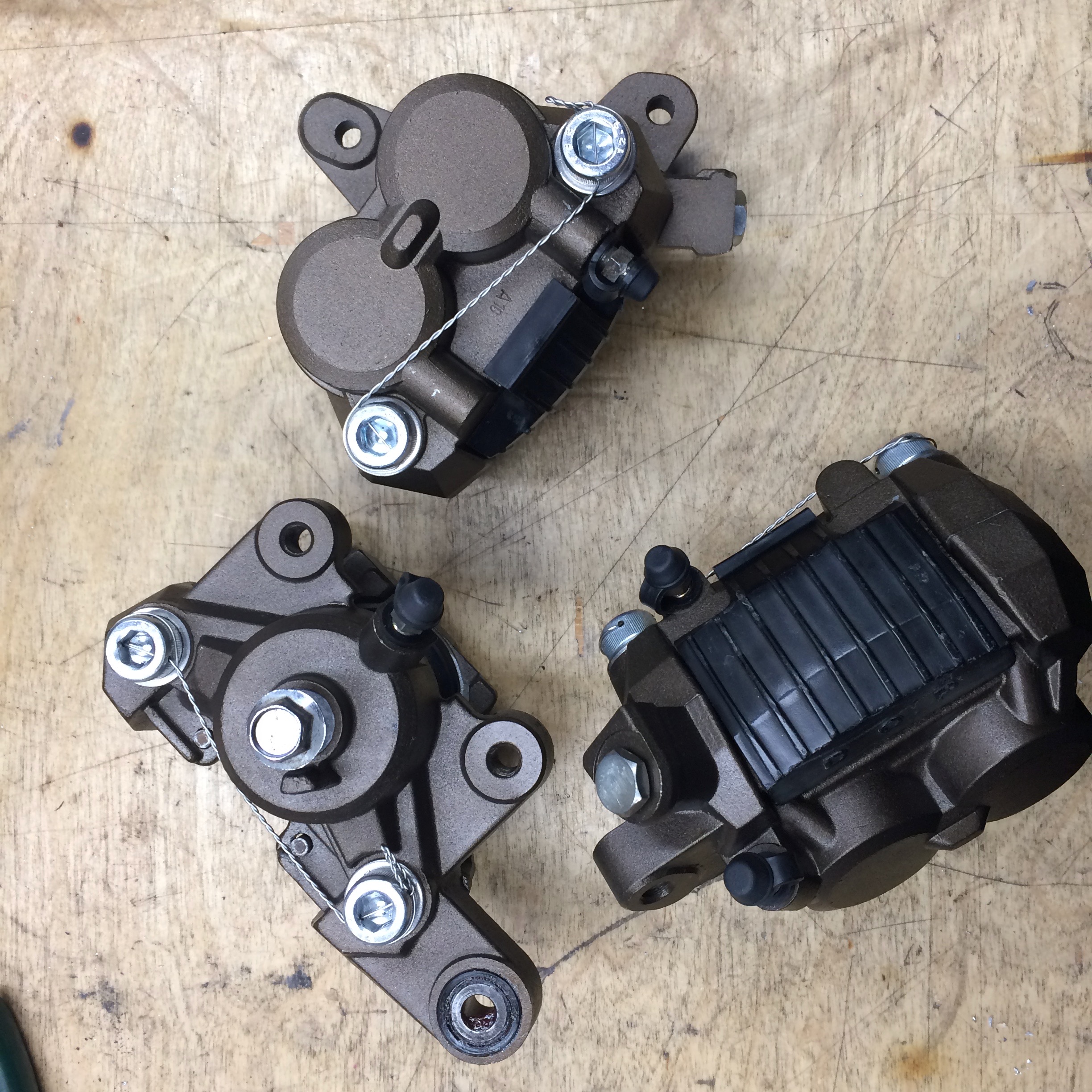

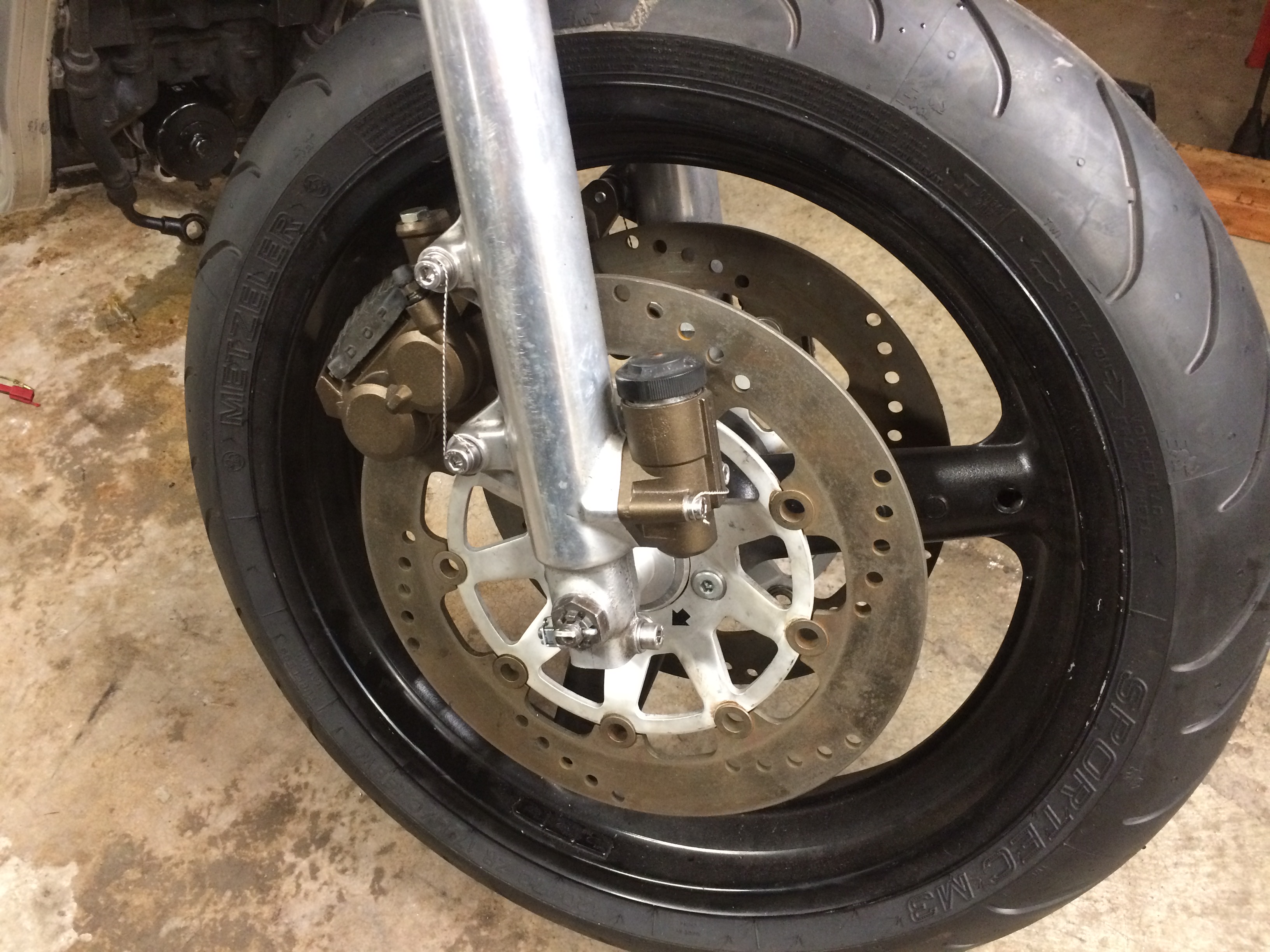

Brakes refinished and rebuilt with new EBC pads, Gun Kote, and unnecessary safety wire.

Is that regular off the shelf gun cerakote? I've always liked the finish and wondered how it'd work on some motorcycle parts
Its Gun Kote from KG Industries its a type of epoxy paint. Nearly impervious to solvents once you bake it. you can shoot brake cleaner right at it and it wont do anything.

Neat Gun Kote. I have a strong suspicion this won't actually be a "dirtbag" build... ;D ;D ;D
look at how rusty the rotors are! Im trying here, it just so hard not to make things pretty! ;D
