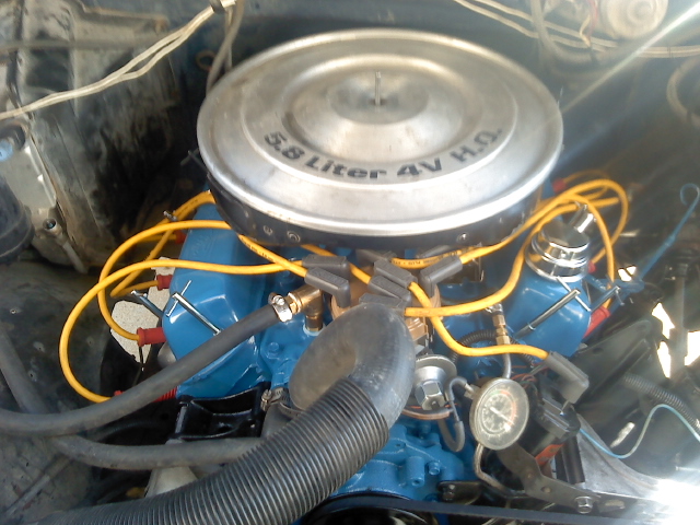

Still working on the head for the 2.3 in the ranger. And the 351 for the F150.

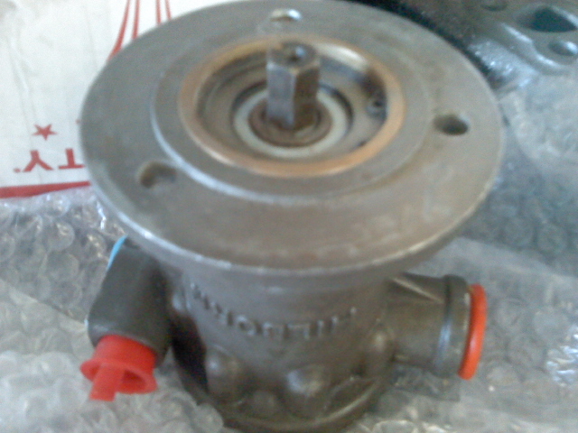

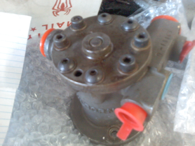

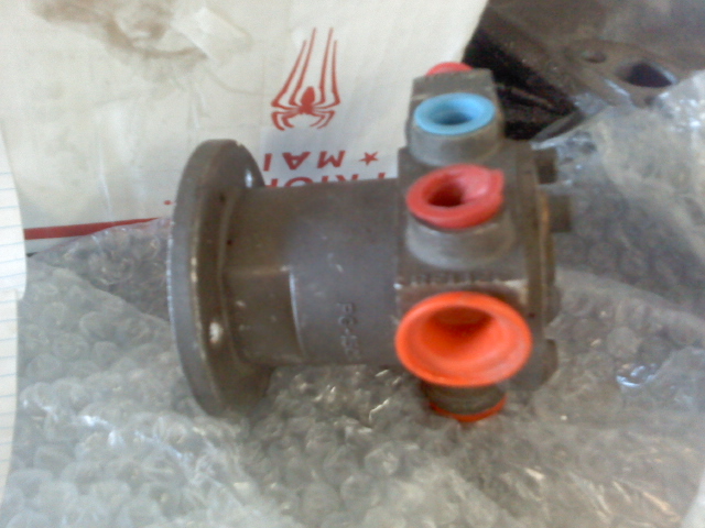

But I did acquire this little jewel for Frankenstein's mechanical fuel injection.
It's a small Hilborn fuel pump off a drag bike.

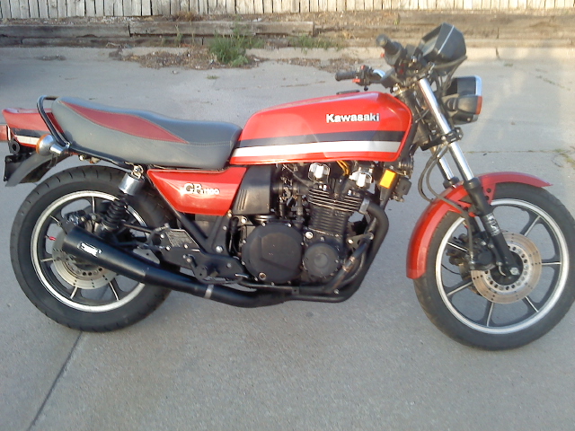

A few pics to help explain my lack of progress on Jekyll and Hyde.
